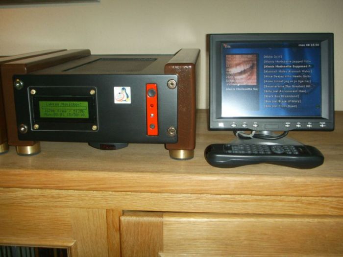

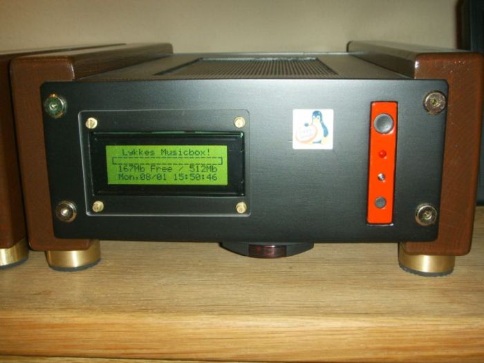

Thanx.
It's a Winstar WH2004A LCD 4x20 i tried it with lcd-smartie, and
you can get it to write anything you want.

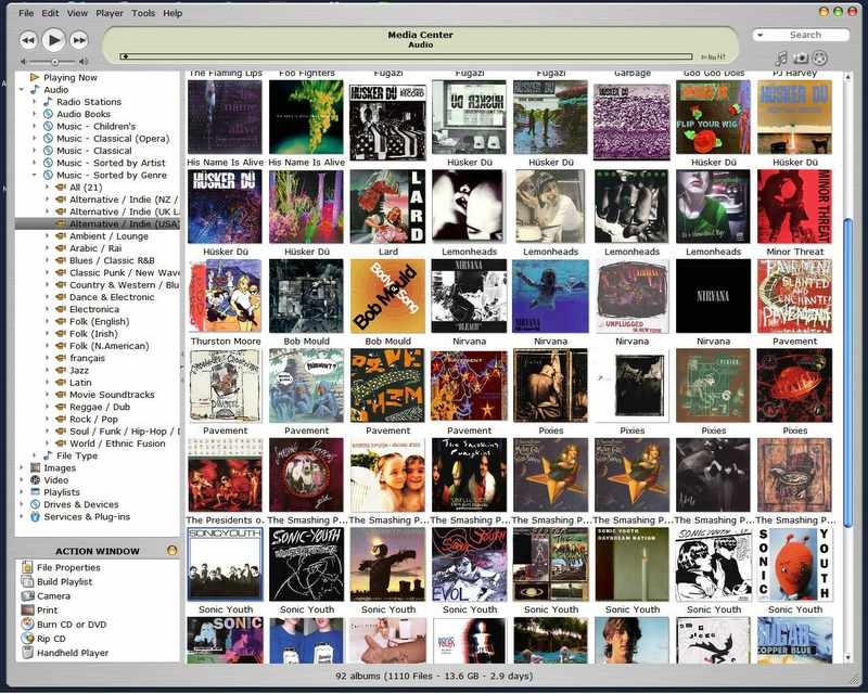

I'm still stuck on windows, and am very happy with J River Media Center. (screenshot below). Browsing by album covers makes it very family friendly. Used it for a long time, it was once very buggy but it seems very stable now, is regularly updated and their forum is very good. think it costs about $40. Quality wise no difference to Foobar as far as I can tell.

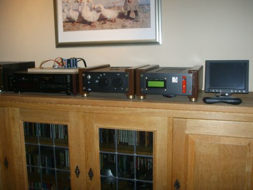

Well it's been a while, but here in christmas i throught i would post a picture of my setup.
Here it is then. And a merry christmas to all of you, here from
Denmark.
Yesterday i tried making a comparision between an Pioneer A-91D, and my BoSoZ(unbalanced)+Leachamp. Both coupled with my Freevo linux media-center, and a DDDac with 1 tower. (Very good thanx Doede). Maybe I am wrong, but the first impression, was that the Pioneer, was able to play louder ofcause, but the sound, it was not good compared to my diy-setup, no joke, more life and cleaner sound is coming out of my diy-setup, I never tried this before, but gladly surprised i am.
Reply's and comment's are welcome.
Jesper
Denmark.
Jesper

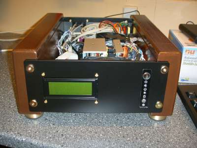

very nice enclosure.... 🙂
But very interested in knowing what's on the inside -- motherboard, processor, heatsink..... are you cooling passive, undervolting???
Motherboard: VIA EPIA ME6000, passiv cooled from vendor.
HD : Hitachi 123GB 7200rpm (Very silent)
PSU : Passiv cooling Modded old PSU.
I have placed 2pcs. 80mm fan's inside, which i slowed down to their minimum, to make a little air-flow.
When putting my ear to the box, i can hear the HD and the 2 fan's, but when moving a little away, there is silence.
On the HD i have nearly 200 CD compressed with EAC/.FLAC. The system is ubuntu linux + freevo media center.
