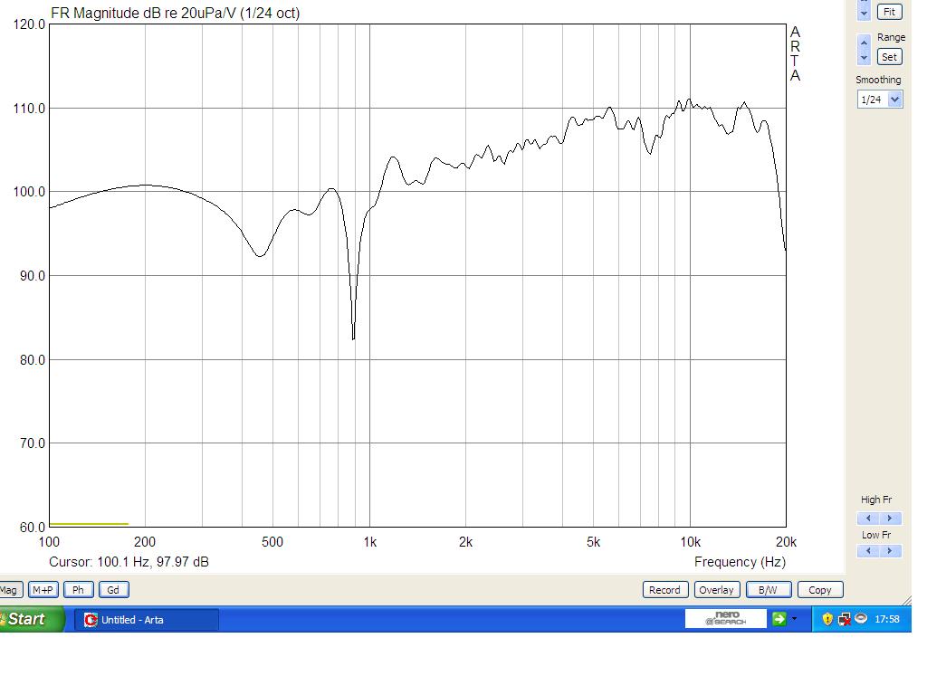

How close are you to calling it a wrap? Have you measurements to post yet?

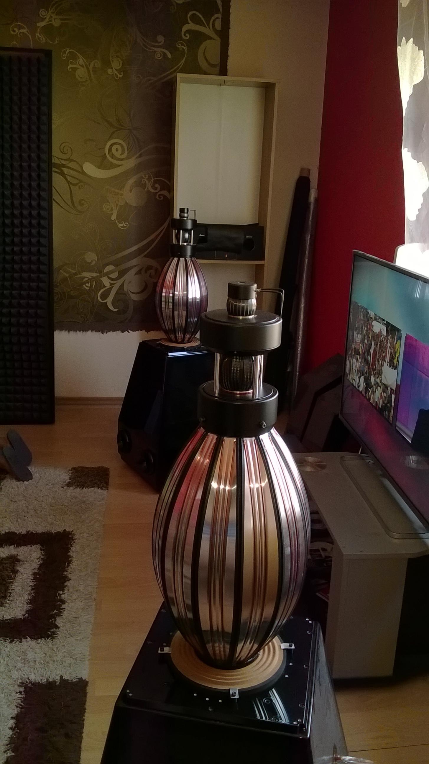

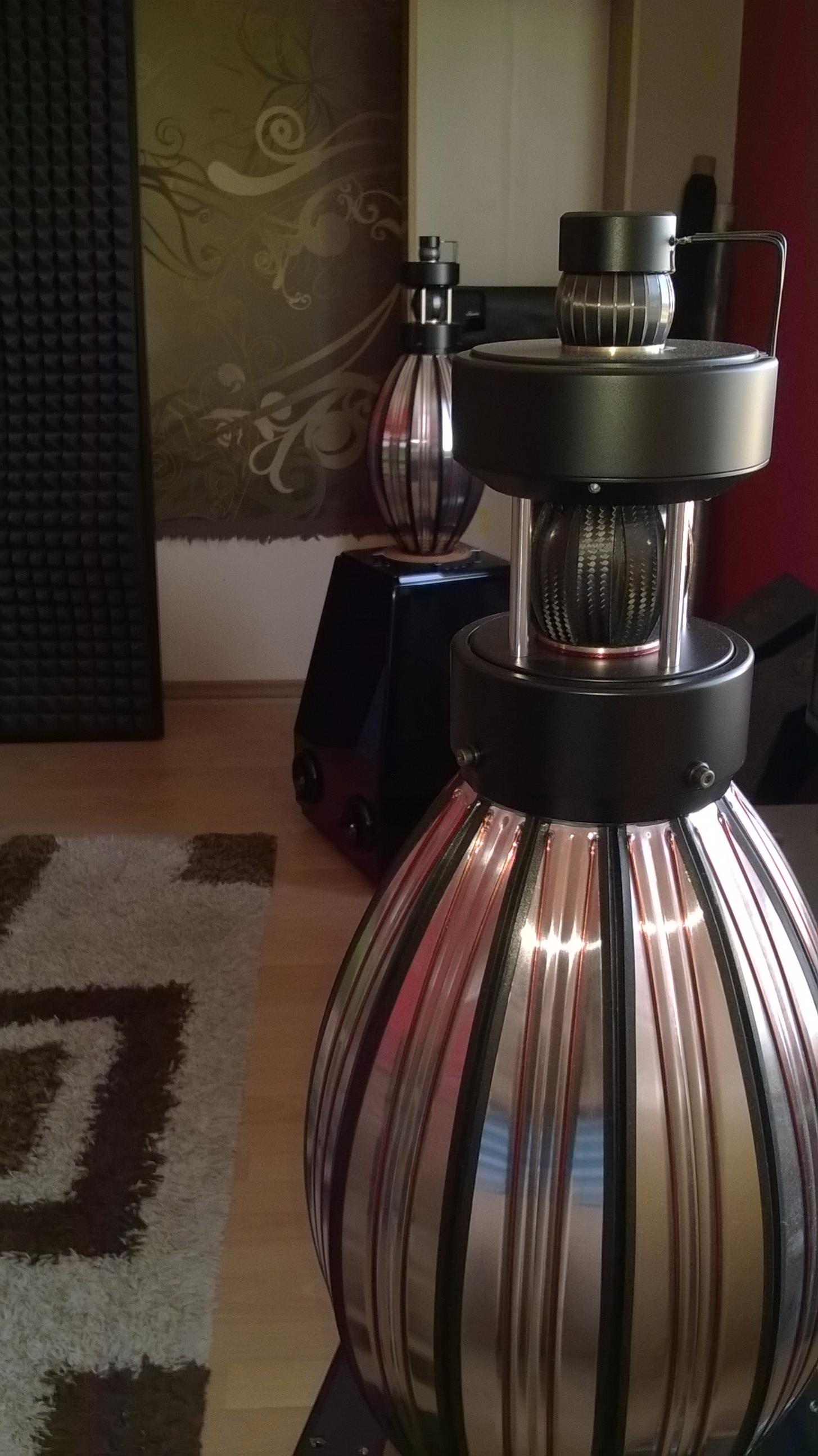

Any which way you slice it, these are a true work of art.
out of all the thousands upon thousands of diy audio projects this must be in the top. only thing for me to do is play catch up.

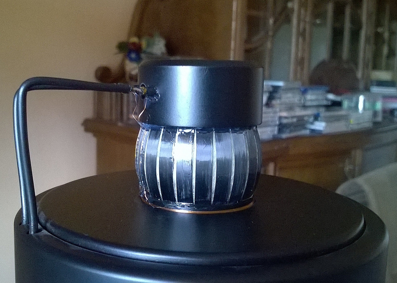

My newest tweeter
My newest tweeter!

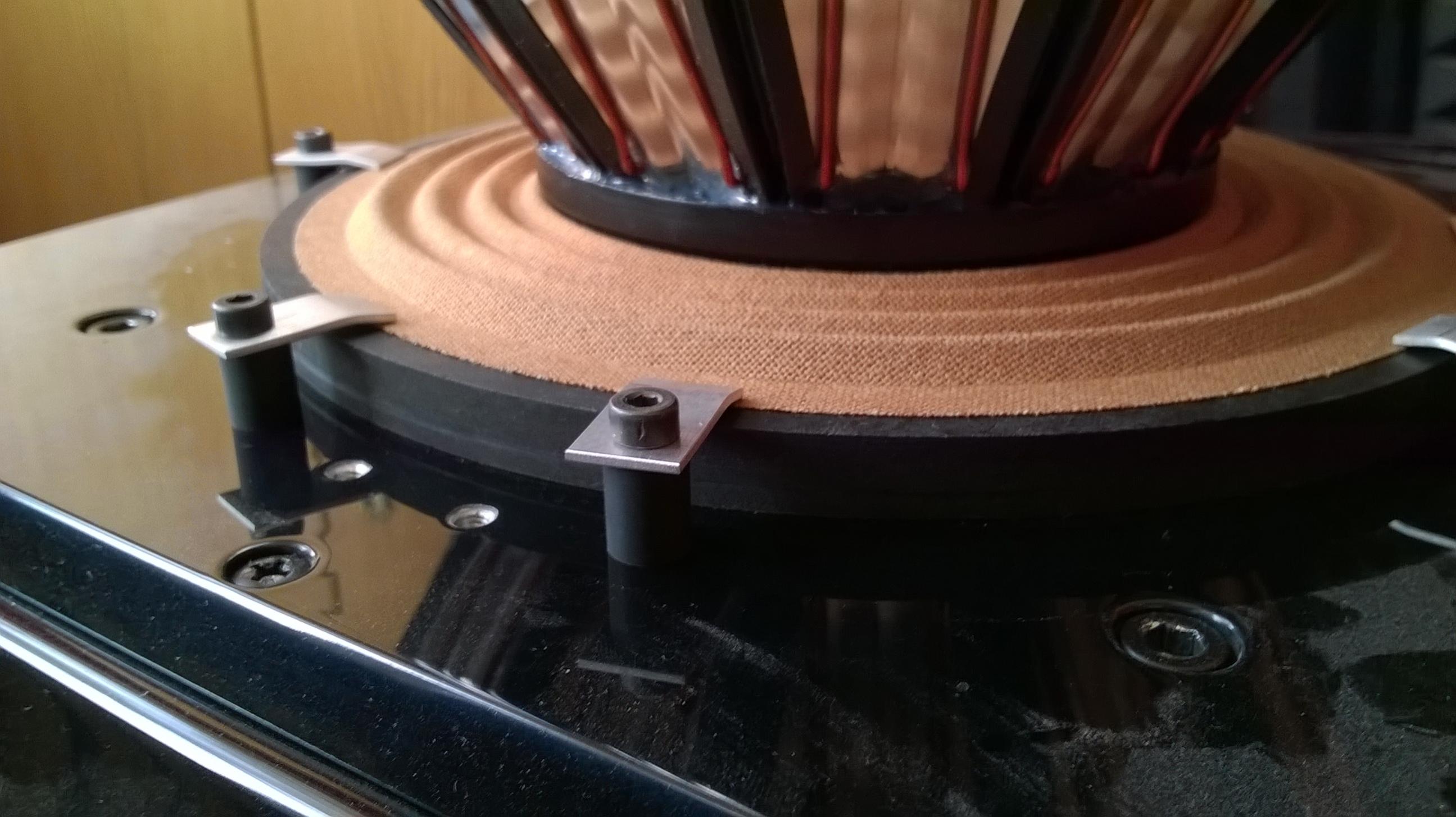

-have been changed, carcass coil on Kapton
-the change in the petals
-changing the number of petals
-changed the width of petals on 5mm
-and changing thickness petals

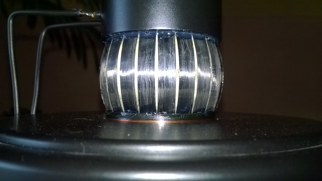

Sounds very good.
My newest tweeter!
Sounds very good.

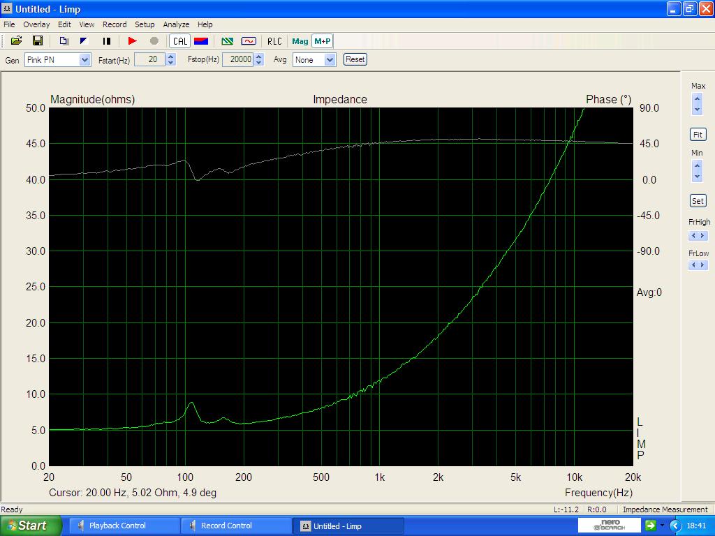

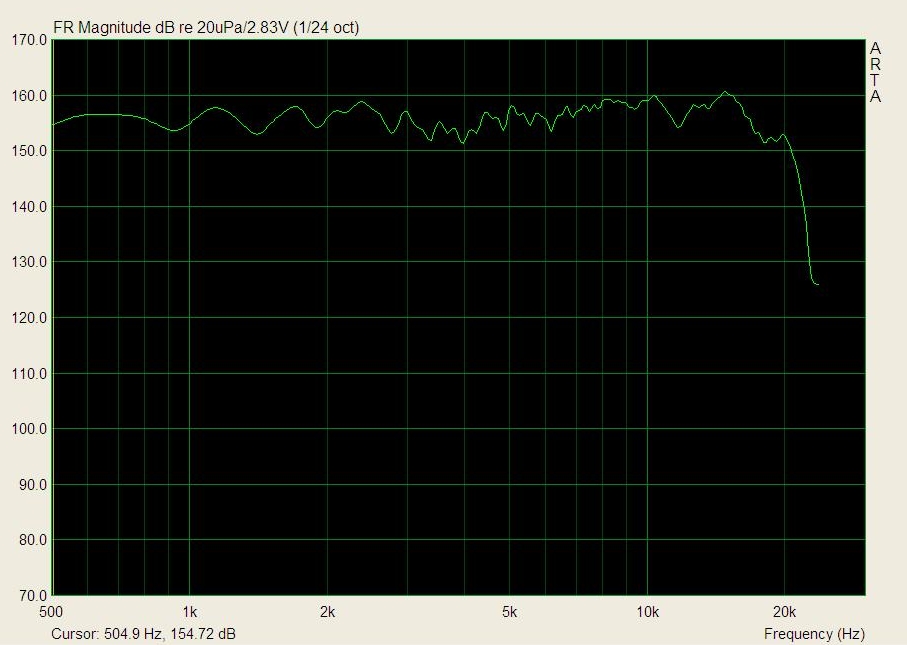

Really nice job! Can you post TT100 impedance graph? i would compare to my fem simulation. I would like to check resonace frequency..115hz?
IS there a reason you wouldn't want to use Carbon for the bass portion as well? I would think lighter would be better, but I don't know. Curiosity has got the better of me here. These speakers are beautiful and fascinating in it's concept. Good job!

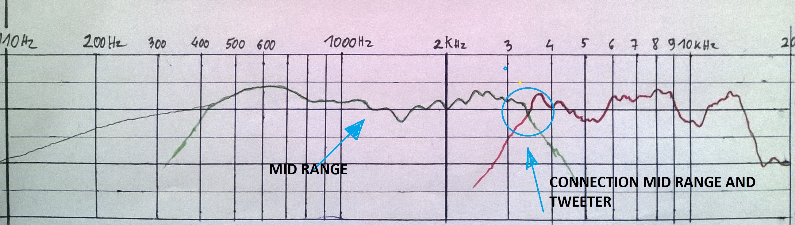

Connection mid and tweet
bluecanary
Thanks!
It requires a lot of time and cash.MBL reports that aluminum does not give colorations.
I have no reason to disbelieve them.
Gentlemen
Please Evaluate my connection with midrange tweeter.
I think I could get close and equalize place to connect.
Please comment.

Impedance TT100
VALEMAO
Please my measure impedance grande"melone".
Resonance my melone-108 Hz...
VALEMAO
