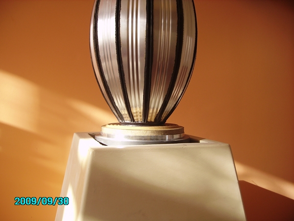

Never I heard original saying mbl 101.
I know that it requires place MBL 101 great deal.
Soon I will place diagrams, frequencies and impedance.
I processed project of ribbon by period obtain debt long time.
There is on very high level sound.
My project is polished up far.
It is neutral sound, very fast, detailed.
Feeling of presence of musician is paralyzing.
Dynamics and they are shocking three dimension.
Genuine and soundly real sound!
Great effort, very very nice!
Are they playing yet or still under construction?
They play, but I polish up details of particularities of constructions.

Yours look incredible. Do you have a template for making the large upper base petals? Do you have anything in the middle of the unit soaking up any internal sound? Any basic construction hints for the rest of us?

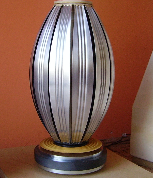

Hello.
Unfortunately I have to change the coil on the coil capton fabric with aluminum skeleton.
Capton is not quite rigid, as seen in the measurements.

From internet searching for about 5 minutes only - so I may not have a very good understanding of it - it is simply about making the air compress (or sound propagate, to put it another way) in an almost spherical way.
Instead of the usual forward and back, flat air compression from a conventional driver, these use that motion to in turn compress the "balls" which then compress the air around their spherical surface.
I bet if you could see the compression wave, it would be more toroidal than spherical.
So, for me, that begs the question is the significant thing about these speakers the 360' kind of "dipole" action giving the fantastic sound as opposed to any kind of revolutionary driver? To me, the drivers behave fairly conventionally in terms of speed of movement etc etc.
