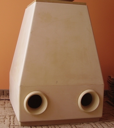

I present uncomplete documentation from work over my structure of replication of array MBL 101E.
Idea of building has emerged in year 2006.Work were base about fabrication for loudspeaker earlier tone frequent highly.With middling tonne loudspeaker just the same work.Idea has emerged in order to whole array collate Radialstrahler.
Photos.

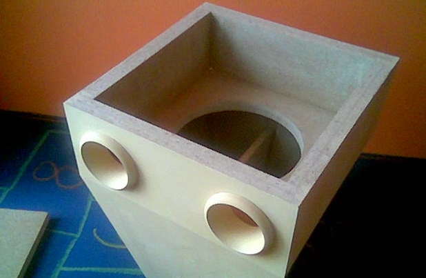

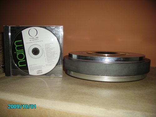

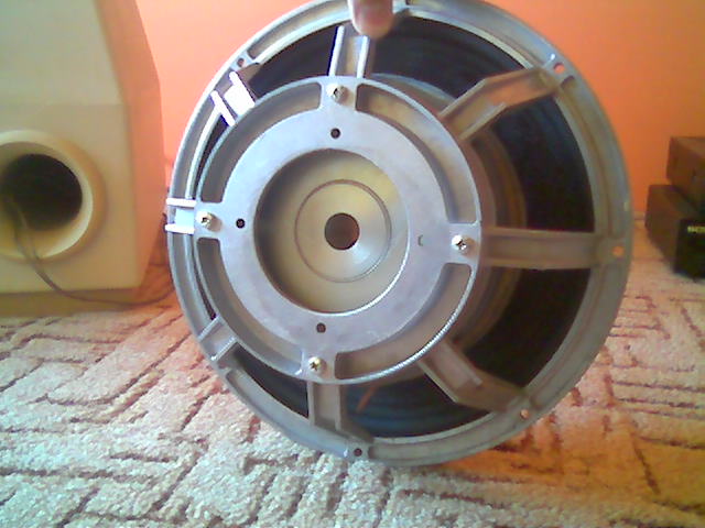

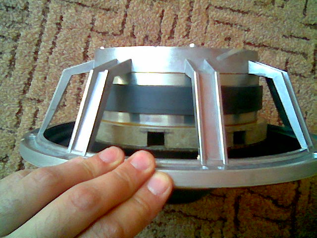

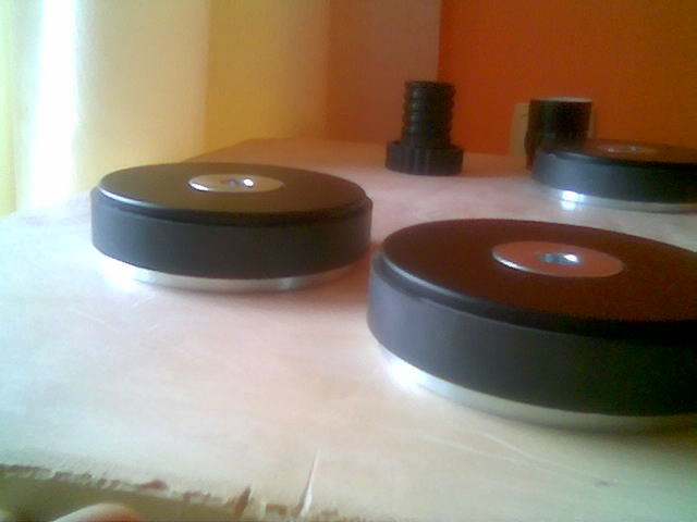

Magnets for omni speakers and 12 bass inch.
Magnets have internal-8,8inch/4,4inch/1inch.

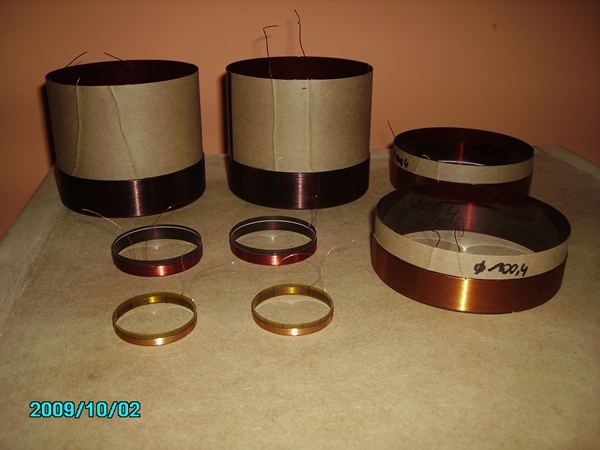

Diameter voice coil 4inch.
Weight one magnetic match 24 -pounds.

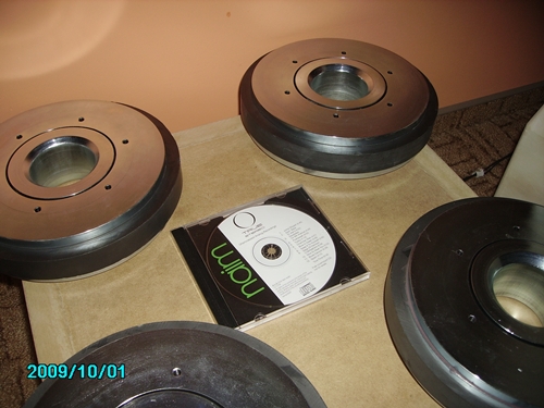

I have designed magnets for project of replication specially radialstrahler.
Induction in slot 1,2T.

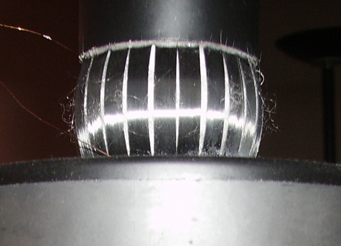

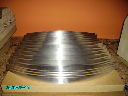

Induction in slot of magnet for loudspeakers highly tone-1, 6T.

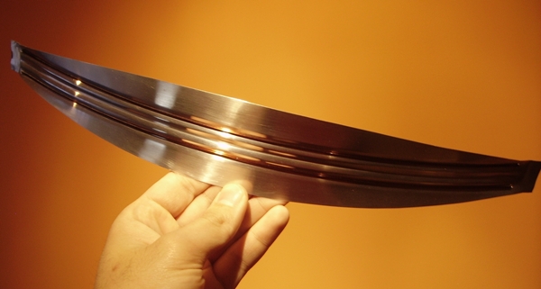

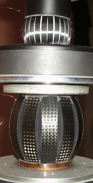

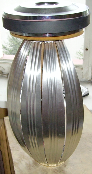

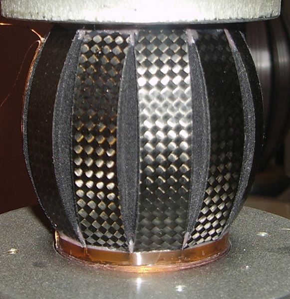

Trial loudspeakers. Petals built with from carbon fiber.
