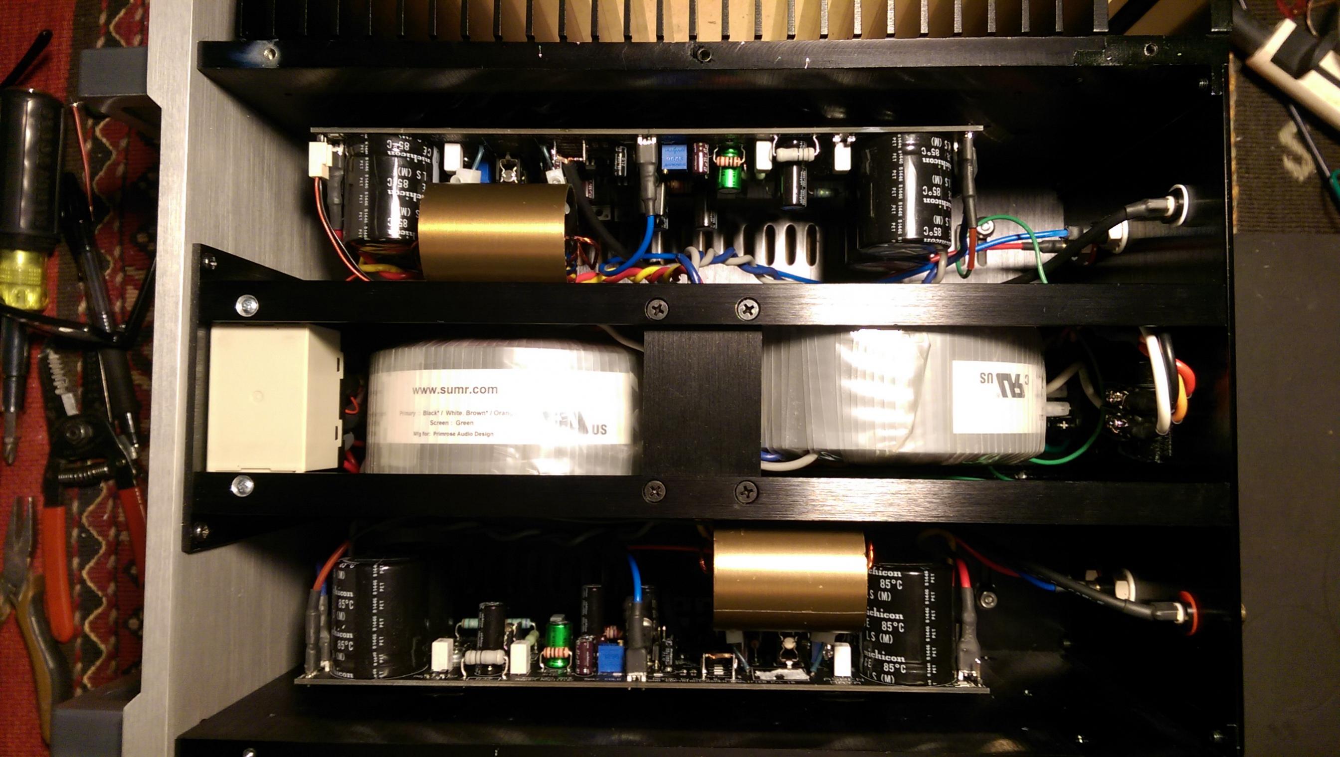

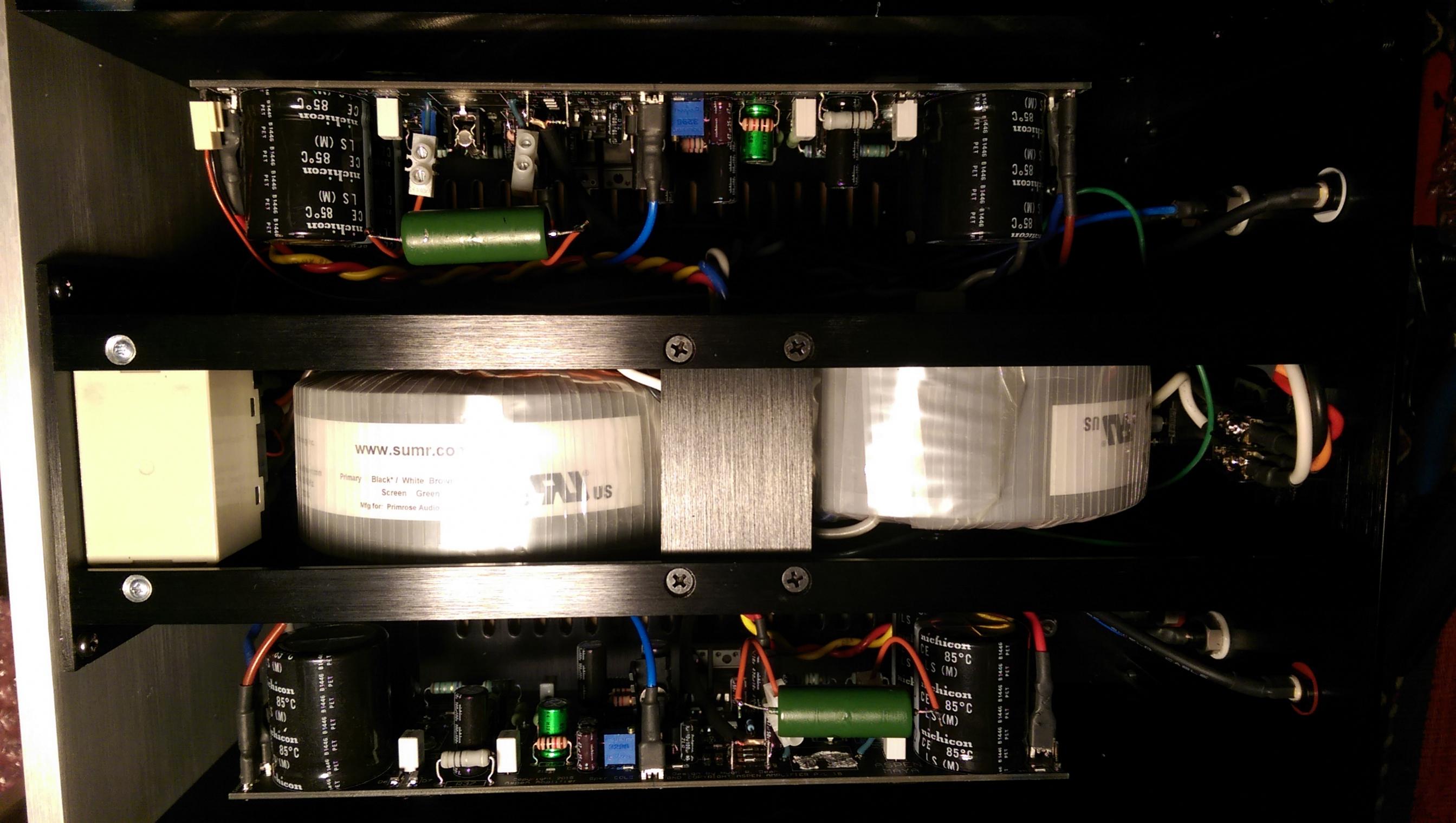

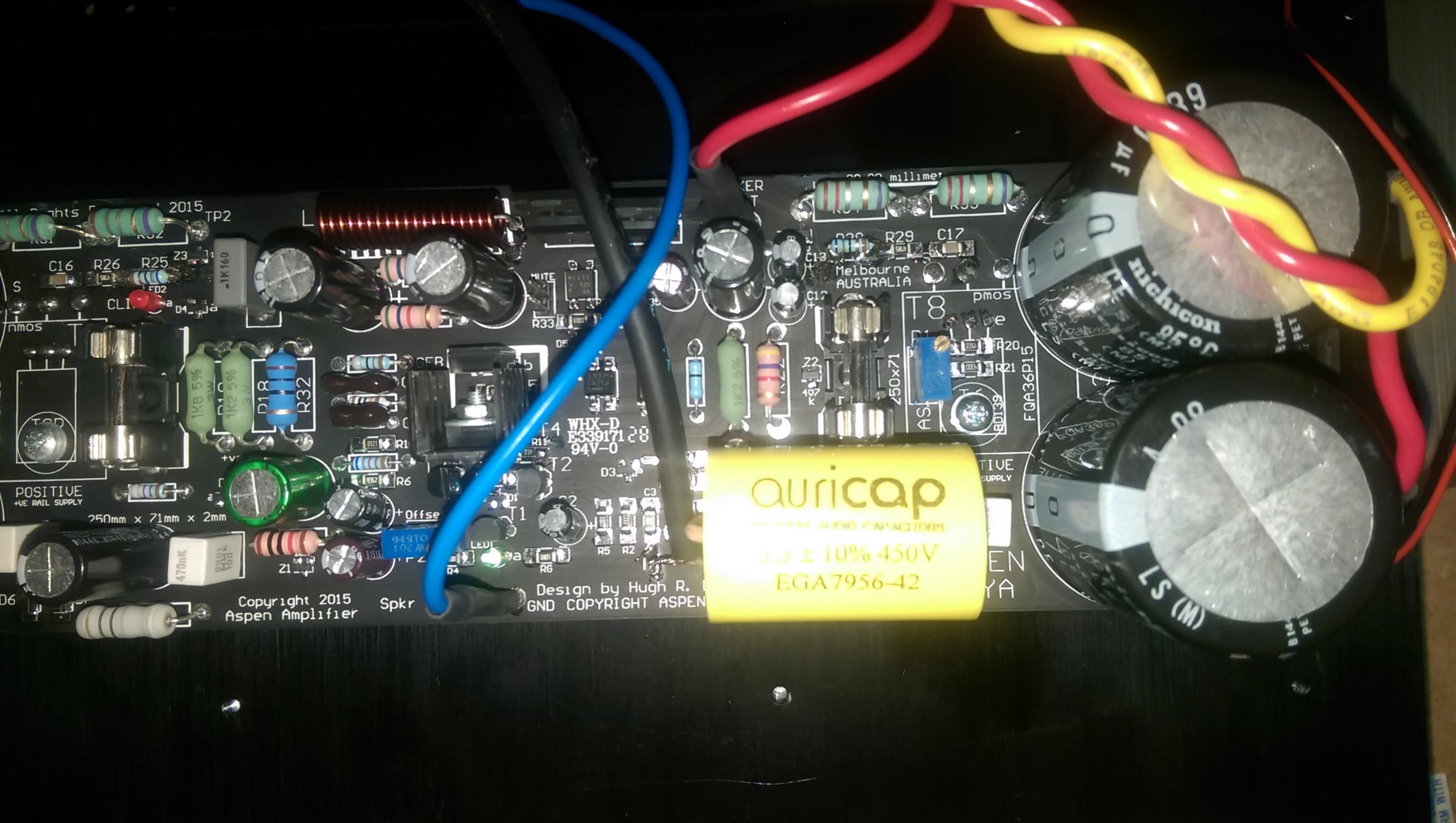

I noticed in the thread above that Hugh has changed the input capacitor in the newest Maya modules to increase the bass output with respect to my version which is less than 6 months old.

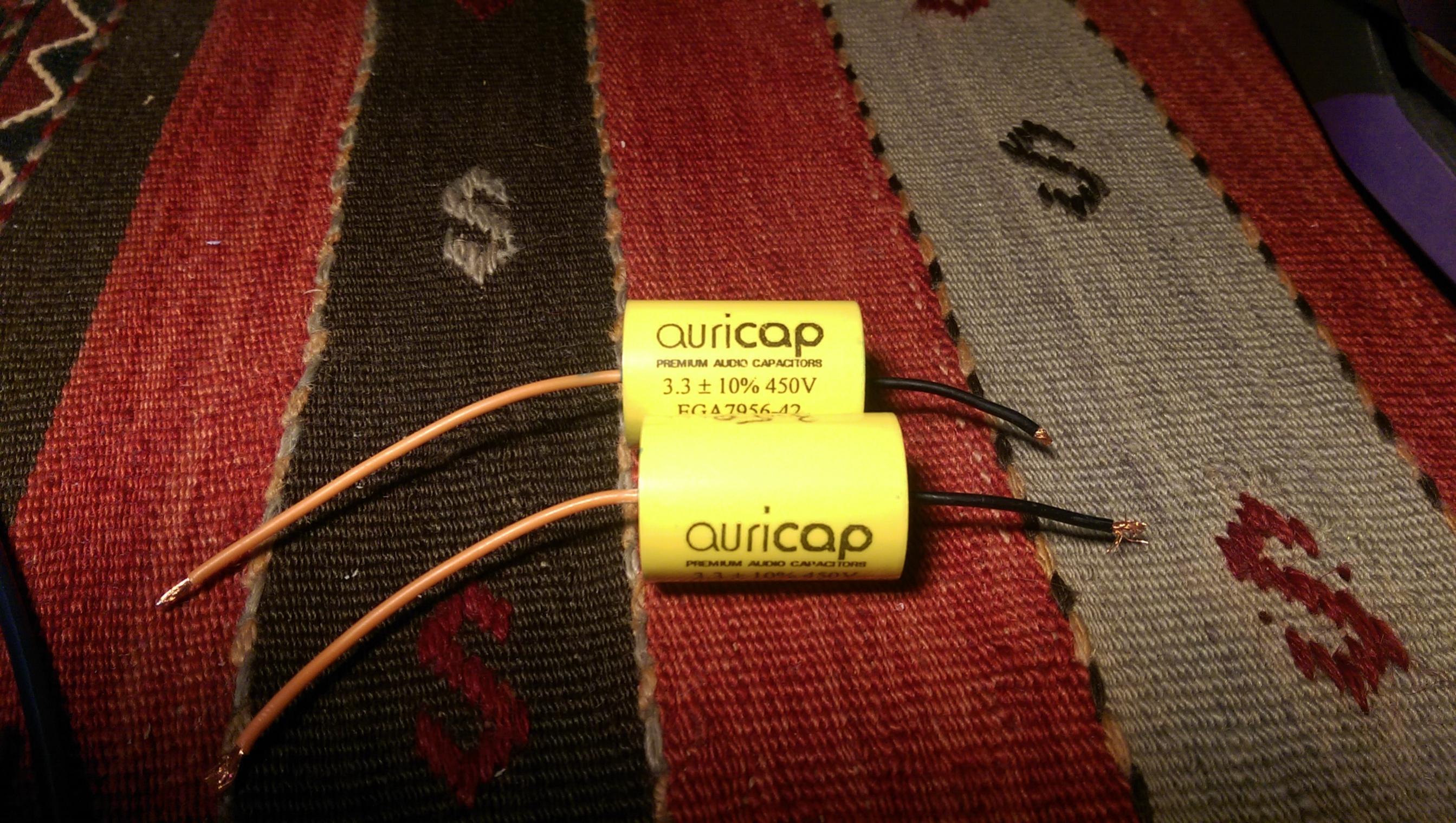

I scrounged through my spare parts tins and found a pair of 3,3uf caps, so in they went this morning.

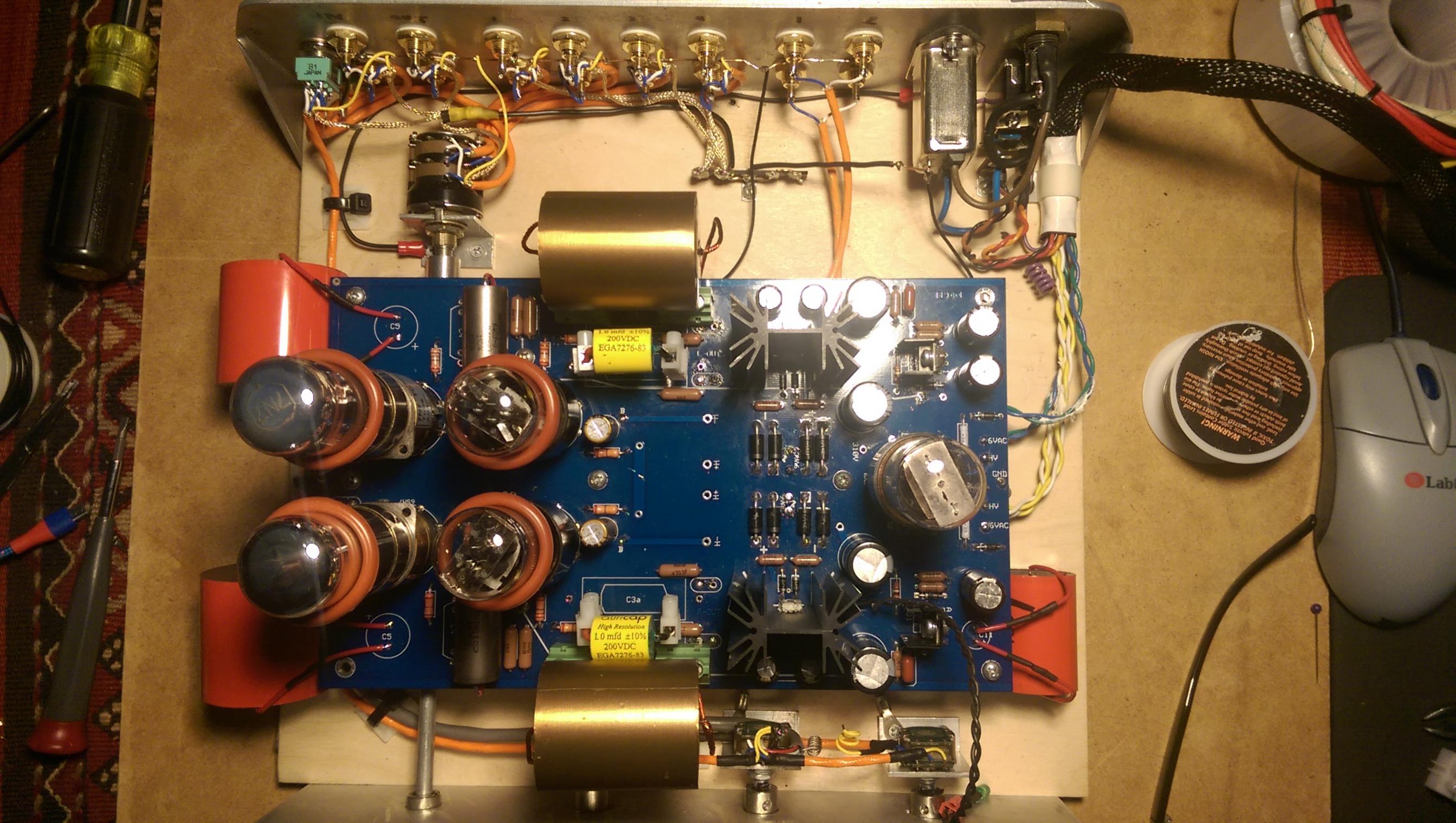

I just got done assembling a new phono preamp (Isotope MM Phono Preamp) and am listening to that now, so I can't tell if the value change has changed the sound or not. Too many changes at once for me to tell.
It just sounds excellent as usual.

Hi Peter,
Any results from fitting the 3.3uF C1 on your Maya?
Do you think the bass is better?

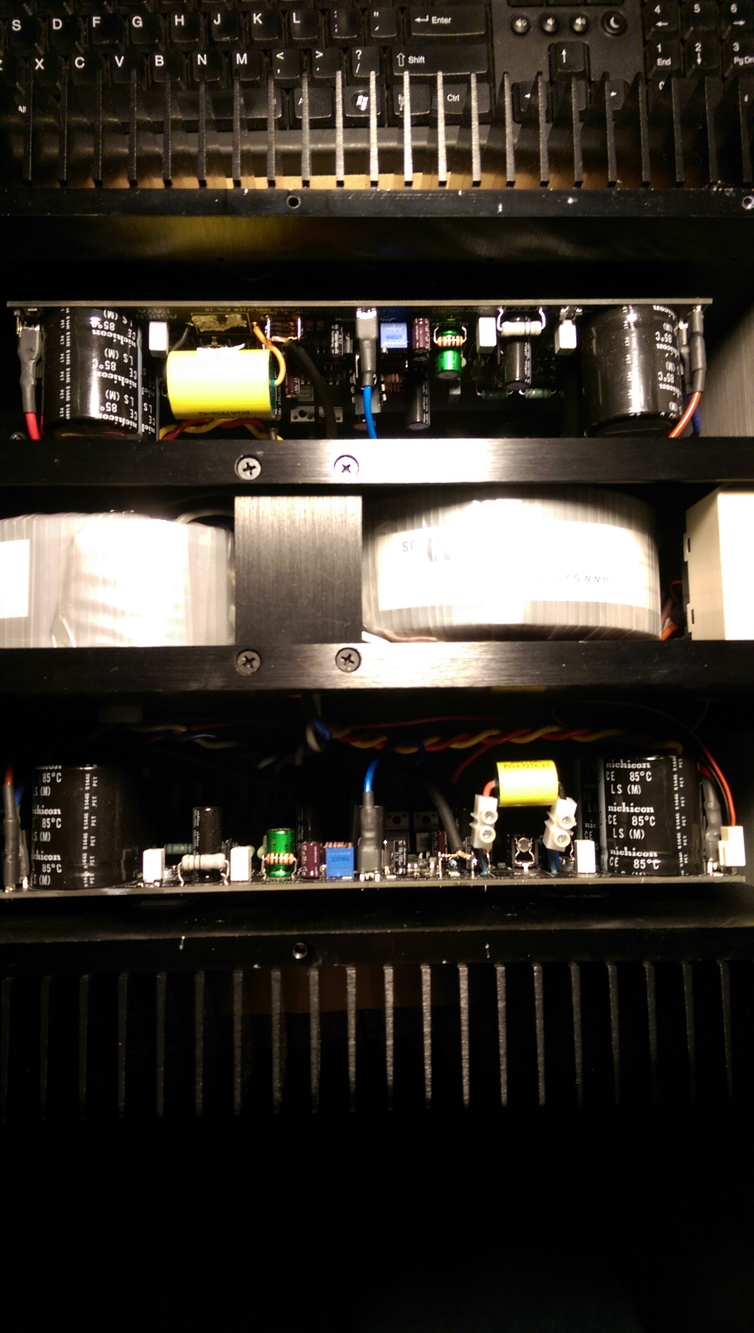

I spent the day swapping caps back and forth in first my preamp, then in the Maya.
In the preamp a 1uf, American made PIO ended up sounding superior to everything else.
Adding the little screw terminals to the amp modules made swapping fast and easy.
