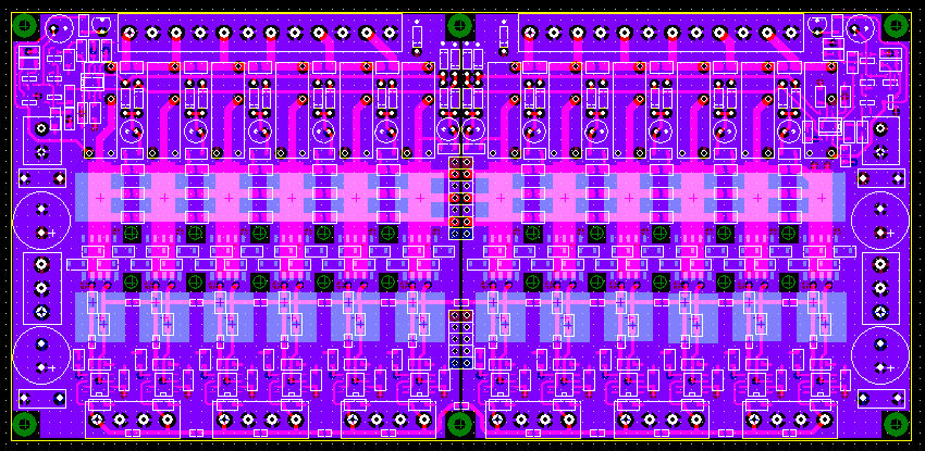

Attached is a pic of my 4-layer multi-channel LME49600/49610 PCB design originally inspired by diyAudio Member OPC.
I originally designed the PCB for a 10 channel mini surround sound system but I also added provisions for multiple channel configurations. The PCB can be configured using solder jumpers underneath the board to operate in mono using up to 24 LME49600/LME49610 devices in parallel or stereo with a maximum of 12 devices in parallel per channel to twelve separate channels with a pair of LME's per channel and everything in between. The input op-amps can be paralleled for additional drive and noise reduction when configured in mono or stereo. There's also DC speaker protection on-board for each individual channel. The circuit also prevents speaker thumping when power is turned on and off. The relays can bypassed or paralleled using solder jumpers to lower relay contact resistance if desired.
I've yet to have the PCB manufactured but If there's enough interest from members of this great forum I'd be more than happy to have the PCB manufactured tested and made available.

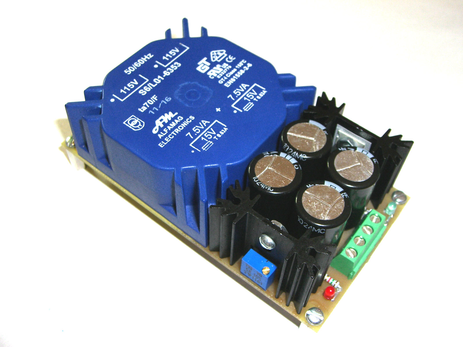

I also have a PS to power it. Two PS are required one for each side.

Hi qusp,
You mean on the outputs? If so, there are none. Only the input op-amps have optional current sharing resistors.
What appears to be resistors pads are actually solder jumpers to parallel the outputs depending on what output channel configuration is selected.
aha sorry yes its the optional pads for paralleling I was seeing as a place for current sharing resistors. what sort of speakers were you thinking to use for it in multichannel mode? very efficient ones I guess. interesting design anyway, I would have liked to see the psu on the same board. all the same since I have a fair few left over buffers I may grab one of these.
what topology is the supply board you have planned? are you also using lme49990 for the VAS? as this is pretty low current, to keep things neat, you could look at using an optional DSUB25 connector for the power umbilical and output
Hi qusp,
For the multichannel mode the small speakers I'm using are actually not that efficient at about 82db/1watt/1m. But they don't need to be since the speakers are positioned relatively close to my ears.
I kept the PS external for added flexibility to select your own PS which seems pretty popular these days. If it was mono like OPC's design I'd go on-board for sure like I did with my version of SymAsym. Also the PCB measures 7.6" x 3.6", adding the PS on-board would of made the board quite a bit larger adding to the overall cost. I'm also a stickler for neatness, one or two on-board PS what of really cluttered things up.
For the PS I'm using the same topology that OPC used on his design. It's simple enough and proven so I built by own PCB pictured below. I'll being using a 25VA transformer not 15VA as pictured. For added current I'll use LT1085/1033 3 amp regulators instead of the LM317/337.
I'm also using the LME49990 for the front end.
Thanks for your idea of using DSUB25 connector, definitely something to think about.
Al

I think i've seen that PSU layout somewhere else 😉
I'm thinking of designing an amp using two LME49990 bridged front end driving the LME49600 buffers driving some nice output devices! 18V rails. Ultra low distortion about 50W 8R perhaps? Tweeter amp? All SMD perhaps?
yeah look with an identical PSU right down to pretty much the exact layout, identical parts in the front end, this whole thing is cutting a bit close to the bone IMO, consider me uninterested.
publishing a thread asking about doing a run of PCBs under these conditions, linking to the front page and measurements, its really not cool IMO. its one thing to take inspiration from someone, given the performance of this amp its understandable; but to just transpose the whole thing with the addition of a servo and talk about doing a GB on the PCBs, while Owen is trying to make a go of the amp as a product?.... is going too far.
pretty sure you dont have bad intentions, but did you really think this through?

AAK, could you post a schematic of your design? It'd be easier to understand your implementation that way.
I think you haven't intentionally written it this way but there was some implication in the first post that the design in this thread will have measurement like the LPUHP, which isn't necessarily the case since Owen has measured his specific layout and BoM parts choice.
It's surely hard to originate in a bipolar lm3xx PSU.
My personal opinion is that you'll want more power than what you'll get from this as a surround amp even near field.

Hi hochopeper,
I currently don't have a complete schematic, but there's really not much to the amplifier circuit. All you have to do is look at Fig. 2 of the LME49600 datasheets for my SE circuit with the LME49600 as an output. The non-inverting input in my design has 1k to ground. It's basically the same design OPC is using for his SE input configuration. He does have a balanced circuit on the input which is not in the datasheets I believe. Other than that my design has optional solder jumpers in order parallel the outputs, and the same for the input op-amps for added drive. A DC speaker protection circuit is on-board that also eliminates turn on and off thumping.
I don't see in my first post where I implied that my design measures like OPC's LPUHP. But my PCB is four layers and carefully layed out for the highest quality performance, but since I have not had the board manufactured or tested I can't say for sure.
When I said the speakers are relatively close to my ears I meant inches. Two pairs of LME49600 in parallel is actually more than enough.
