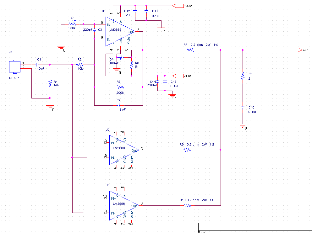

Been working on a chip amp project based on lm3886.
I built it all got it working, but thought that 50watts was not enough.
So I thought about adding a second chip and bridge them.
Once they were bridged, all I was getting was DC at the output, around 60volts.
What type of power supply do you use?
Symmetrical or assymetrical?(+/- 30V or +60V and GND)
If you use an assymetrical one it's why you have the 30V at the output .The op amp always work at the half of the power supply if you use symmetrical the midlle point is zero and for assymetrical the middle point is 30 volts.
The two can work but with assymetrical version you must use capacitors to block the dc.
The posted schema shows Parallel, not bridge, which did you use?
For the other chips, what resistor values did you use, were they the same as the first chip (just checking).
It's possible your chip is busted. I would likely think some sort of short caused the chip to blow, or some misconnection.
In parallel mode the offset is slightly higher due to mismatch between chips.
But it should not exceed 150 mV no matter what.
ampmade is right, if your supply is a single supply you have to use an output blocking cap .sivan is also right, if you're bridging you do not need a DC blocking cap on output even with a single supply.
But I suspect you're using a dual supply and getting the +V rail on the output. That is most likely a blown chip, if you're measuring it correctly.
Be also sure that Rin (the first 47K resistor in your schema) is correctly connected. Its disconnection can create huge DC-offsets.

alright.
Seems my chips are dead.
I got 2 more pluged one in and I get sound.
And a low 1.5mv dc output!
