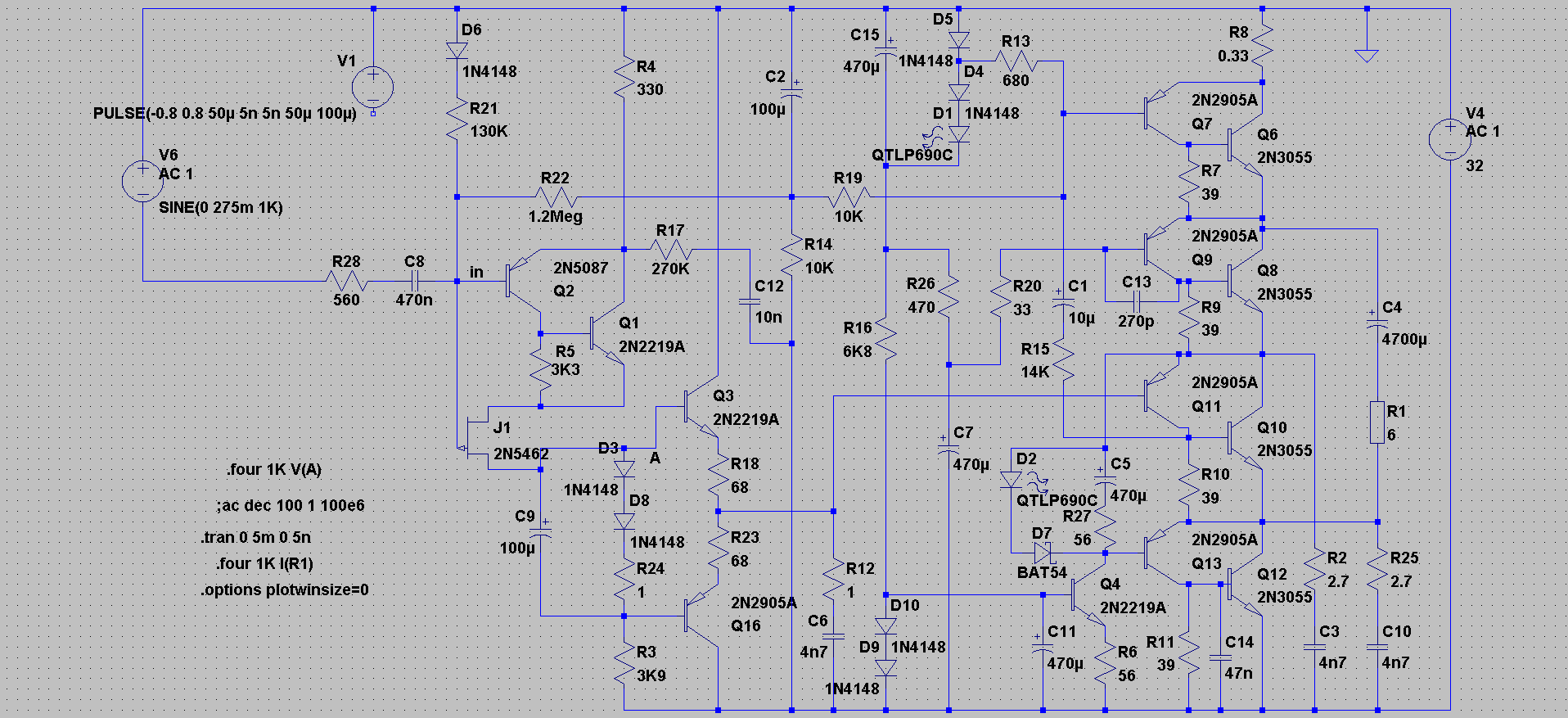

Now, let's have a closer look at the ground/supply system of the Tringlophone.
A single supply with a positive ground is somewhat out of the ordinary.
There are valid reasons to opt for such an unusual scheme.
Although the output is floating, its natural, implicit "anchor" is referenced to the negative rail.
By contrast, due to its voltage translation effect, the input stage has its input referenced to the positive rail, which thus becomes a natural choice for the general ground.
Some conflicts remain though: the CCS feeding the tringle is necessarily referenced to the positive, but it has to receive some signal from the bottom for its modulation.
Fortunately, it is not the noble path, and no voltage translation is required provided the ripple voltage remains of a reasonable amplitude.
The DC operating point is referenced to the positive by C7 and C9, with the modulation simply injected R16/C10 (along with some ripple).
Other parts of the tringle are either AC-referenced to the negative by C8, or referenced internally by C1 for level shifting.
This game of yoyo between the rails results in some residual leaks in PSRR.
These leaks are compensated by the R27/C14, which also creates a rejection notch at 100Hz.
As a result, a simple good quality filtered supply is sufficient: no regulation or electronic filtering is required.

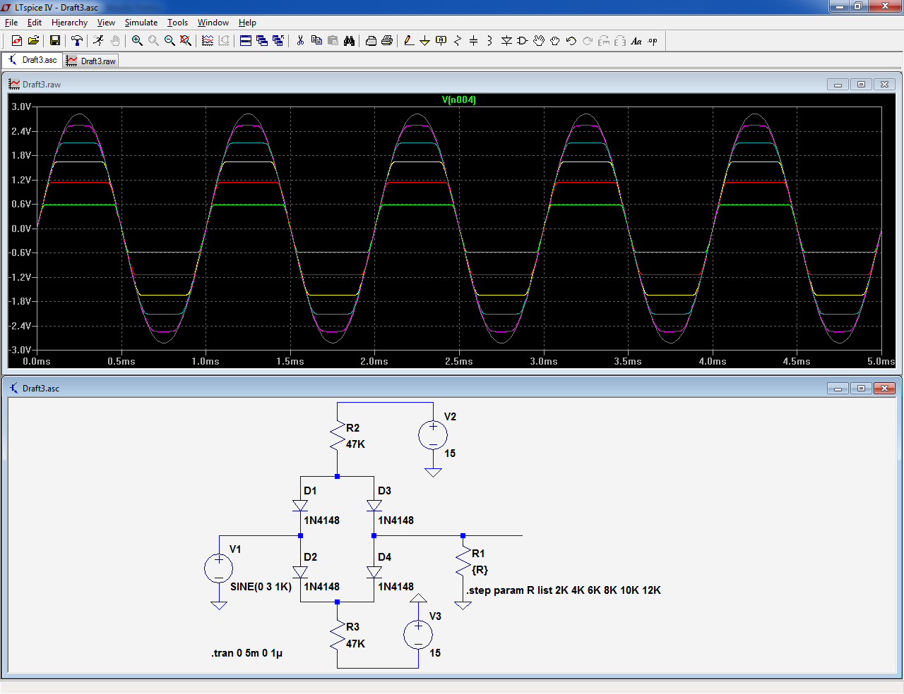

Please, i'm looking for a nice and simple idea to clip an imput signal, and to can tune-it just under the clipping point of any amp. I would be very pleased if you have some idea better than my adjustable zeners's ones in the input line.ClipNipper detector circuit
If you buy Cordell book you can find there The Klever Klipper.
Why not use the classical text-book diode clipper? It is easily adjustable with a single resistor.Please, i'm looking for a nice and simple idea to clip an imput signal, and to can tune-it just under the clipping point of any amp. I would be very pleased if you have some idea better than my adjustable zeners's ones in the input line.
But please, go and discuss it elsewhere, it has nothing to do with this thread
I agree! There's no need to decrease the power output of Tringlophone.But please, go and discuss it elsewhere, it has nothing to do with this thread
Therefore, here is a new thread for soft clipper: Soft Clipper Central Station
Elvee, a link to your 4n25 soft clip is there, and a general purpose overload blocker (can use with Tringlophone), and maybe soon, an answer to Esperado's question (a highly "accessorized" overload blocker), which I will try to do and post at: Soft Clipper Central Station I also solicit your help in casing as much decorous clipping as possible at Soft Clipper Central Station

Is this a "find its own center" or "auto-center" amp?Elvee said:Although the output is floating, its natural, implicit "anchor" is referenced to the negative rail.
Does it remove ground loop noise from grounded source to grounded amp?
I don't know exactly what distinction you make between them. Anyway, it is an open loop centering, defined by resistances ratios, there is no servoing.Is this a "find its own center" or "auto-center" amp?
It is not extremely accurate, and you may have noticed that the input bias resistor is 120K on the "official" schematic against 130K in the sims: there is small discrepancy between sim and reality, and it might be necessary to fine tune this value on different amplifiers.
It is not critical however, since the output is AC coupled.
Not particularly: it amplifies the voltage it sees between its input and ground terminals, and there is no differential input or "ground-scissor" there. Pretty standard stuff.Does it remove ground loop noise from grounded source to grounded amp?

Since this amplifier has no feedback, it does not require compensation.
There are some degenerations, stoppers and stabilization networks to cope with the realities of the wiring, amongst other things, but that's quite different.
In general, the performances will be better with better devices, but I didn't test that aspect: I simply made sure the amplifier remained stable.
This also means that there is room for tuning and tweaking: I didn't want to run any risk, and this probably means the tringlotron effect has been excessively dumbed down.
If the degenerations are tailored to a specific build, higher performances could be attained without endangering the stability.
Stability here has a different meaning than in a feedback context: it means absence of local oscillations caused by an uncontrolled positive reaction from the tringlotron structure (negative resistances, etc)

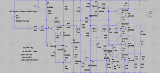

Here is one version. Maybe not exactly identical to final graphic schematic, but enough to get you going and have some fun

Please look at the picture, this is a proposition for input cfp pair to make it constant power, the performance should be better after that

ok, I should be clearer, please attached sim file
Elvee, could you set it up proper regarding dc conditions?
thank you in advance
last file was incorrect
here goes the corrected

the modification of input cfb pair to constant power triple mod brings the rise of the distortion and I think this is step down in Elvee's project

I don't know what you mean by "constant power".
Regarding the "improvement", the THD has jumped from 0.0068% to more than 0.3%; OK, it's almost pure H2, some might find the sound more pleasant, but I prefer to leave it as it is.
In addition, the current in Q3/Q16 is now 75mA, meaning they will each dissipate 1.2W and require a heatsink.

the reason of proposing cfb constant power triple was minimizing memory distortion (if you believe that thay exist)
