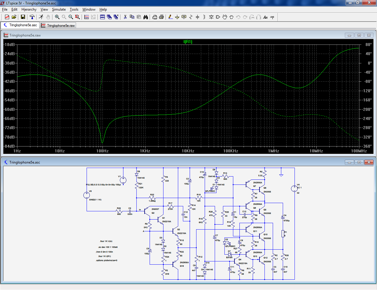

Here is the schematic, details will follow

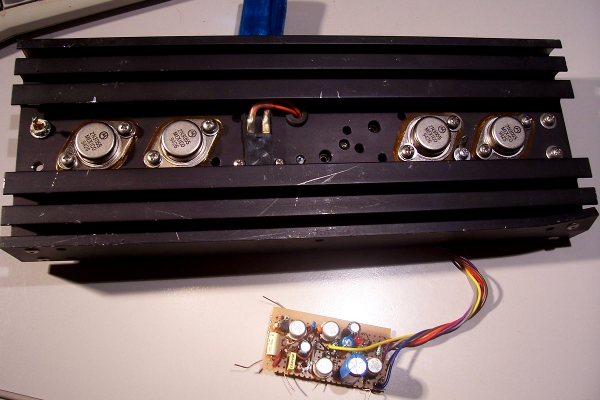

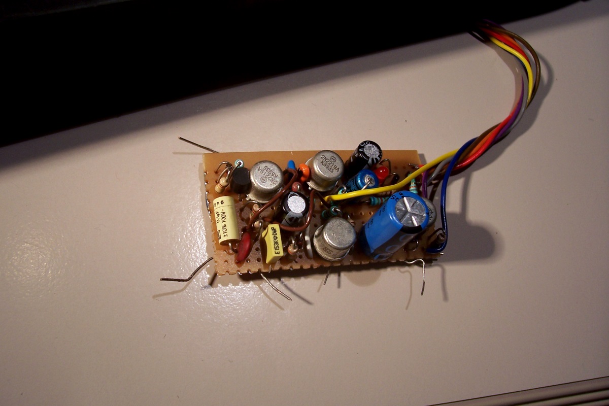

please post some pics, maybe pcb?
Pics, in a day or two, PCB nope

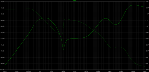

you have light peak at point A at 250kHz...
You are not supposed to look at point A.😀
It is an internal test point to be used solely by the designer.
The user may just look at the overall frequency response.
should have deleted that *$£* TP

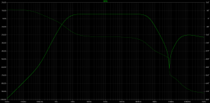

the current through R1 is hm, problematic...
What is problematic? The notch at ~10MHz?
It is caused by the slow OP transistors and the various additional degenerations combined with the error correction. At this frequency, the weak residual output signal becomes completely out of phase with the correction, hence the null.
Note that it is almost completely a simulation artifact: in reality, it is unlikely you could observe something that clear-cut.
... and if AC=0 we got this...
the circuit needs modifications
but anyway I like it very much!

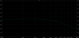

You should indicate the source of your graphs, things would be clearer.
I think what you show is the PSRR, see below.
In that case, no modifications are needed: it is entirely intentional.
Unlike many SE-Class A amplifiers, the Tringlophone is designed to be used directly with a raw, moderate quality supply, and doesn't need a gyrator or regulator: the PSRR over the audio band is decent, and in addition a notch is located at 100Hz to increase the ripple immunity.

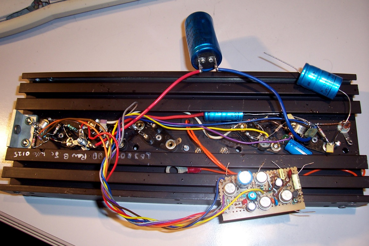

Here are some pics of my prototype:
