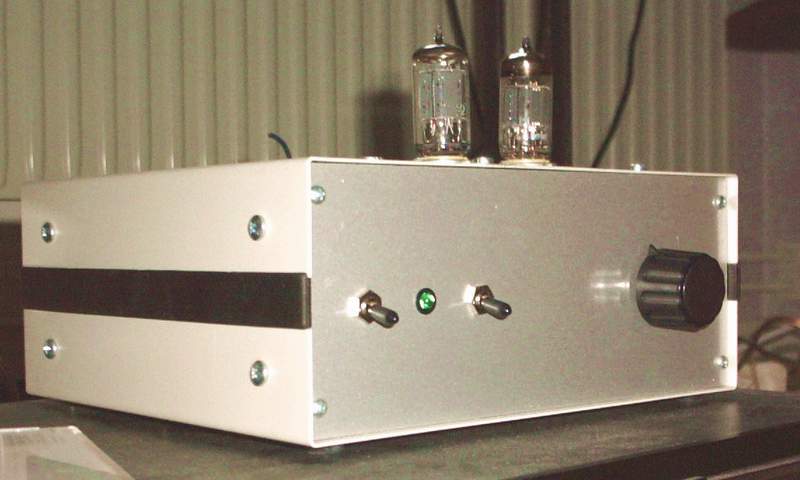

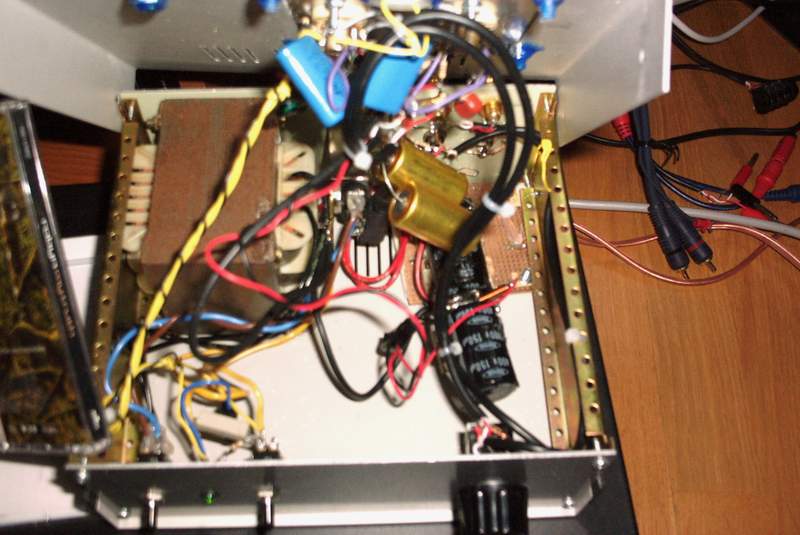

..my little ecc82 preamp-project
i thought i have to show u guys my "beta" preamp, just to encourage your own building a little..
...schematic...
I just dont have any schematic yet... but the basic construction is the simple cathodefollower with ECC82 / 12AU7, constructed from the usual schematic that have been posted in this forum several times before, and just with small mods/adjustments to get the proper match to my power amp.
-the sound is nothing to be especially excited over, but for me and the budget-gear i use, it was THE difference that i needed to enjoy my music collection.
of course, the joy of building your own equipment, that works good, is more worth than "true HiFi".
cheers.
/Ludvig.

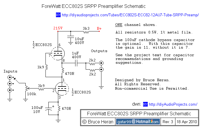

Hello!🙁
I wanted to offer a measurement performed on Vacum Tube SRPP Preamplifier With ECC82-Project!
The ratio of the second and third harmonics.
Also i want to see the measured frequency response.
Thanks for your help!:xfingers:
Measurement and feedback!?
Hello!
The measurements refer to the preamplifier is given below in Scheme (Figure 1)!
Please someone let that little comment about this amplifier, if it does as a power amplifier.
Feedback to be about the sound and display measurements if it worked.
Many thanks in advance!🙄
