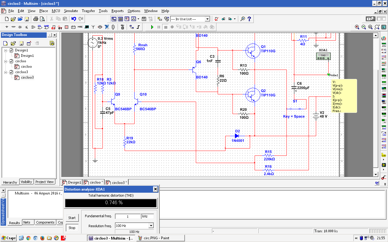

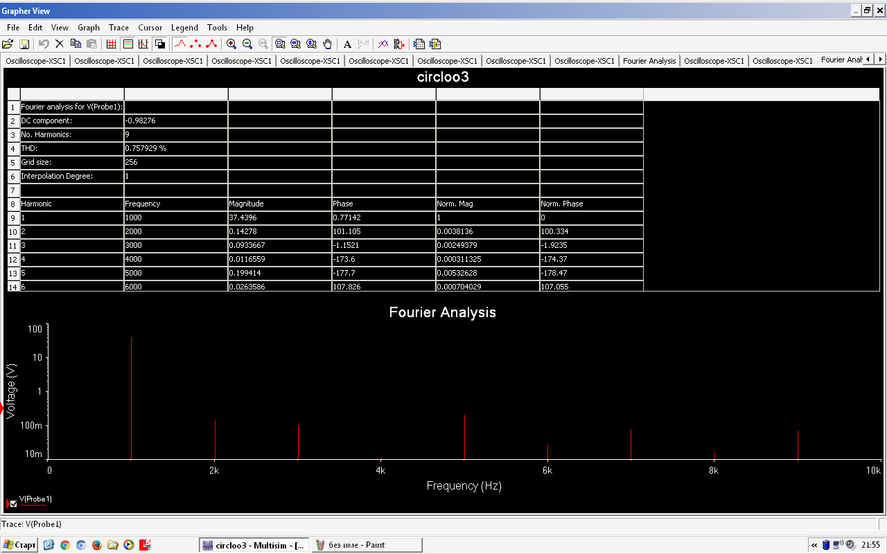

♫♪ My little cheap Circlophone© ♫♪
this acceptable ?
