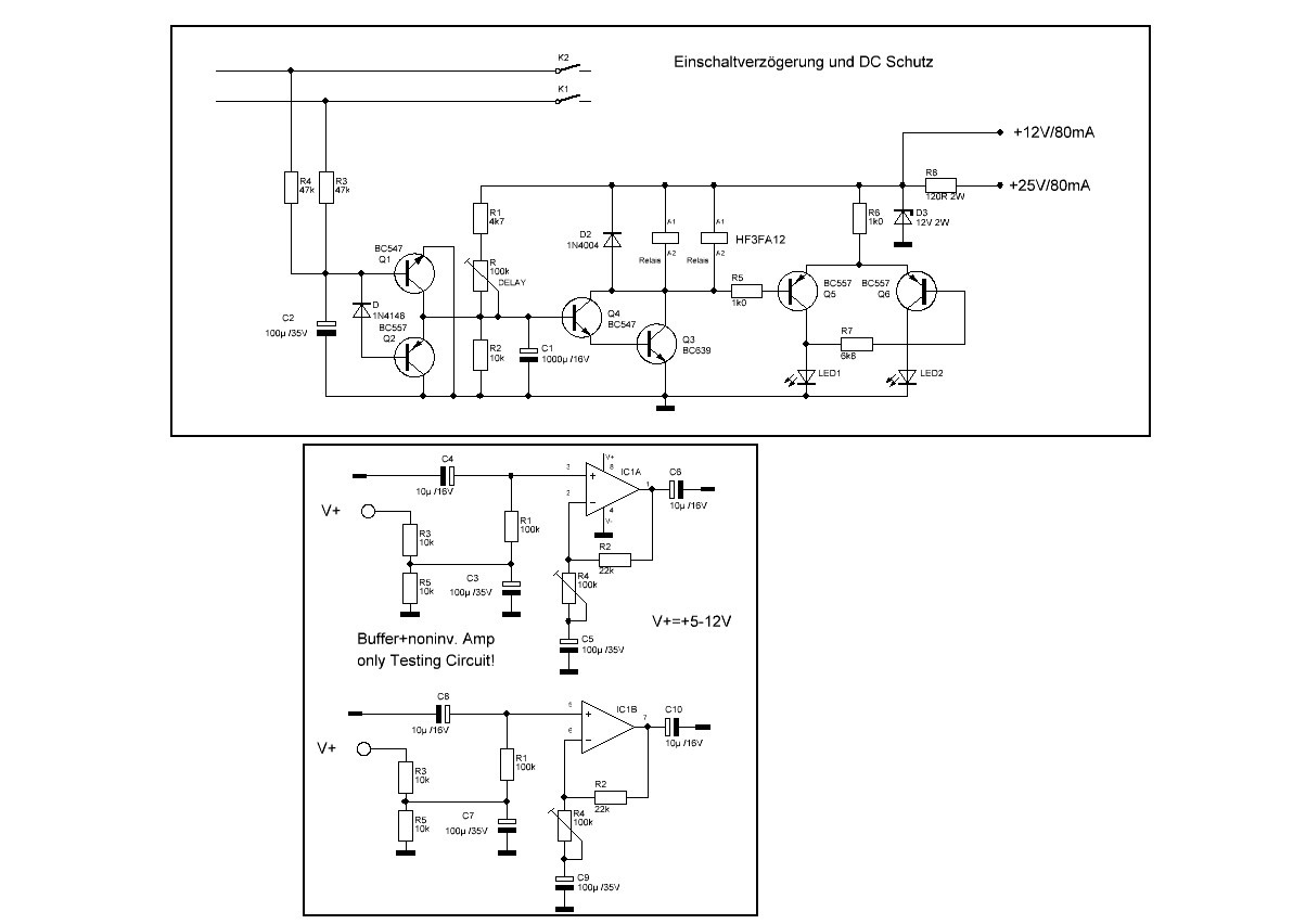

Yes ca. 1V DC. the capacitor C2 (100µF) can be increased to measure a longer DC phase. But do not exceed 330µF please. Trimmer 100k can increase or decrease the delay. In my case I set it to 3 seconds so that the amplifier and the power supply can level themselves reasonably. BC639 can also be BD139. They are pin compatible.

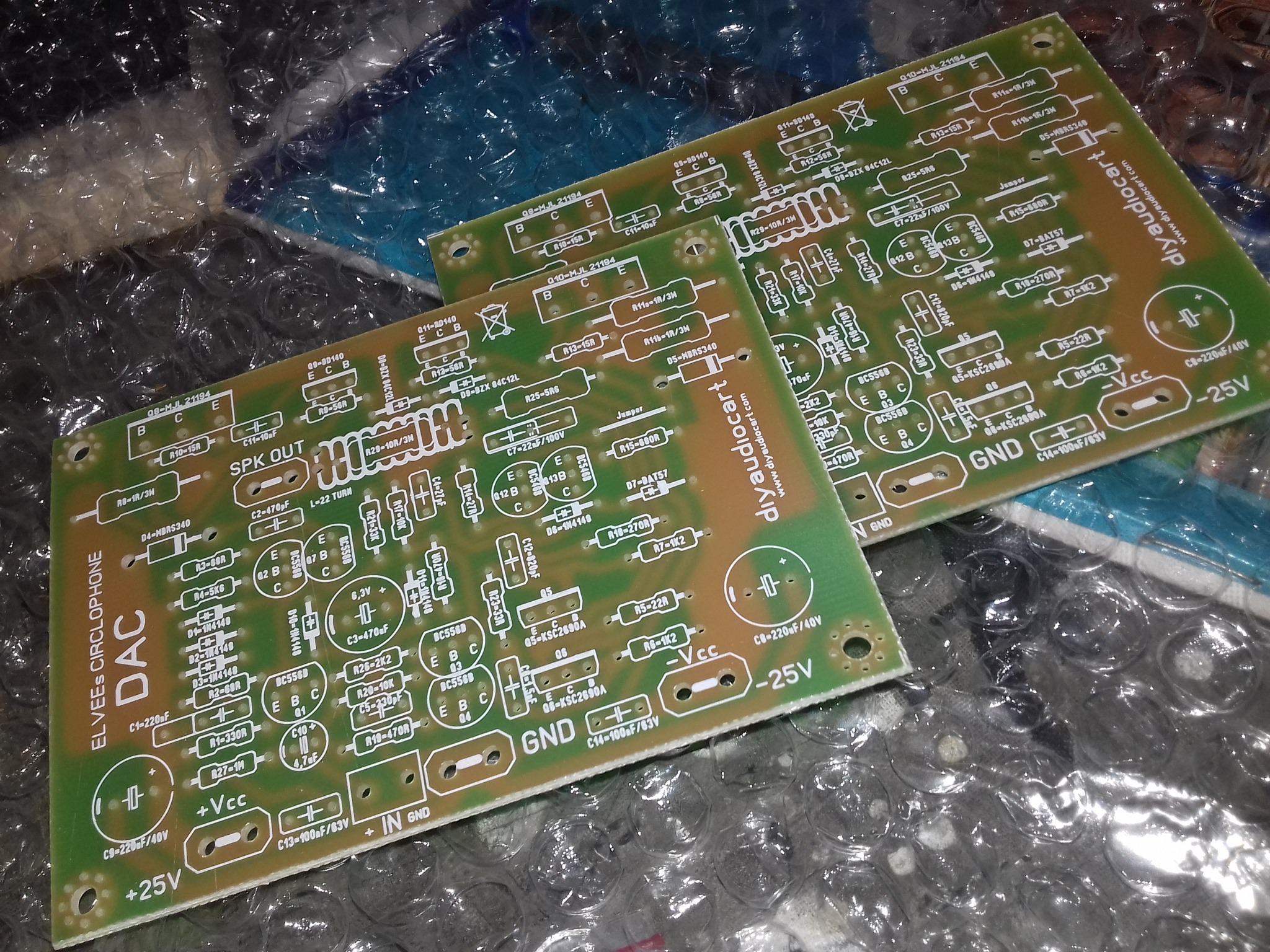

My Circlophone pcb arrived today! :hbeat:
For parts my options are.....
Output tr- MJL21194/TIP35C
Driver tr- c4793/BD140(ST)
Small signal tr- BC546B & 556B(PH)
VAS tr- Sanyo c2911(Cob 3pf, 150mhz, to-126, linear Hfe)
Schottky diode- BAT86 & SR5100
Anyway i want to thank Mr.Elvee for this world class amplifier design! Thank you!
Another user asked about a Circlophone stereo version with protection circuit complete on one board, are you interested in that too ?
I did that years ago for a German company, with central star grounding. But without power supply.
Thanks back !
Hi Oscar,
Apologies for a delayed reply
I do have a pair of boards made by Prasi, but I would really love a stereo version of the board ( 200mm wide ) such that the protection circuit is in the center with the amps on either side and a single transformer input with each amp having its own power supply ( rectifier and Caps. ).
Above was just a thought, I would be ok with what you described. I do have quite a bit of space in my eclosure ( in fabrication ) so a separate protection board can be used

I had enquiries in Germany about the interchangeability of the relays for my protection circuit.
I then took the trouble to find a relay that is pin compatible.
which is pin compatible. I found the relay with the type designation RW-SS-112D (Goodsky).
1. high switching current up to 15A in small size. (120VAC)
2. sugar-cube relay suitable for various applications.
3. UL, C-UL & TÜV safety standard approved.
4. UL Class F insulation available.
5. Highly adapt to harsh conditions with high
temperature and vibration.
6. halogen free series available.
7. Comply with RoHS and REACH regulations.
8. in accordance with IEC 60335-1 Glow Wire
requirements for home appliances.
Max. On/Off Switching:
Electrical ...............................6 Cycles per minute (this is more than sufficient).
The excitation coil only requires a current of approx. 30mA. For high power applications, such as switching inductive loads, the contact material AgSnO2 is suitable and is also recommended exclusively as a single contact. This relay has a single contact and is therefore ideally suited for switching amplifiers with approx. 150 Watt. The relay RW-SS-112D is pin compatible with the relay HF3FA12. Please note the large D at the end when ordering. The contact resistance is also within the usual range and is only 0.1 Ohm. This is fine!
Now I would like to answer ADITYA's question in post #2210.
Circlophone amplifier stereo on a PCB makes sense, but I would advise against including the power supply on the PCB. I will put the protection circuit on the PCB though. I didn't understand your question about MOSFET (protection circuit?). Sorry
What would make more sense for the circuit board? Left and right arrangement of the heat sink on the PCB ? So then it would be 2 pieces or one common heat sink, aligned as usual at the top in the longitudinal direction of the board ?
Many greetings

Hello Aditya, Ok the solid state relays are a thing of their own, usually they are MOSFET controlled !
But now comes the problem, who guarantees that the Mosfet never, I stress never, fails and thus the full operating voltage of the protective circuit reaches the loudspeaker? And the cost-benefit expenditure is simply too great. Let's stay with the mechanical solution. I think that makes more sense, don't you ?
The heat sink you have specified will be sufficient without fan cooling for 2*95 Watt at 4R. More is not possible...
