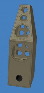

Here are a couple of more advanced designs for a 10 inch four way speaker. I have since found that my speakers can be a maximum of 36 inches tall to allow room for the HT screen so this design is too tall.
The bracing method used in this design is similar to the one in my WATT/PUPPY clones. Except this one uses doulbe .5 inch MDF and my WATT clones used double wall .75 inch MDF.
Hezz
Hezz
Here is a picture from the back showing more of the bracing scheme. Notice that the upper cabinet is acoustically divided so that the MIDBASS acoustic energy doesn't modulate the upper midrange driver.
In my original WATT clone I have additionally isolated the tweeter in a shallow closed off cavity so that the midrange acoustic energy does not couple with the tweeter magnet and frame. THe rear chamber of the tweeter is only plastic and will easily resonate with the internal acoustic energy.
This design is less ambitious but shows some of the design techniques.
Another important feature for the best midrange and midbass performance is that the midbass driver be critically or nearly critically damped. Even though this driver is not reaching down low this still effects the transient response of the driver. Therefore, if the midbass driver cannot be critically damped in the enclosure size that it has then it should be aperiodically loaded. The vented design in Wilsons upper cabinet is not ideal for the upper cabinet. The lower cabinet can be vented or sealed in critical damped enclosure or aperidically loaded. Depending on how much and what quality of bass is needed or wanted.
I don't have a digital camera but I will take some pictures of my clones and post them when I take some more pictures of my DIY projector project.
By the way, I have fiqured out how to mimick Wilsons high end cabinet design for a much lower cost. It is very labor intensive however.
Hezz
Hezz
