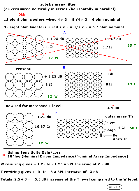

zobsky:

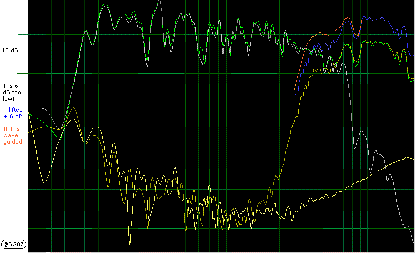

Here's the response with the crossover, pretty good, I'd say.
I think your T level is too low and as to start with always should be equal or higher before choosing crossover components.
It’s also second to none when it comes to the importance of having a good FR response to an even impedance curve.
See picture 1(2).
Obviously there is a need to increase the T level about + 6 dB. See one possibility in picture 2(2) where the T level is raised 5.5 dB.
b
1(2)
Thanks for your many useful suggestions, bjorno .
I know. and agree with, what you are saying, ... In practice though, .. I haven't found the tweeter level to be too low to much of an issue, though I do sense it a bit. In fact, it helps a bit by making bright recordings more listenable. It also provides a built-in fletcher munson curve of sorts.
I don't want to re-wire a bunch of tweeters right now, and more importantly spend more money on the crossover.
But here's what I have been doing / plan to do
1. Use EQ in foobar 2000 to boost tweeter levels a bit and cut down the mid bass / mid range a bit.

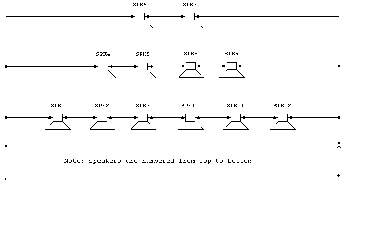

2. I could instead re-wire the woofer array as a (2-4-6) power tapered array and still maintain close to the same impedance, with the added benefits of lowered sensitivity and potentially more accurate soundstaging.
3. The choice of cheap tweeter and tweeter - tweeter spacing (I can't go much closer as the flanges are litereally touching) is causing a roll off in the high treble (see graph above 13 KHz) . This isn't much of an issue, except that some recordings miss some "air" (cymbals etc .. ) . I've being playing with my set of radio shack supertweeters crossed over first order at about 12-14 KHz to provide some ambiance. The effect is subtle but the results are promising, though I haven't made the final decision.
