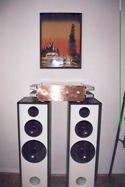

Speakers are cheap type,made by me(german people probaly know Westra drivers)but take almost anything,like 150W amp and 100W speakers work just fine.Sure you must have good crossover.

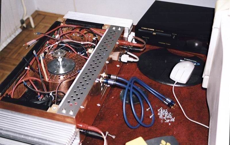

You see my DIY interconnect cables,on top right my new Marantz CD player,In the amp you see my transformer shield(probaly dont need one,but sure looks fine🙂 Above shielding is clearly seen CGP(central ground point)

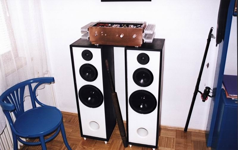

Amp,speakers-DIY,fishing gear and what is this black thing between speakers?😕
Is bad photo,but who gets even close i buy him Heineken beer 😀

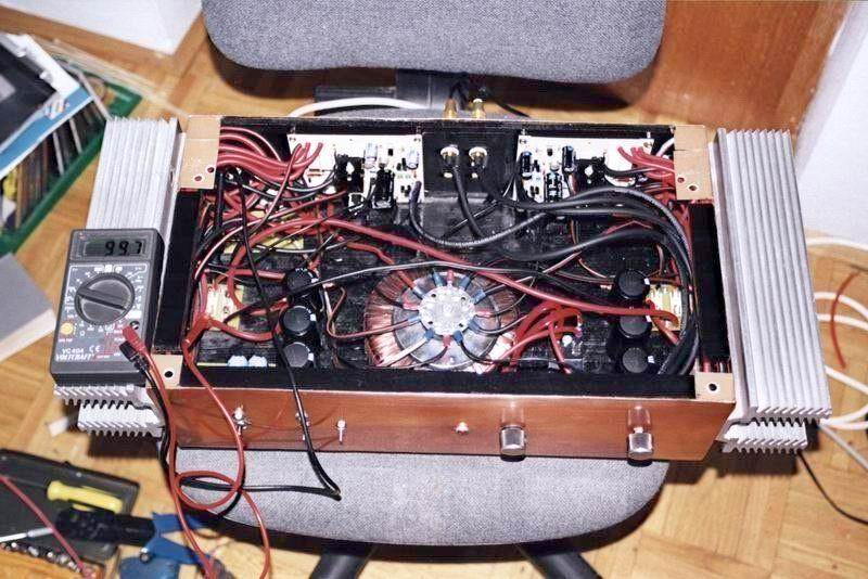

Amp insides while measuring bias current.Heat sinks i got for free predrilled,once used for some kind industrial transistors.All amps components is screwed to wood(painted black),to give extra safety and for easy mounting.Left knob was peek indikator,removed instead i built VU-meter.
Not wery good picture,amp was polished and flash did the rest.Dumb automatic,light was just right but stupid flash turned on.Whatever...

shadow, why have you shielded the toroide with copper? Isn't it more sensible to use a magnetic material in order to shield magnetic field? I think it's looks nice with copper though.
(... and of course....you have isolated the bult from the copper...otherwise big problems for those who don't know)

I raise the same concern as Peranders, and from the look of it it seams that the groundpoint is thetopside of the fasteningbolt of the transformer....
This means that your groudpoint is not at the same potential as the case...
This bolt actually becomes a separate winding of the transformer, about one halv turn.... Ie the topside of the bolt is moving in voltage in refernce to the bottomside of it.....
I have a friend who built a amp with two transformers and used centrumbolts to fasten those and a rail that was mounted on top of these.... This meant that there was a closed circuit of quite good conducting area formed by the bolts, the chassi and the bar.
We had truble understanding why the fuses blew if he had the primarys winded one way until we realised what was going on... , by shifting phase of one transformer primary the problem was solved.....
(What happened was that the bolts and the rail created a shortcicued winding through the two transformes.., by changing phase, the transformes are now working in phase with eachoter instead beeing shortcircued by eachoter...)

Sound is great and central ground point is connected to case.I just have separate wire connecting CGP to case.Heatsinks and almost everything metal is connected to CGP.

That metal thing between speakers...russian heavy cannon,antiaircraft,12mm caliber...nice huh? 🙂

peranders said:
shadow, why have you shielded the toroid with copper? Isn't it more sensible to use a magnetic material in order to shield magnetic field? I think it's looks nice with copper though.
If you want to shield a steady magnetic field then use iron or mumetal or some other ferrous stuff. However, if you want to shield a varying magnetic field such as might come out of an EI transformer, use metal that has good electrical conductivity e.g. copper. The stray field induces current into the copper, this current has it's own field which then opposes the stray field. Something like that. Ask Mr Lenz and his Law. Anyway, iron for fixed fields, copper for AC fields.
Also, single point earth is great, but not through transformer hole. There will be a voltage difference between chassis and the top of the bolt. 🙁
GP.
Thanks for suggestions,i get slight hum maybe that CGP shoud be floating and not attached to the fastening bolt.
