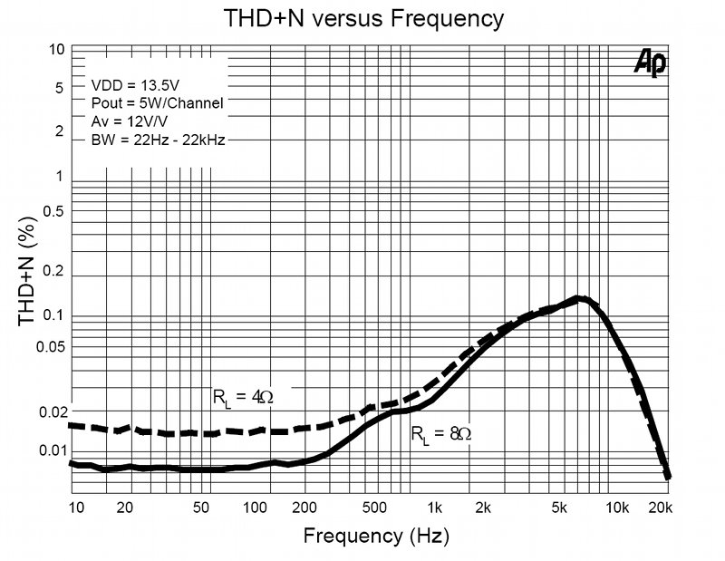

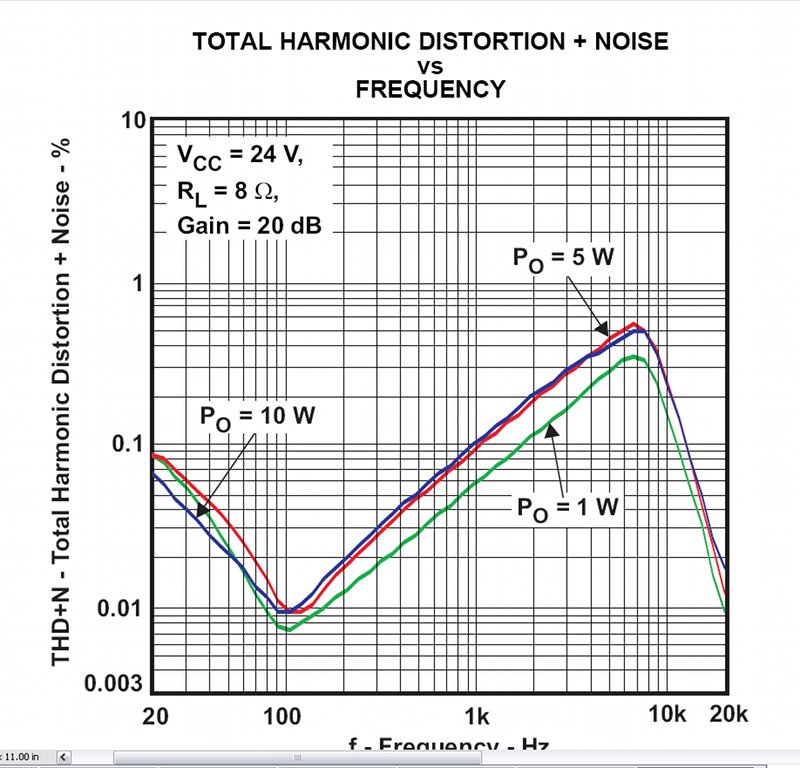

I see even in a precision PCB layers. good work.
Curve is very strange, it seems that a considerable delay with increasing frequency. You Have phase curves of this chip?
