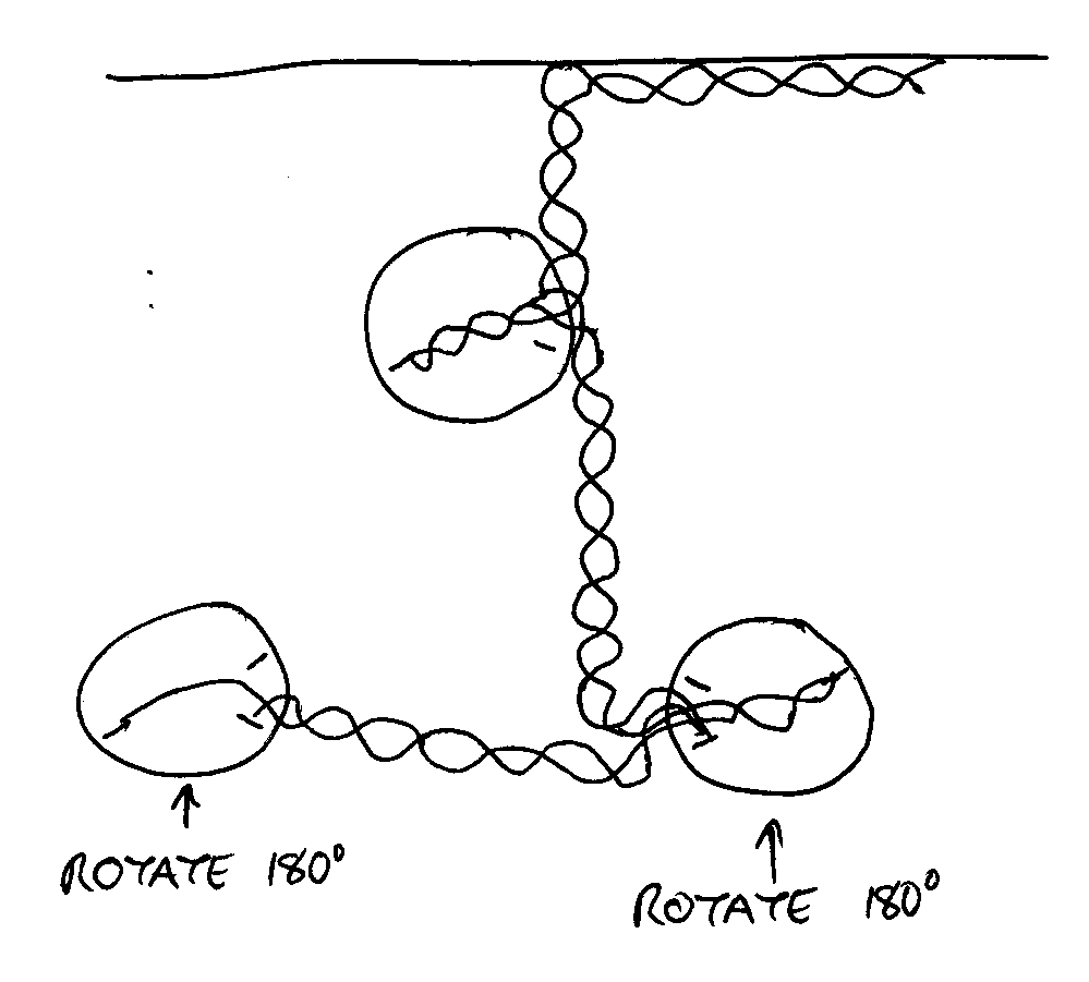

I guess I have the bug. I started building another guitar amp.
Heres a few pictures of the progress from the past couple days.
Pair of 6V6's, 3-12ax7's & 5U4 rect.
Im taking a break from the wiring as its shown here in these pictures to build the Oak base it will set on. All of the Pots and jacks will be mounted on seperate front and rear plates routed into the oak base.

Notice the blue/wht wire? Am I Setting myself up for ground issues? or just being redundant?
I wasnt sure if it was better to count on the chassis as reliable ground or better to hard wire it to just a couple points. So Now Its BOTH!!

Oh dear...
That's going to hum like one of those words that we shouldn't post. The whole point of twisting heater wire is to minimise the size of the loops and to attempt to cancel the field, yet you've twisted your wire right up to the point where it became really important (near the small-signal valves) and then not bothered!
Yes, you really do need to keep a tight twist on the heater wire and take it from one valve base to the next. Big loops near valves are not allowed. Ideally, the heater wire should be pushed into the corners of the chassis and come up to the valves by the shortest route, which usually forces the valves to be in a line along one side of the chassis in low-hum designs. It's also useful to ensure that the sockets are mounted so that their heater pins are nearest to the edge of the chassis from which the heater wire will come.
Your wire looks to be rather thick (making it difficult to achieve a tight twist). Remember that by the time you reach the small-signal valves the heater current is reduced, so you can use thinner wire (which will take the required tight twist).
Sorry to sound so negative, but heater wiring is virtually impossible to replace afterwards, so you have to get it right first time.
Your positioning of valves isn't ideal, but it's far too late to change it now. The diagram of suggested heater wiring may help matters.

I hardly concider the comments negitive 🙂 , That was actually one of the reasons for posting the pictures at this stage of construction. I was actually concerned enough about the heater current that I ran a seperate set of wires for the 6V6's and the 12AX7's.
Question, Would adding a full wave solid state rectifier to the heaters help the hum issue ? If so, how big of a cap would I need? Also, Would It be wise to apply DC to all filaments or just the 12AX's? or is it better to run it to everything on the 6.3v line

OK,
I rewired the 12AX7's filaments as shown in This Picture
I have to admit, Its not perfect, But I am sure its a far cry better than the original job.
I would rather not add a SS rectifier, But, If It hums to much, Its an easy mod.

No loops!
Better, but still not quite ideal. You really, really don't want loops around valve bases. A loop like that it an aerial and you've put all your sensitive audio inside it! When the wires are twisted together, the hum field tends to cancel, so you want an absolute minimum of untwisted wire. Secondly, although it seems counter-intuitive, it's best to take the (twisted, of course) wires across the valve base than around.
Another way to minimize the hum from AC heaters is to build a voltage divider and "bias" the heater supply above ground by about 30v or so. It works well. If you do this you have to let the heater supply float. Don't connect it to ground!
