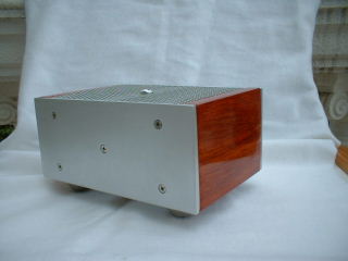

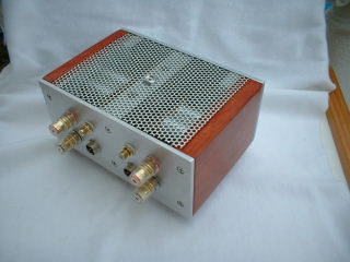

It is much easier to built than a conventional GainCard chassis and I think it has a chance to sound better. Here how I integrated a temporary volume pot with the amp. http://www.diyaudio.com/forums/attachment.php?s=&postid=272585
The amp doesn't really allow for one pot inside and I don't want to use two separate pots.
Maybe a Patek Gallery should be in order?
Make sure to use one bolt and a nut and a non threaded hole all the way through the bar to clamp the chips. that way they are clamped with equal force 😉
I think Tony might have equaled you on this one Peter!!!
It's not recommended to use the same screw for mounting the chips. First of all, they are not mounted the same, but positioned in such way that outputs on both channels are closer to back panel and pins are at the same height . A copper bar is used to hold the chip (so 2 holes are needed). I'm using cordless screwdriver so torque is the same (lowest value).
You are right that he might equal me on that one (although he didn't use premium materials: copper and bronze 😉).
he Patek offers some interesting design options. I drew one up on CAD and you can place the pot very close to the chip pins and it cuts down on HS area. I need to scrounge up a design using the hammond enclosures that wont take major cutting.

Patek is a watch maker, better than Rolex. If you consider a GainCard as a Rolex of chip amps, you know what Patek amp means😉

You are not far from truth. I had a bad weekend after transformer volume control stage was taken away from my system and out of desperation I created this😉 It sounds pretty good and eliminates the need for an additional interconnect.
