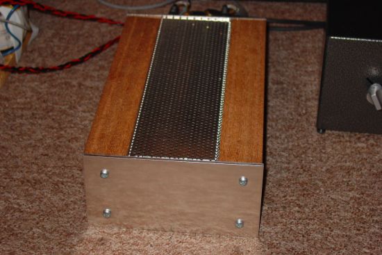

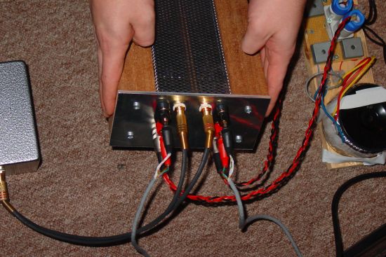

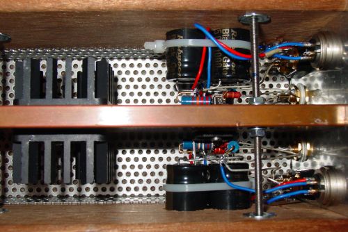

I've been looking for a place to show off my newest gainclone 😀. Couldn't really find any ongoing threads for it so I thought I'd start a new one. Well, here it is.
A blatant rip-off of a Peter Daniel "Patek" clone (hmm, a rip-off of a clone 😉).
Anyway, I finally understand what all the fuss about those clones is about; it sounds surprisingly good. After having built a couple of amps for testing purposes I came up with this one. Or actually, I agreed on the opinion of many other people that the following specs are pretty good.
2x Rubycon BG 1000uF 50V
1x rubycon BG 4.7uF bipolar input cap
Riken Ohm for setting gain: 22K/1K
-> I've just ordered some 22K Caddocks
Standard carbon 1W for the rest.
It's been playing for about 8 hours now and already it outperforms my previous GC's.
A few pic's.

I see, in some ways, you even improved on the original Patek concept. Well done. 😉
From all resistors I tried, Caddocks seem to be the best for feedback loop.
thank you peter. 🙂
(what ways are you referring to btw?)

Nicer wood panels and more pleasing proportions😉
I see you still use regular bridges. Try MUR 860.
Also, the footing on the amp is quite critical. Try to use one foot on each site, and then a spike (at one point only) under the central copper bar.

Caddock
To Peter Daniel : Which type ? Caddock have many types and also others manufacturers have similar. P. S. : If you hear differenes between rectifiers in PS, your amp is not OK ( rails and ground lines )
I only tried MK132 as it's most popular and right sized (for feedback loop) Caddock resistor.
If the amp's not OK, it's not rails and ground lines fault, but National's design team
To Peter : I am assuming, that National team don't drive your brain and hands by making your own PCB😎 , isn't true ?
No PCB
Was you born in year 1910 ? When I look on your photo, I mean that you are younger
. Also without PCB your wiring is not OK
. Imagine : NASA makes "high tech " product such as Space Schuttle and brag about that is made only with solderind iron
Well, this amp is not a space shuttle and since only 3 parts are required, it would be extremally stupid to use PCB.
I bet you can't do this type of assembly with a PCB: http://www.diyaudio.com/forums/showthread.php?s=&threadid=22733&highlight=
And 2 dimentional plane here would actually introduce more complications than improvement. Are you gonna argue that wiring is not OK here as well? Because I don't see any wiring.
PCB or not PCB
Minimal count of devices around typical integrated power amp is approximately eight, not three. Pics which you show me, I take as good for prototype, not as like final work - if is it enought good for you, my professional honesty say no. In this case we are probably quite different - I mean, that DIY may be made the same as the best profi product and man should not to say "..it play, let it be..." .

..and let's end it up this way.
PS: For you it may be just professionlism and good looks that count, for me it's a bit more than just that. Check my signature, to see what I mean😉
