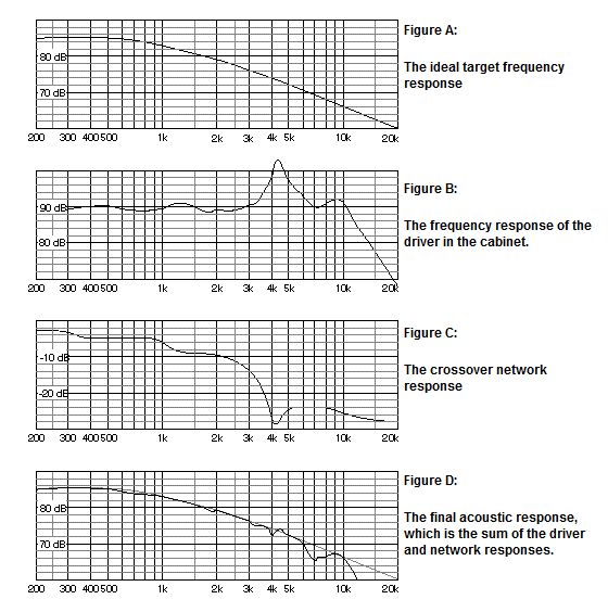

Afternoon all,
just to bring this thread up to speed, the drivers are now in cabinets, very ugly sealed MDF boxes but I can finish them later when I'm happy with the sound.
The XO sim from crossover designer 7 has proved to be very accurate, which is always a total win. Have built into sealed boxes, which sound great by oh-my do I miss bass! In the middle of moving house so hopefully when I do I can get my sub to start taking over about 120 and it won't feel so much like something is missing, but in the mean time the clarity is great.
Right now I'm running these with 2nd order crossovers, cheap ish components and very pleasurable to listen to, if a little forward - but that was to be expected given the XO design (is a little hot at the top end as I was looking for an electrical 2nd order that worked with what I had laying around once I'd built the cabinets)
From playing with crossover sims it seems inevitable I'm going to end up going for a 4th order electrical crossover - I can get an almost perfectly flat response, impedance and phase alignment with no additional components, bar a voltage div on the tweeter.
Only problem with that of course is cost of caps and inductors - the 4th order model uses a 10uF and 15uF cap on the tweeter, as the drivers have high potential I'm fairly keen on using mundorf supreme caps for the tweeter circuit.. that leaves me at a bill of over £100 just for tweeter caps... probably worth it, but maybe a more long term solution.

Because I was/am crossing so low there's no problem with the peak, either 2nd or 4th order.
I've run various sims through PCD 7, but without the baffle step (which was basically a flat drop from 100 to 1000Hz of about 6db) so the sound wasn't right-very clear and bright obviously, but in a sealed cabinet 4th order electrical they sounded way too thin. My old room was smaller and the positioning of the speakers meant baffle step was minimal, so they worked a lot better there - one of the reasons why I consider a full 6db baffle step as usually bad practice, it makes no sense to drop so much when the energy is still there in the room and going to interact in some way (though obviously in a larger room and open space as I have now that really is minimal)
Porting the sealed enclosures has helped no end with bass response, however there is no doubt the tuning is bad and this is causing the midrange to sound a bit confused, that's a large part of the appeal of a dedicated 3 way and midrange, and aligns with my previous experience - invariable, the 3 way speakers I have built in the past have had a realism with vocals that seems to 'bring the artist into the room' rather than just 'sound really nice' - that's not to say the 2-ways can't be superb, on things like madonna's frozen or michael j's human nature they sound excellent, but again the lower mids just aren't quite right.
Another problem I'm facing is my set up is a big step down from what it used to be (due to being a student and hawking stuff on ebay) so I don't have a high end amp/cd player at the moment. I'm running a FiiO DAC (£30 of amazon) through a Denon PMA 250 integrated amplifier - I'm pretty sure I'm near the limit of what this front end can achieve, so improvements in crossover topology are hard to identify.
I used the measurements from zaph for both impedance and spl measurements, imported into PCD 7 using dagra, where curves ended early I simply continued the curve, I felt it was safer to work with data from one source as I didn't get around to measuring drivers in cabinet - ideally this is the next move before anything else.
I've tried everything you could imaging regarding sims, my main objectives are to present a stable (flat) load to the amplifier, with minimal phase shift (electrical to the amplifier) a flat summed and power response and relative co-herant phase response from the drivers (within 10 degrees or so)
I do believe that crossovers should be kept as simple as possible, however fully accet that under certain conditions additional complexities are unavoidable, be it notch filters or flattening impedance.
I try to pay careful attention to what is really going on electrically so that there is a tru balance with the system, and do believe that great care needs to be taken when adding things like notch filters, which can be very useful, but the interactions of inductance and capacitance/resonances through the entire transfer function is something I want to minimize and therefore simpler is better in many ways. Obviously I have many other ideas about how I like to design crossovers but not worth mentioning here.
The benefits of a notch filter in the sims wasn't worth the hassle, either in financial component cost, increased complications or final results, the crossover frequency was low enough anyway.
Playing with the sim today I introduced a BSC for the first time with real seriousness.
(not just playing)
I came up with a 4th order electrical solution using LR4 targets hitting about 2.2kHz xo, however the cost of caps alone would be about £50, more than I'd want to spend on a 2 way when I know a 3 way is in the future (those big 2nd caps on higher order tweeter crossovers really put me off from a cost perspective, especially crossing this low where a 22uf cap is required)
I reconsidered with a 2nd order electrical and baffle step maintained. That's currently looking like a very good solution however still no point ordering the parts until I've measured and confirmed these actual drivers in these cabinets - then I'll get a lot closer.
When minor note that I liked, using the BSC circuit and a VERY large cap in the woofer filter allowed me to avoid much of a peak in impedance at the xo frequency - from aout 150Hz the impedance stays within 7.5 to 8.5 ohms. This also means I can use a very low value inductor - lower DCR, lower cost, win win in my books.
I don't mind the cost of a standard M-cap for the woofer bypass...
