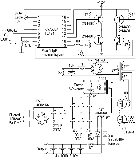

Eva said:Your layout does not show any safety spacing (5mm recommended) between mains live side and output side.
streetera said:Needs at least 8 mm creepage and clearance between input and output (including across opto / isolation barrier and any swtiching XFR)
Nice the pros put up some numbers on safety distance. But the CE regulations demand at least 6 mm creepage and clearance distance for class II and 0.4 mm isolation thickness minimum anyway between the mains parts and touchable LV parts.
Even it is DIY and for you own use (and risk), it is wise to comply with this distances for your own and others safety.
Cheers 😉

In my smps the voltage is 342VDC input (127VAC with doubler) and the output is around (regulation less) +83/-83VDC and there´s not danger enter primary and secondary tensions. I never have problems with safety clearance because 3mm is very good distance. Remember 1mm/air isolation = 1000VDC , ok?

nice work
hi,
Nice work CHACALPOWERS . I was wondering if you could post the schematic of the SMPS. I am also building an smps with sg3525 controller.but mine is 12v to +/-50v 400W.Planning to build a sub woofer amp for car with it.
thanks
hi,

Thanks by your message. I can post the schematics but remember: this smps 127 VAC input and your project work with 12VDC. I built a 12VDC SMPS input and +60/-60VDC output. I think post pics here in the site.

Hey friend, look my car audio project. It´s a Rod Elliott project based. I like it so much. 12 IRFZ48N, big toroid, SG3524 pwm controller.
