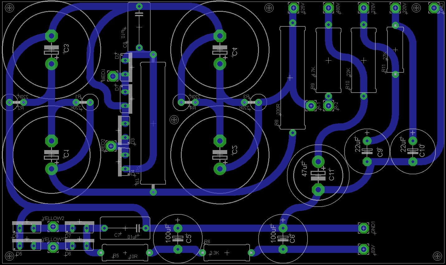

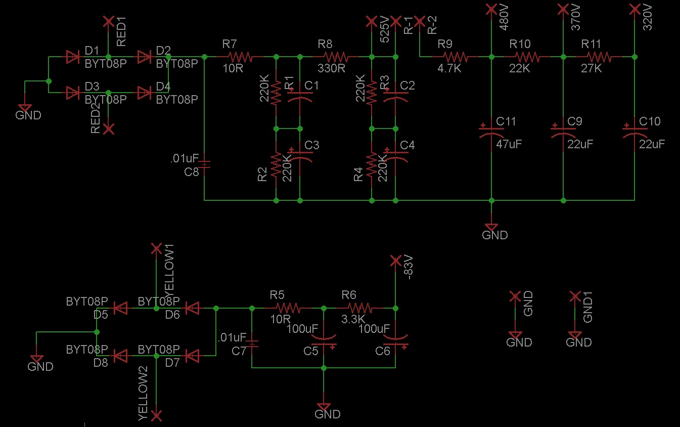

First time builder.
I have been interested in tube amps for a while now, want to know what the buzz is about.
I have chosen this KT88 as my first build, my two reasons for this choice are.
First the documentation is incredible. Second is this is what i would consider middle of the road complexity tube project.
I will have more questions later, but for now i am starting with the power supply. I have done the layout for it in eagle 6.5.0 and attached. I made the board with all traces on the bottom. This way it works well with a LPKF mill or etching. I would appreciate you the veteran tube community to give your feedback on this young pups first amp build.
My main concern is that my gnd path is to long, I am thinking of soldering a wire from the gnd of C1 to the gnd of C11.
Thank you for your time!!!

just dawned on me that not every one has eagle.

I have never build a Push-Pull amp and this one is very atractive.I have a Power Transformer that has an output os 400V@500 mA for B+ and 70V@100 mA for grid voltage.I want to use it for both channels.
My concern is about - 83V grid voltage....can my Power Transformer feed 4xKT88 grids tubes with only 100 mA?What is the current draw of grid?

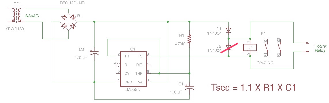

Here it is. Note that on the relay part number specified the coils are actually DC polarized, so you have to make sure the polarity is right or they won't engage. Part numbers on the schematic are from Digikey.
Hi, the diagram of the delay circuit contains an error. Diode D2 will drain the voltage over the relay coil down to 0.8 volts... Leave it out and it works as explained, otherwise it won't. See below..

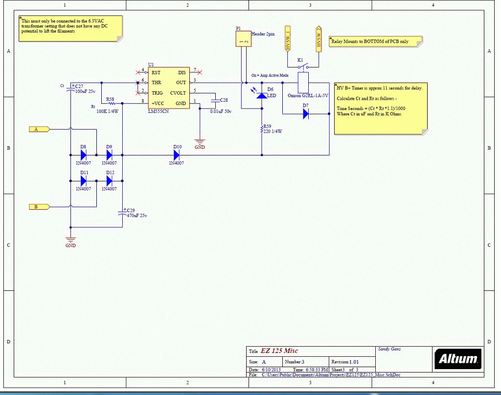

Works fine with the diode as I have it as well. Makes sense since the 555 is the sink in this case. I'm using it as a delay to short out a large resistor until the main caps get charged up a bit. This was from the EZ125 KT88 project I did a while back.
Sandy
