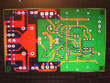

If you mean PCB, I think you've published it in the beggining of your post.
I'll make it from there. If I won't make it, I'll let you know.
aestosa, here's a pic of the board. Green being the top layer, red bottom. It's not the greatest image but hopefully it's enough to get you started. I'll post shortly a new schematic with part numbers that match the silk. Let me know if you need anything else. You'll be amazed how great this little amplifier sounds.
Best regards,
Al

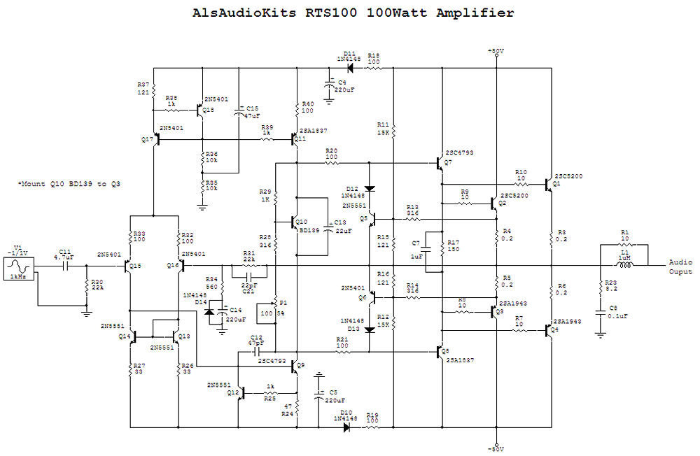

Hi Leolabs,
I guess you mean why not try a Darlington VA stage. I understand the advantages from a design stand point but in IMO sonically it makes no difference. And my objective all along was to build a simple amp with a low parts count with great stability, that sounds great. The low parts count allowed room on the board for high end components that are normally large like Black Gates, Nichicon, Auricap caps to fit on a small board.
I tried many different circuits, starting with the schematic below with two output transistors instead of four, and many variations of it. I tried symmetrical versus non symmetrical. In the end the KLA circuit sounded best to me and my three test subjects.
I've tried this circuit before with an external power supply and it didn't sound nearly as good. I think the magic from this little amp comes from placing the AC filter power supply caps on board, and possibly from the amps top side ground plane.
Has anybody out here tried a similiar layout?

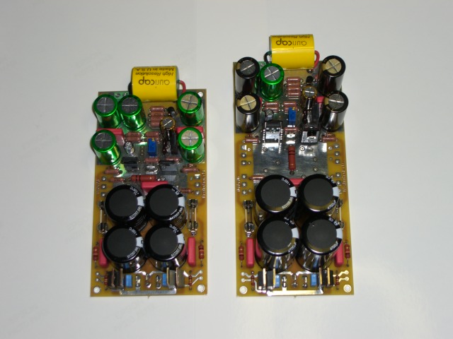

Here's a pic of may latest 60 watt and 100 watt amp prototypes using the same schematic found in post #2, accept I added two more ac filter caps on the boards, and for the 100 watt two more transistors. I'll try to get some measurements out this weekend. If Everything goes well I'll order some boards next week, I figure I should have them two weeks after that. I'm thinking about giving away three pairs for free including shipping with BOM and assembly instructions. I may even include parts, because it's crucial to the performance of this amp. All I ask is that you post your listening impressions on this forum, either this thread or a new one. I prefer someone with a technical background in audio. Some people may think I'm crazy, but I'll love this hobby as much as anybody, and I really want to know what other people think of my work.
- My Killer Little Amp
