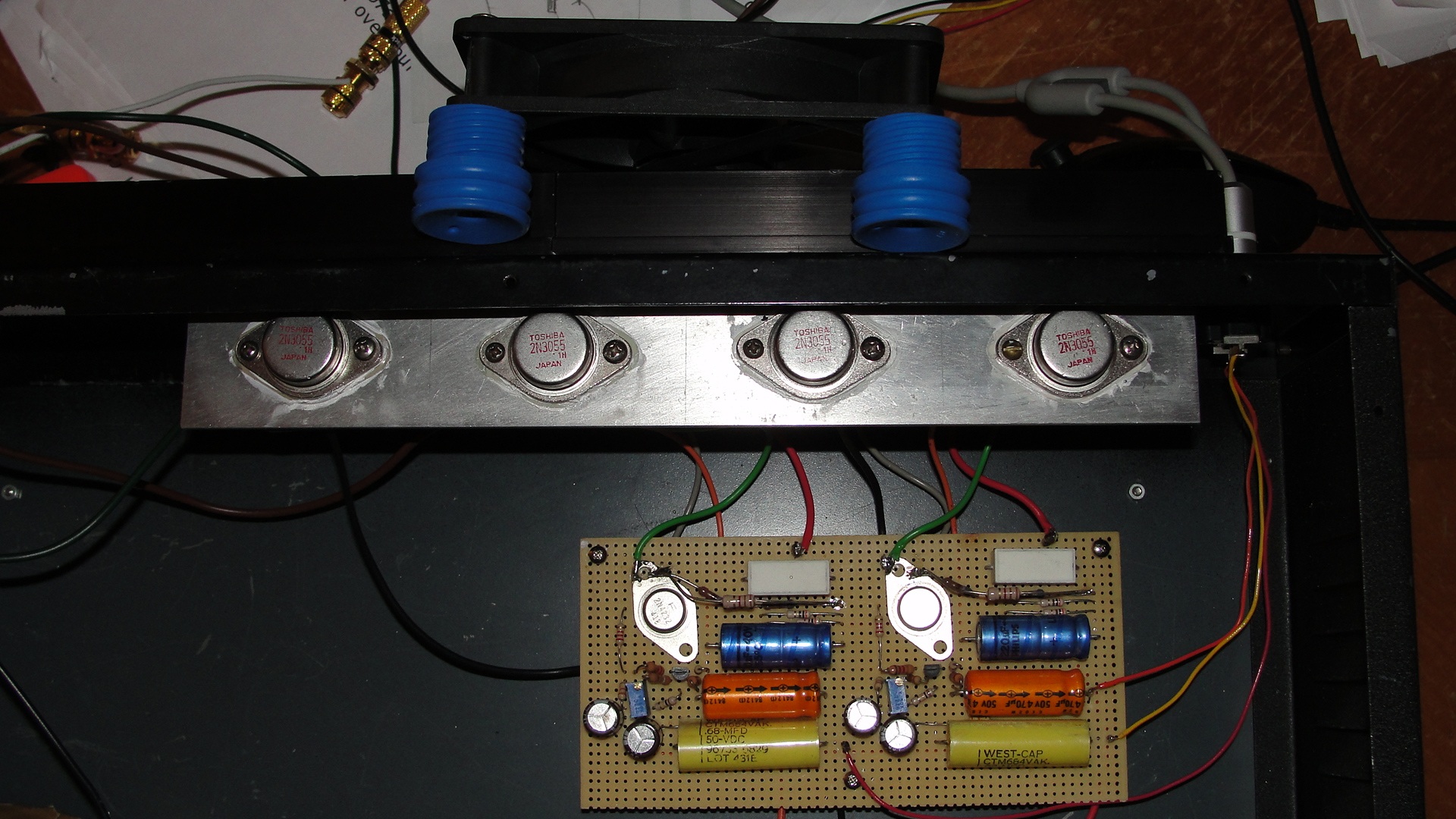

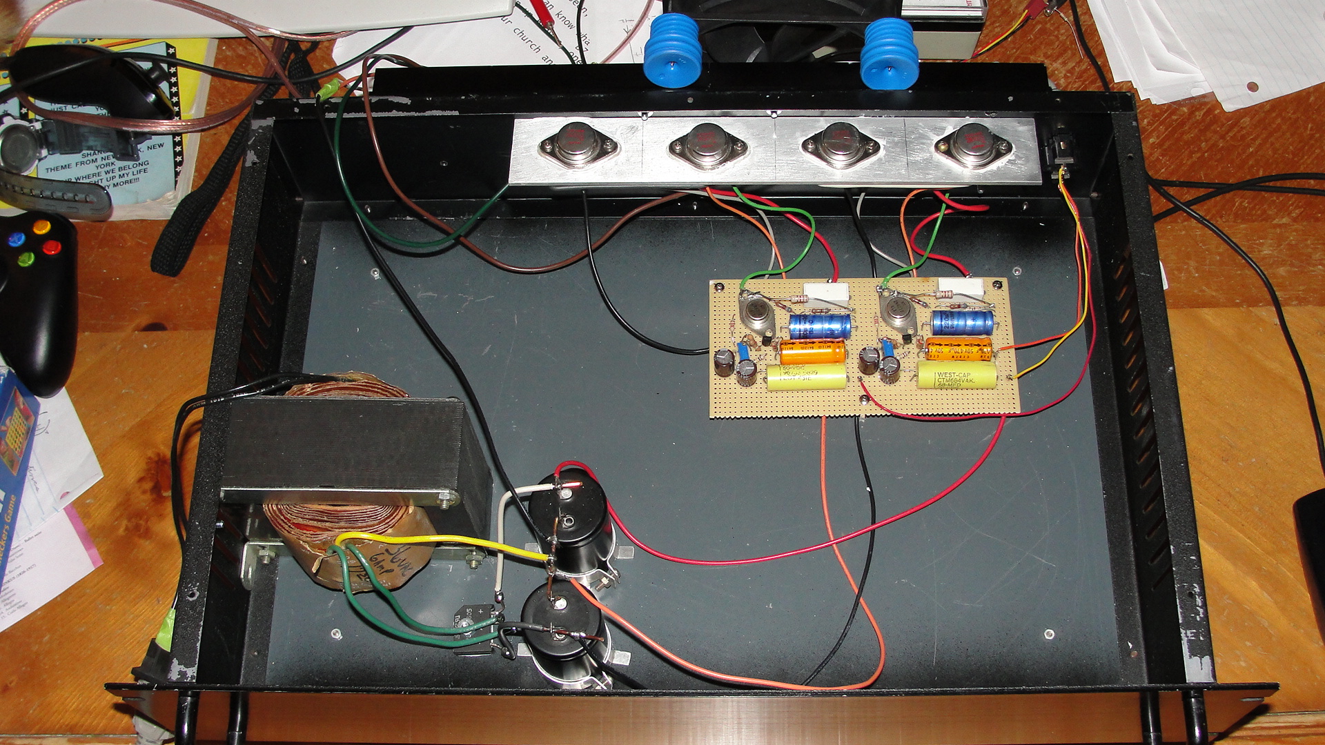

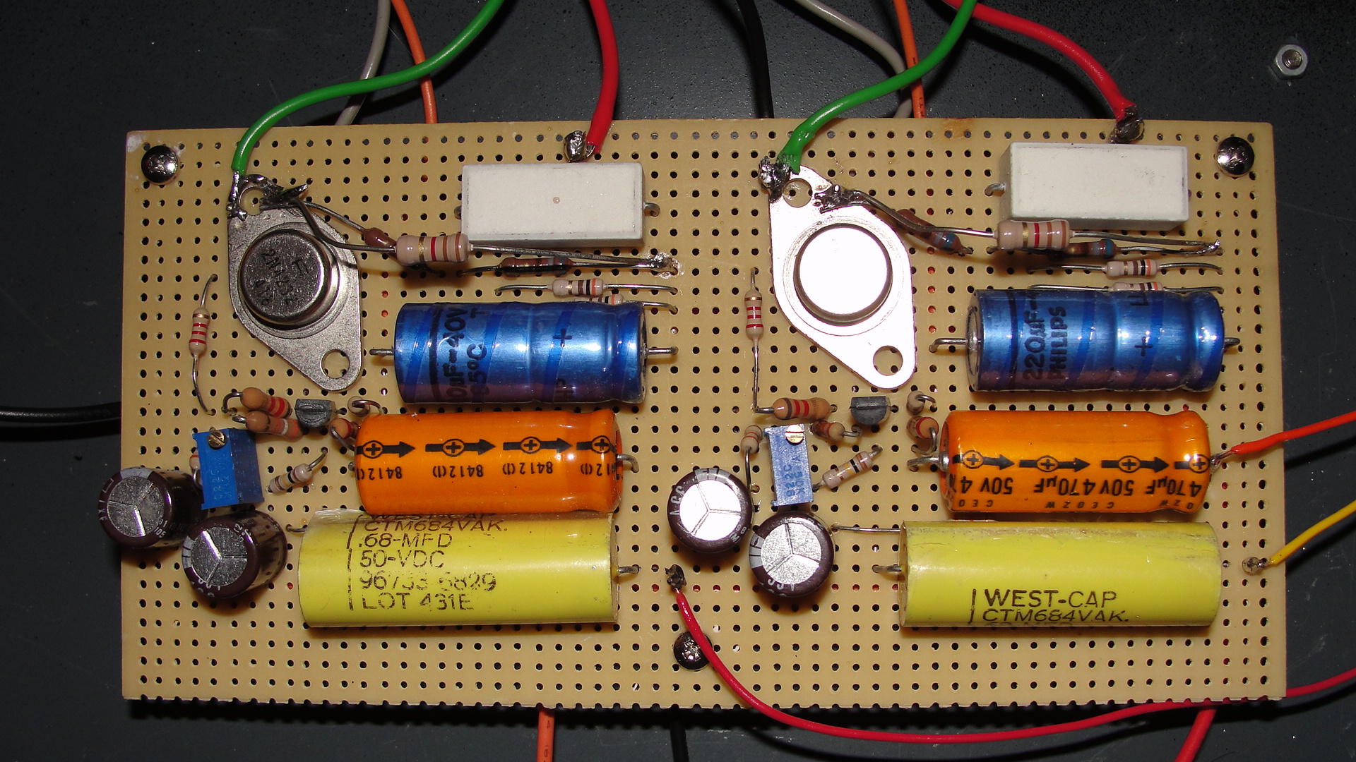

Few more pics here......

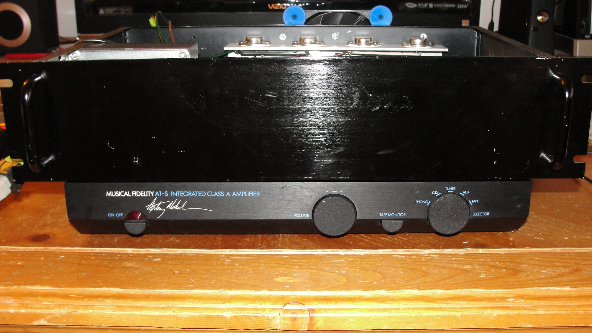

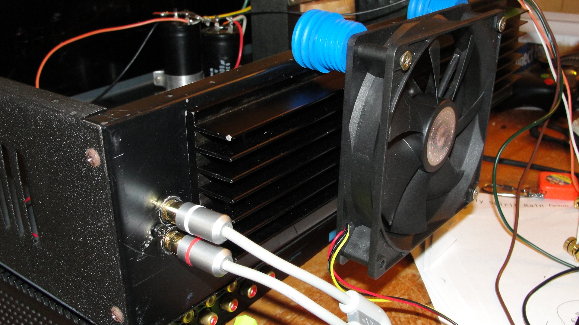

I have done a little more on the amp mostly finishing up and here's a few more pics.

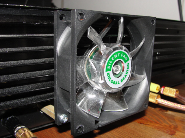

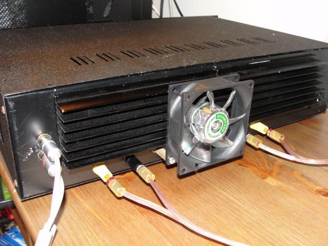

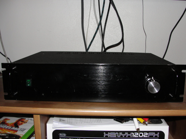

I mounted a front power sw with built in light (left) and a volume pot (right). Then I permanent mount a 80mm silent computer fan (got from newegg) powered by a cheap 12v wallwart mounted inside the enclosure. It keeps the output transistor at a good temp and will not overheat.
I found myself enjoying the amp everyday even just with the low hFE fake Toshiba. (Haven't receive my 15003 yet). My other remaining minor issues are trying to add a pair of filtering caps to form a CRC filter to get rid of the tiny hum from power rails and a slight vibration top panel due to the location and close proximity of the power transformer (links below).
