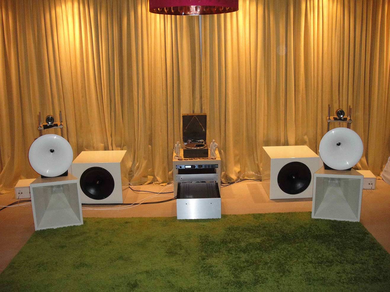

The horns are 350hz Tractrix (stated) but they are at F3 by 800hz. I am using the JBL 2441 compression driver with the Radian diaphragm with the mylar surround. The woofer is the JBL E140 15". Not ideal and the bass cabs are designed around the Lambda TD15M which will be going back to AE for reconing. With the tweet off to the side (which I thought would never work well) the sound stage is unbelievable in width and depth. Don't know why it works, but it does. I put foam on the back side of my horns too, but it made no difference with the sound or measurements.
I wish I could lower my horns as the deep male voice is obviously coming from both the woof and the horns. With them closer together, I think there would be more and better integration.
I am using a first order passive but building three amps to go active three way.

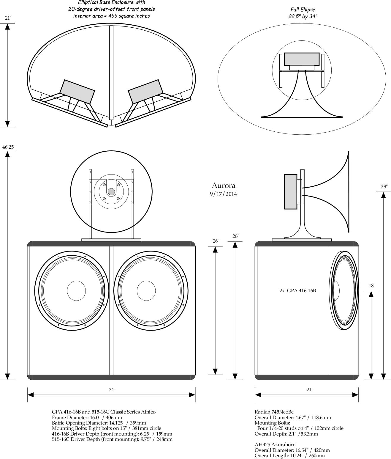

Very nice system! I never would have thought to use the Heil AMT dipole with a separate tractrix horn. Heil AMT is the best tweeter ever made.
I had pretty good luck with my foam core tractrix hitting 350Hz driven with a TC9FD or a Faital Pro 3FE22. Very sensitive and loud.

Vgeorge, I've been looking at the Inlow 135 Hz midbass horn as well; very flat and efficient, and a good match to the AH425. The only alternative I can see is a pair of direct-radiators in a closed box, for example, a pair of side-by-side GPA/Altec 416's. Overall floor-space required is similar ... wider for the side-by-side 416's, and deeper for the Inlow 135 Hz midbass horn.
Crossing over to an independently powered (and equalized) subwoofer is a great idea. This relieves the main power amp, and greatly decreases excursion of the mid and upper-bass driver(s). Result, lower IM distortion from the amplifier and the bass drivers, and more headroom for the system.

That picture really emphasizes just how compact a good system can be (..even if it is quite deep).
Quite amazing. 😎

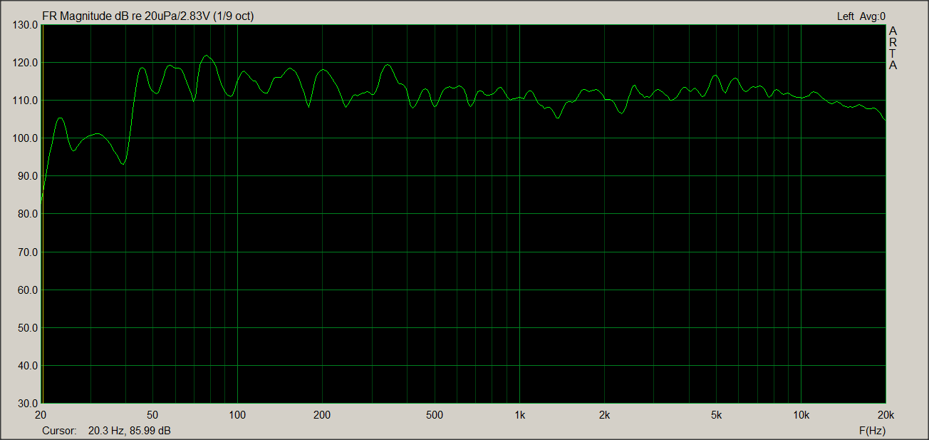

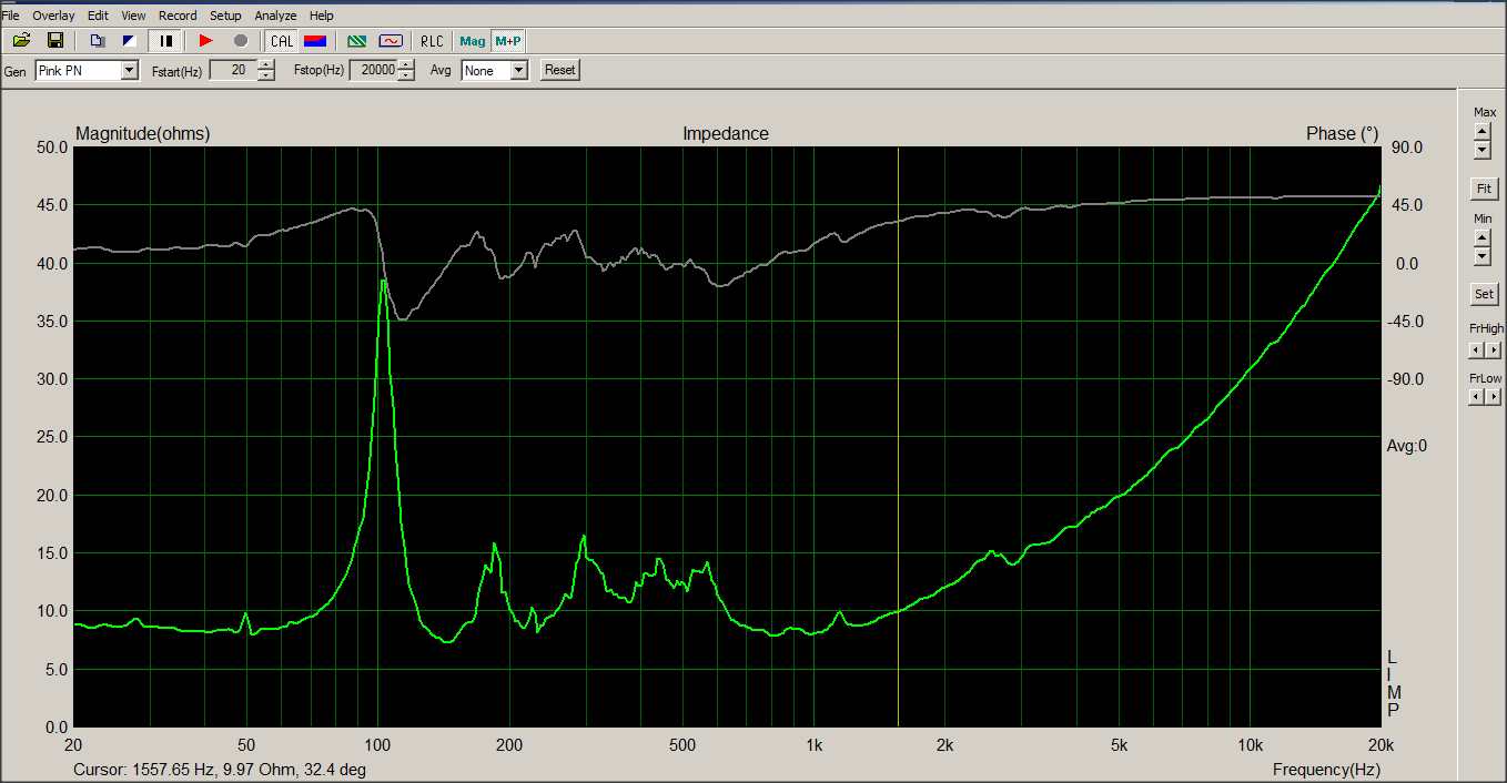

I attach some of my initial measurements, an impedance measurement of the 135Hz horn (maybe of use to Lynn) and an frequency response of all the system, both speakers at listening position, with no special measures. I was looking only for the crossover at this time. Kindly note that now it measures even better, as I have adjusted the woofers a little bit better and the small dip in the 1,3kHz was due to mic placement probably, but these were the last measurements that I had saved.

Pretty good measurements, but the horn's a bit resonant.. maybe some 6"+ thick acoustic insulation as a frame around the mouth, and perhaps some green-glued weight on each outer "panels" of the horn? Done well that should knock-down the ripple.
..and yes, definitely try it again with further set-back, top-panel absorption, and up higher on its own frame. 🙂
-at winter of course. 😀
Note: a thick blanket(s) wrap and some measuring should tell you if you'll gain anything by most of these potential mod.s without costing any money. (..maybe some sand in a large bag for at least 3 of the 4 panels to try the panel damping.. ..err, you do have a beach with sand on that island of yours, right?) 😀

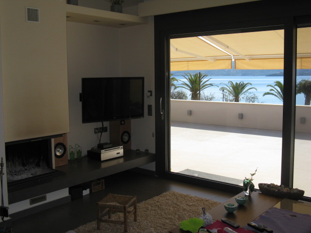

No, this is in the basement. Family has the seaview on top. The good thing is that the room is fairly isolated from outside noises and wife kids etc!
I can listen to music when other watch TV, cooking and doing their things.
Have a glimpse pf my TV system with some of the view. Speakers are using Jordan units.
