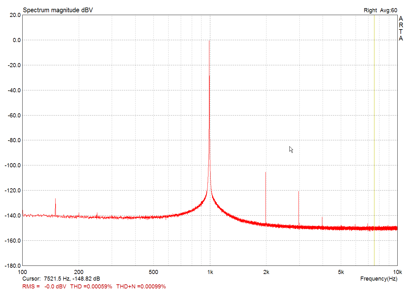

Hi Samuel, after a few changes I just did a couple of tests with both analysers - using the Bainter/Twin-T double notch I get a fixed ~-140 dB 3rd harmonic residual, while the 2nd harmonic level varies between ~-127 dB (HP out) and ~-140 dB (LP out); the 2nd harmonic from the BP out is ~3 dB higher (~-137 dB), which sounds a little bit strange. The SVF auto notch is considerably noisier: the 3rd harmonic is consistently beyond noise floor, while 2nd harmonic level lowers almost exactly by 6dB/oct switching from HP (~-126dB) to BP (~-132dB); the 2nd harmonic from the LP output is buried in the noise. The generator's output level is +10dBV, and its output is lowered to 0dBV before entering the analysers.
Just to answer your question about noise performance, here is a sample spectrum acquired with the EMU:
The amplitude stability and the settling time are both satisfactory, the main issue remaining the startup time, which is unbearably long; once started, a stable output level is reached in about 4-5 seconds. I still have to address this.
My goal is to achieve a very low THD for, say, 4-5 spot frequencies; I've also tried a variable-frequency voltage-controlled setup by inserting a couple of AD633 in the SVF ring, and it worked very well, by its THD performances are limited by the multipliers' THD, as you pointed out.For a fixed frequency oscillator it is in fact much simpler to just add e.g. a Chebyshev low pass filter at the oscillator output rather than spending too much efforts in reducing level detector ripple and multiplier distortion.

The 2nd harmonic from the BP out is ~3 dB higher (~-137 dB), which sounds a little bit strange.
So it seems like there is some cancellation going on. What capacitors/resistors have you used in the notch filter? What's its operating level?

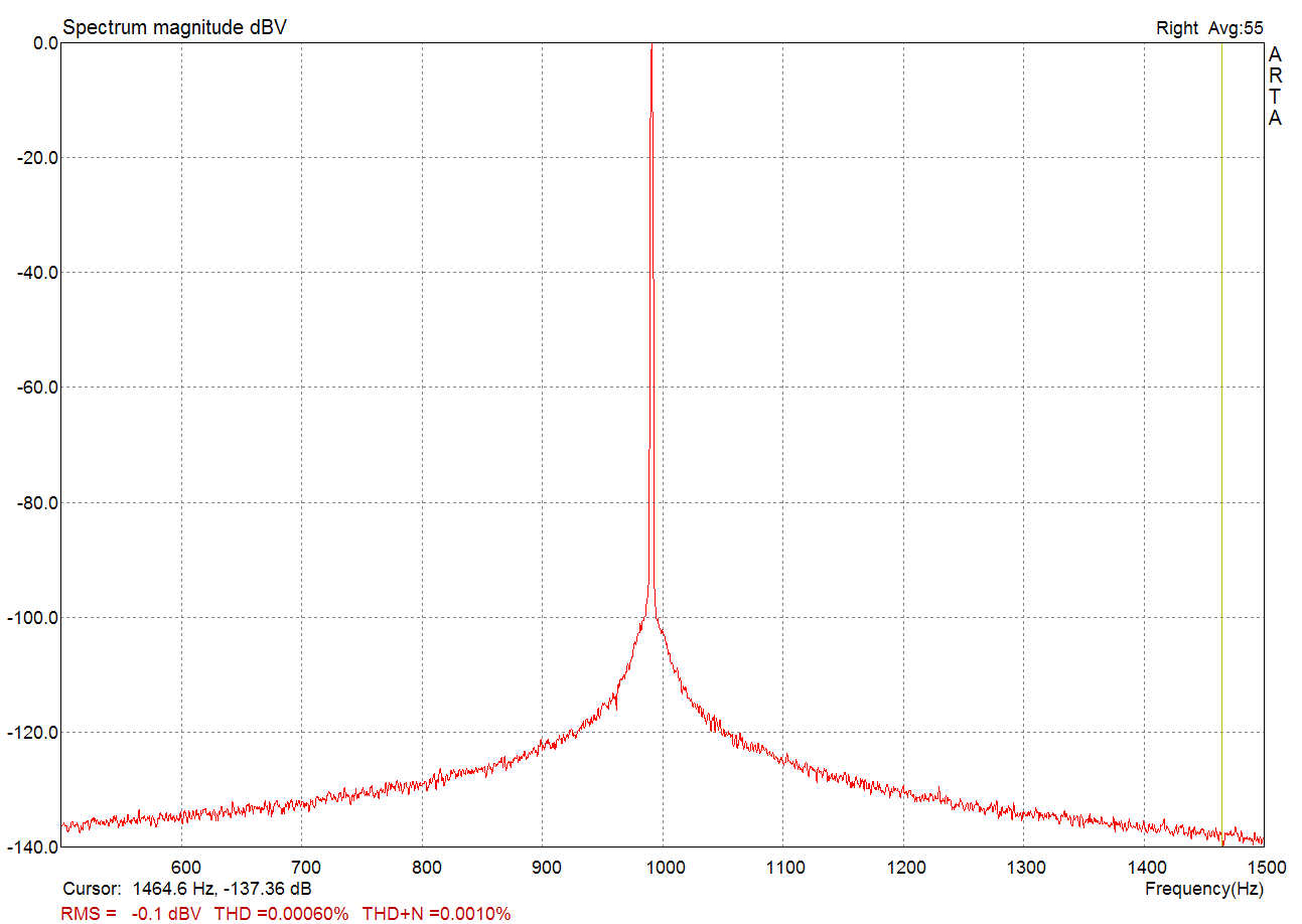

If you want to determine the actual sideband performance of the oscillator you must make sure that the FFT window has very good sidelobe performance; it looks as if on your plot window sidelobes would actually mask oscillator sidebands. What window did you use?
The amplitude stability and the settling time are both satisfactory, the main issue remaining the startup time, which is unbearably long.
Its not entirely clear to me what you mean by "settling time" and "startup time"; as we usually power up our oscillators just few times a day 4-5 s seems fast enough for me. What's important is settling after a frequency change.
Selected polypropylene capacitors/1% metal film resistors. Both notches were designed trying to keep as low as possible CM distortion, so SVF has an 'all inverting' topology, and Bainter was chosen because only one out of three opamp is in non-inverting configuration. The operating level is 0 dBV for both, but this is a real issue only for the auto-tuning one.
The spectrum was taken with Hanning window, which is far from optimum from the point of view of sidelobe suppression - Blackman-Harris or Kaiser would behave better, but I don't remember such a great difference in spectral line shape using these ones; nevertheless I'll try them.If you want to determine the actual sideband performance of the oscillator you must make sure that the FFT window has very good sidelobe performance; it looks as if on your plot window sidelobes would actually mask oscillator sidebands. What window did you use?
It takes about 30 seconds for oscillation to build up; once oscillation has started amplitude stabilize in 5 seconds or so. It seems a genuine microsoft product: it's a feature, not a bug... 🙂Its not entirely clear to me what you mean by "settling time" and "startup time"; as we usually power up our oscillators just few times a day 4-5 s seems fast enough for me. What's important is settling after a frequency change.

If its really the oscillator performance this would indicate very high amplitude noise (if this matters is another question). What's the FFT resolution?
Ok - just to understand what level of amplitude/phase noise is going to be considered acceptable: the graph below is a comparison between a low cost synthetized function generator (blue line) and another SVF generator of my own design (red line):
FFT length is 131072 points with Kaiser window (the highest resolution window I can apply in rt using ARTA). What about the generator performance in your opinion?

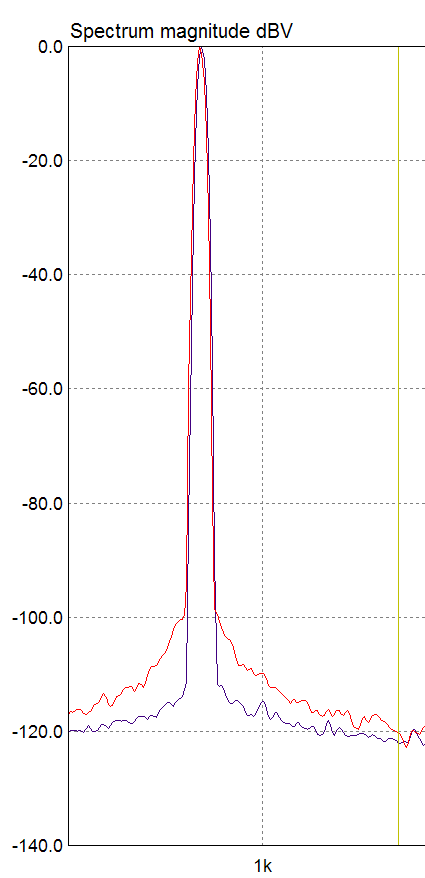

It would be easier to judge the plots with a linear frequency scale (and a range of about 500-1500 Hz), but I'd say these two oscillators have low noise.
Looking at the plot of your new design again I think the noise which is visible is not actually from the AGC noise (i.e. true sidebands) but rather just the noise floor from the multiplier, resistors and opamps. 0 dBV is a rather low operating level. But if you just want to do FFT analysis this is less of a problem--for THD+N measurements you'd probably need to increase the operating level.
Something like this?
This is the 'all-multiplier' design @ +10dBV out with a better decoupling of the Q-controlling AD633; now it works at a slightly higher operating level than before, and its output is low-pass filtered too - it seems the filtering is really effective in lowering phase noise, but probably you are right: analog multiplier are a little bit too noisy for this kind of application. I mean continuous coverage, as you pointed out - my earlier design, employing a single multiplier in the rectifying stage and an home-made analog optocoupler as Q controlling element, was by far more simpler and effective, altough its THD was certainly higher. Anyway, the ALC loop was improved too: upon startup it takes less then 5 seconds to get the output signal amplitude to within a fraction of dB of its final value; amplitude stability seems very good.
I've not yet managed to measure the distortion products, but they seem to be in the -130 dBc range or less @ +10dBV out - I'll let you know.
Yes. To make the plot independent of FFT resolution and window we'd actually need to plot in dBc/Hz (or dBc/sqrt(Hz)), but most standard FFT packages don't support this.
For comparison here the performance of my oscillator: sideband_noise.pdf
This was done using a special Equiripple window and a 32k FFT. Performance is actually dominated by mains interference in the level detector (hence 50 Hz sidebands). Once proper screening/casing is applied noise should drop considerably.
