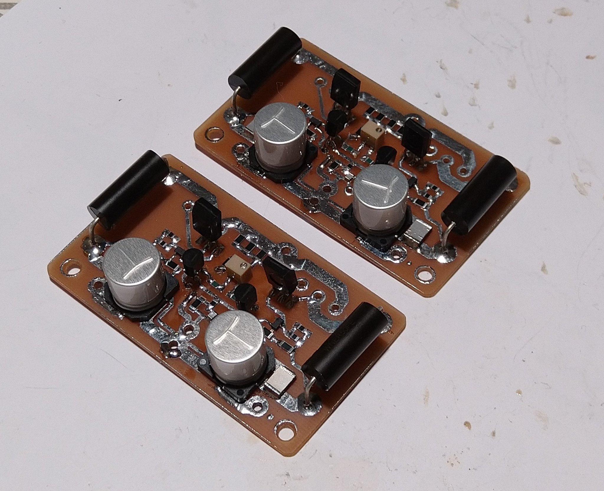

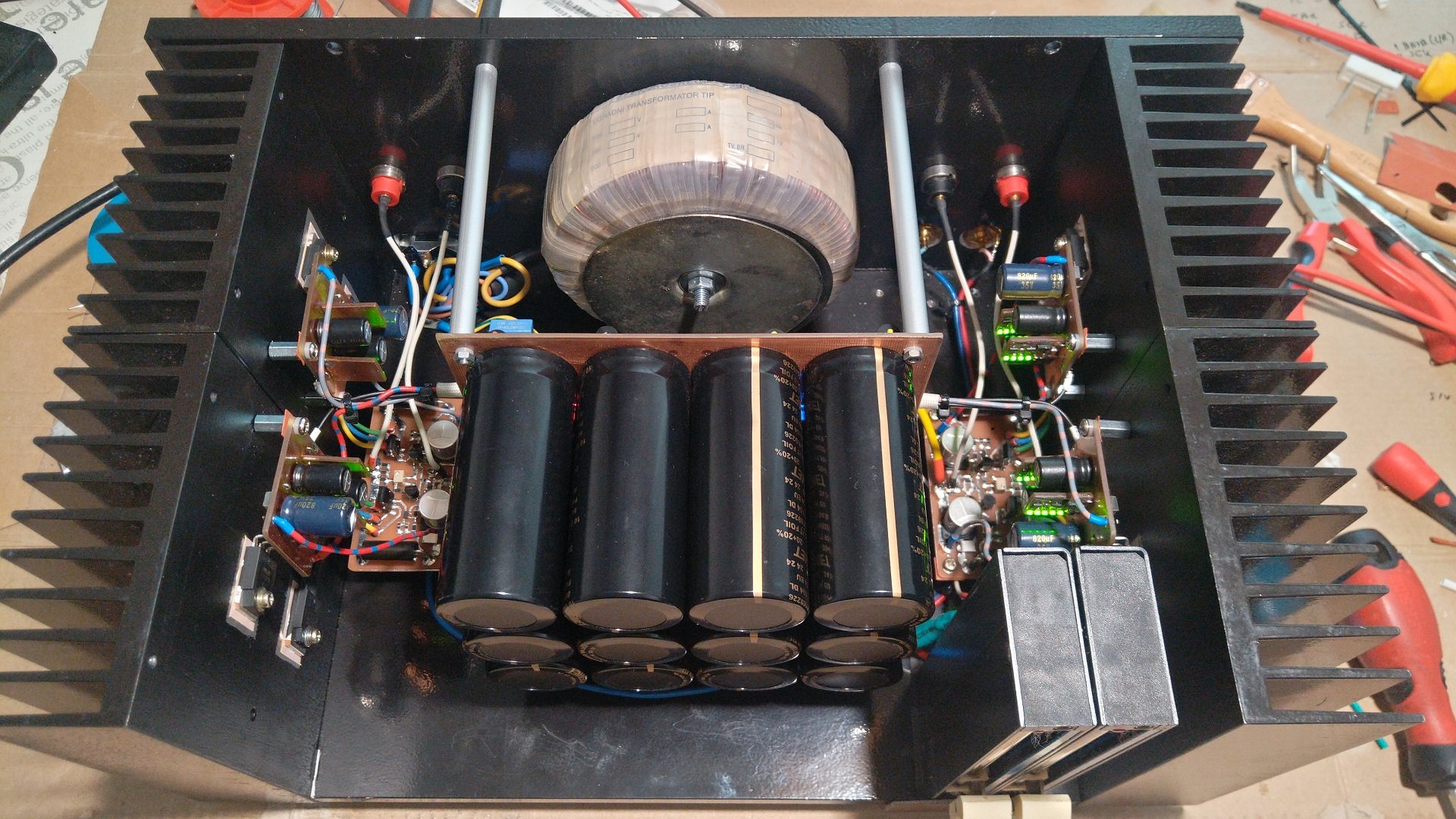

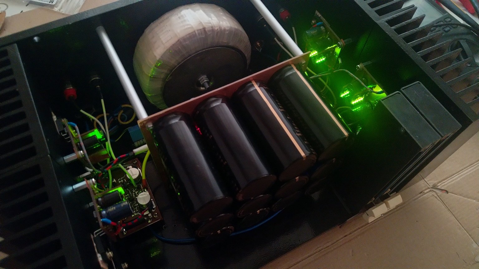

Hi

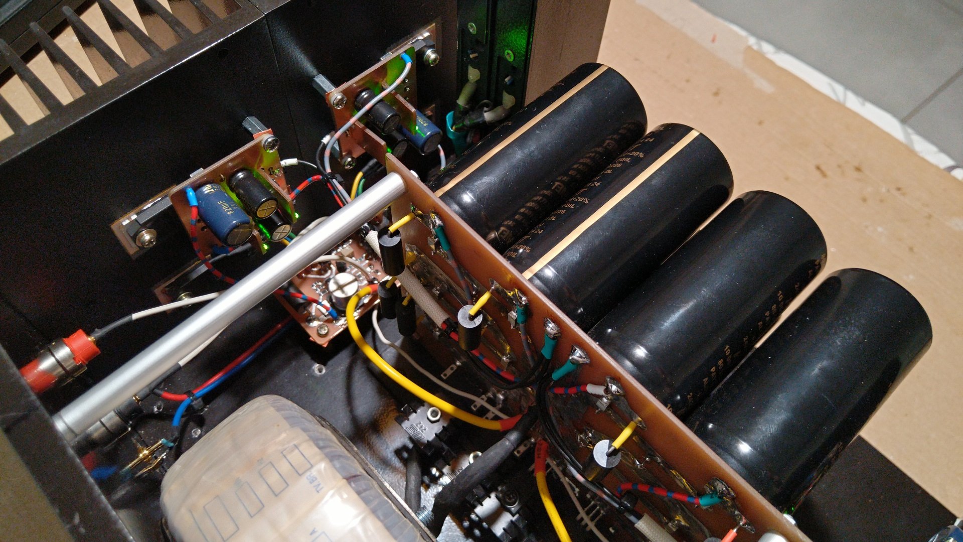

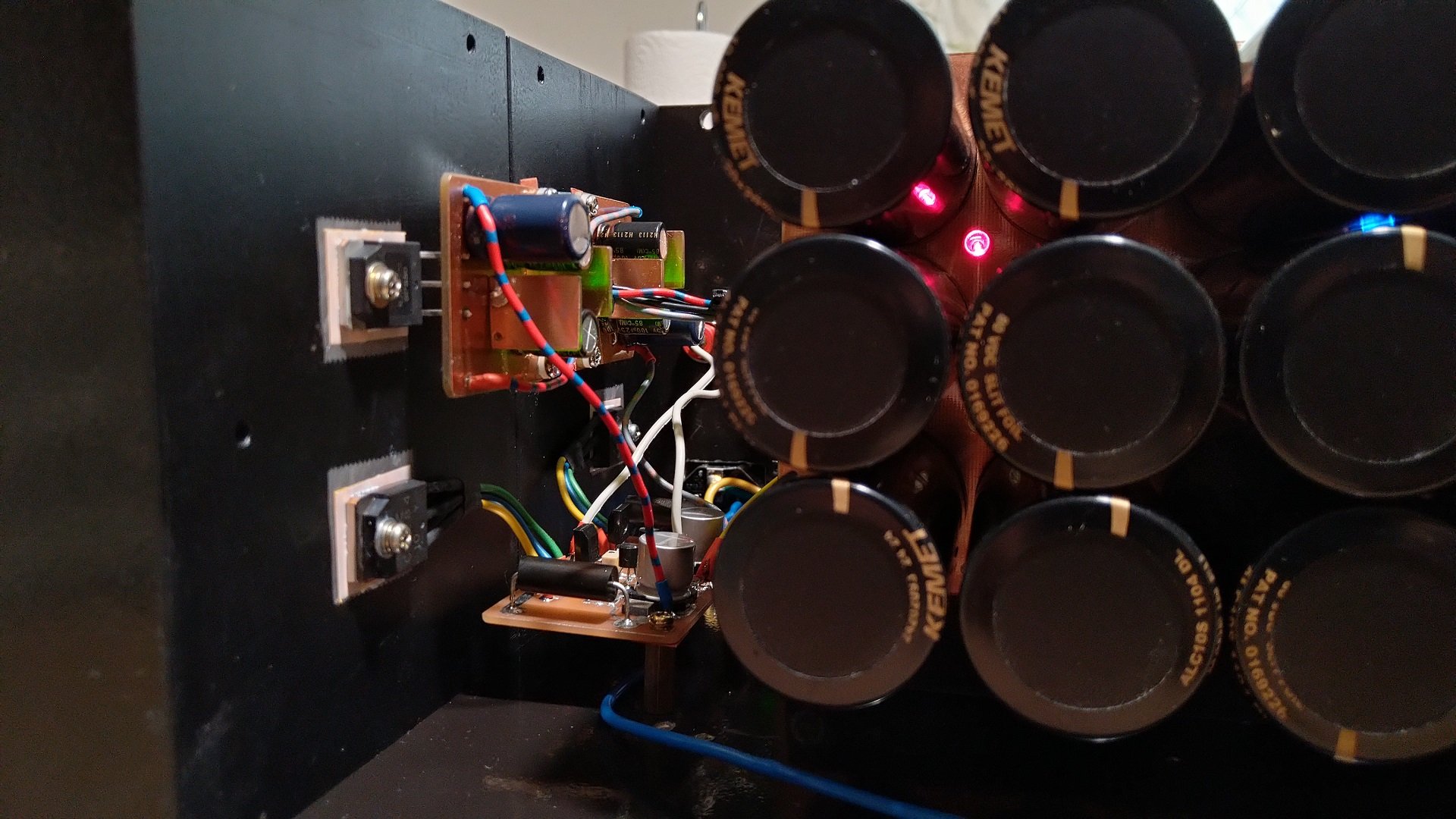

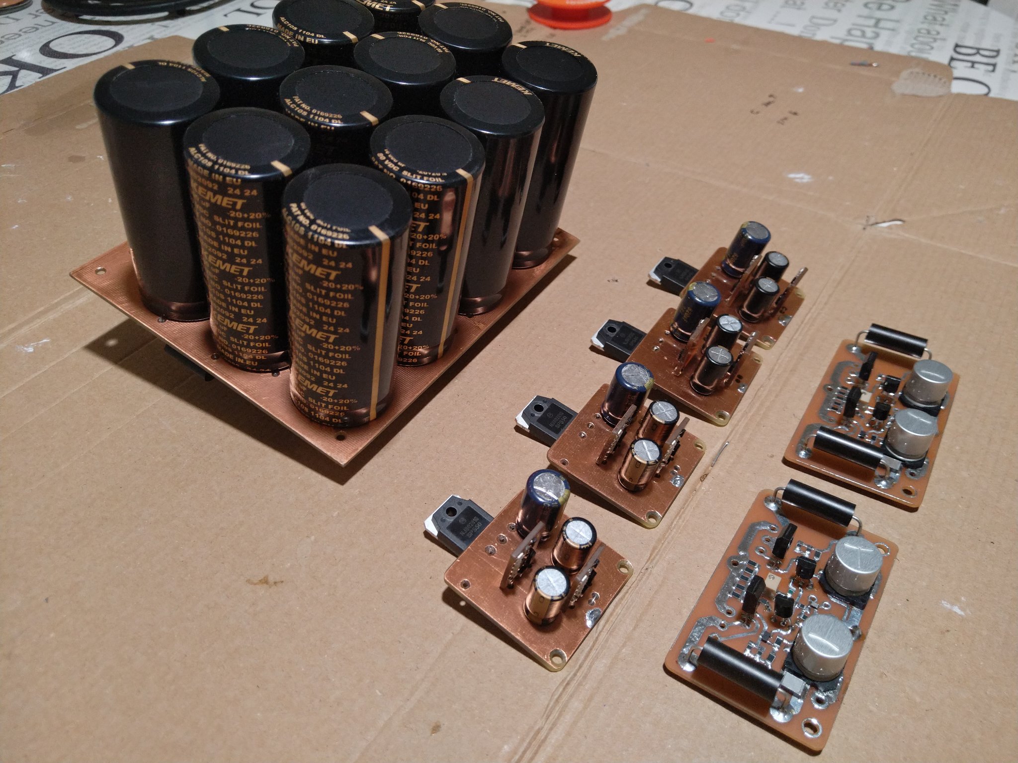

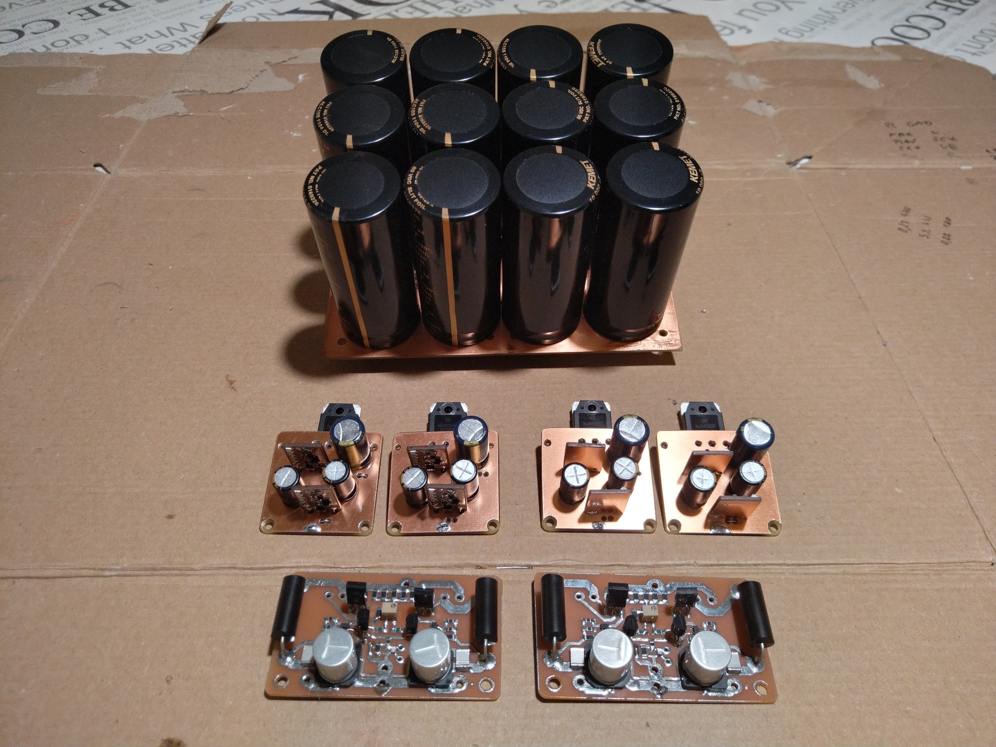

Some time ago I started thinking about improving my Le monstre. At the same time I was convinced of the superiority of SMD tantalum resistors in audio and I decided to make a complete tantalum version including my regulators which are essentially improved Walt Jung superregulators.
Due to obligations at work, I'm quite late with the plan, so for now I've made new PCBs for the amplifier and the rectifier itself, the regulator PCBs have been made but the regulators haven't been finished or tested yet (except for the positive one). I also have to make some modifications in the box itself due to the different placement of the transformer.
So far, there is still a lot of work to do. To begin with, here are some pictures of how it looks for now.

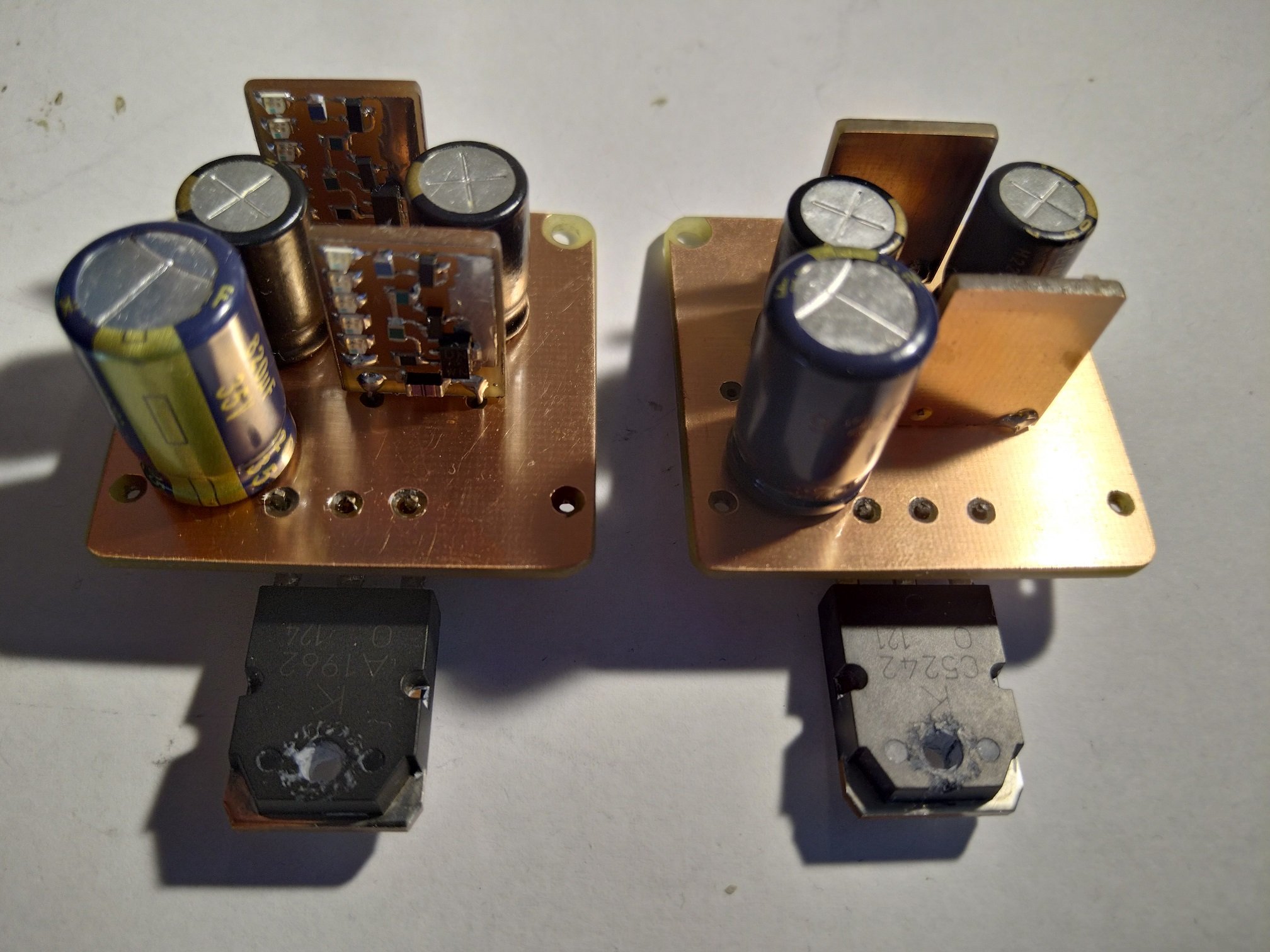

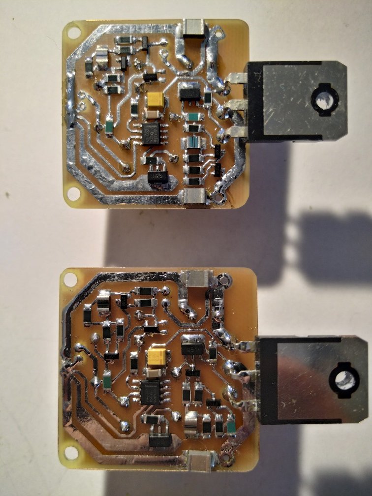

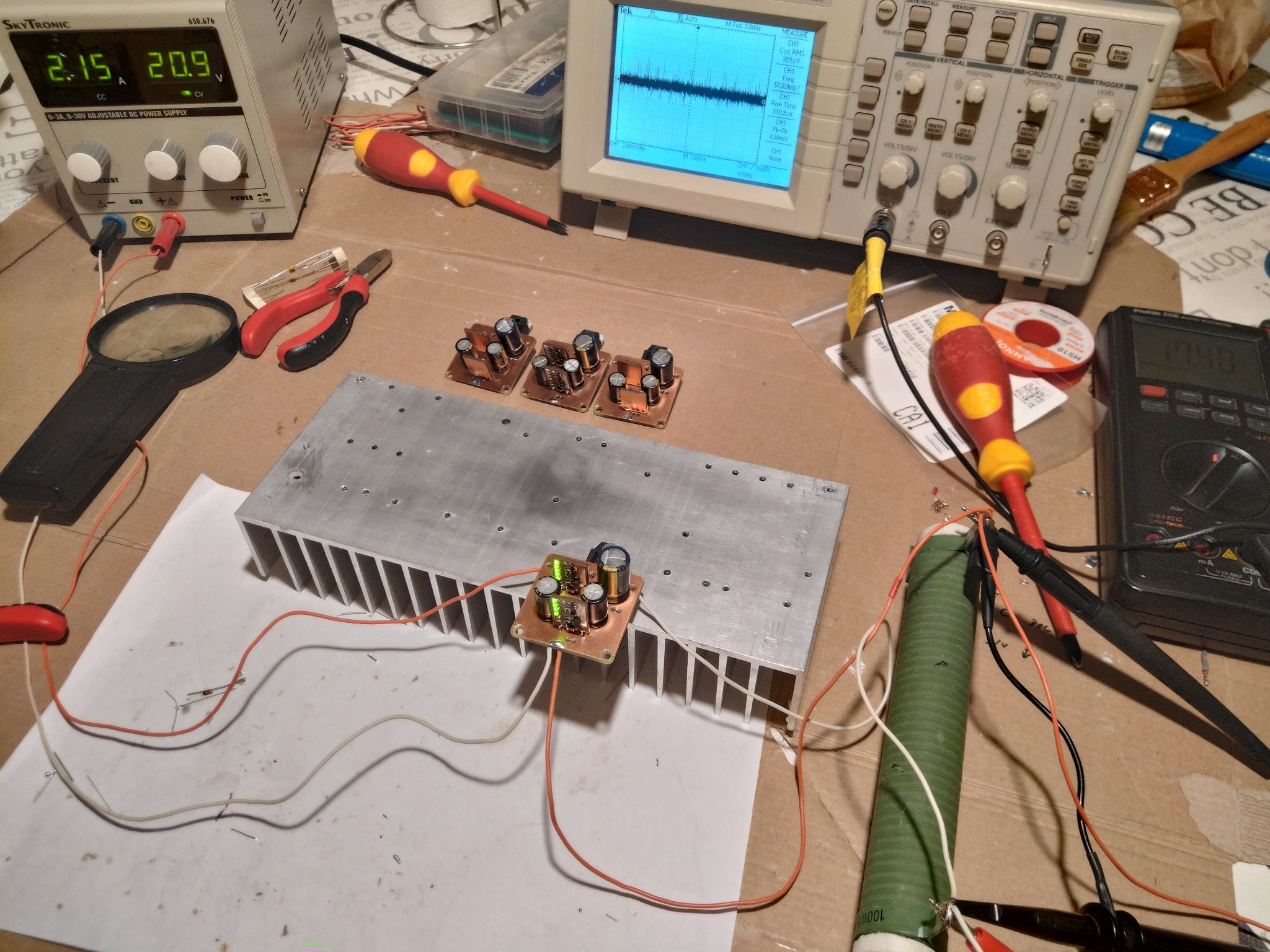

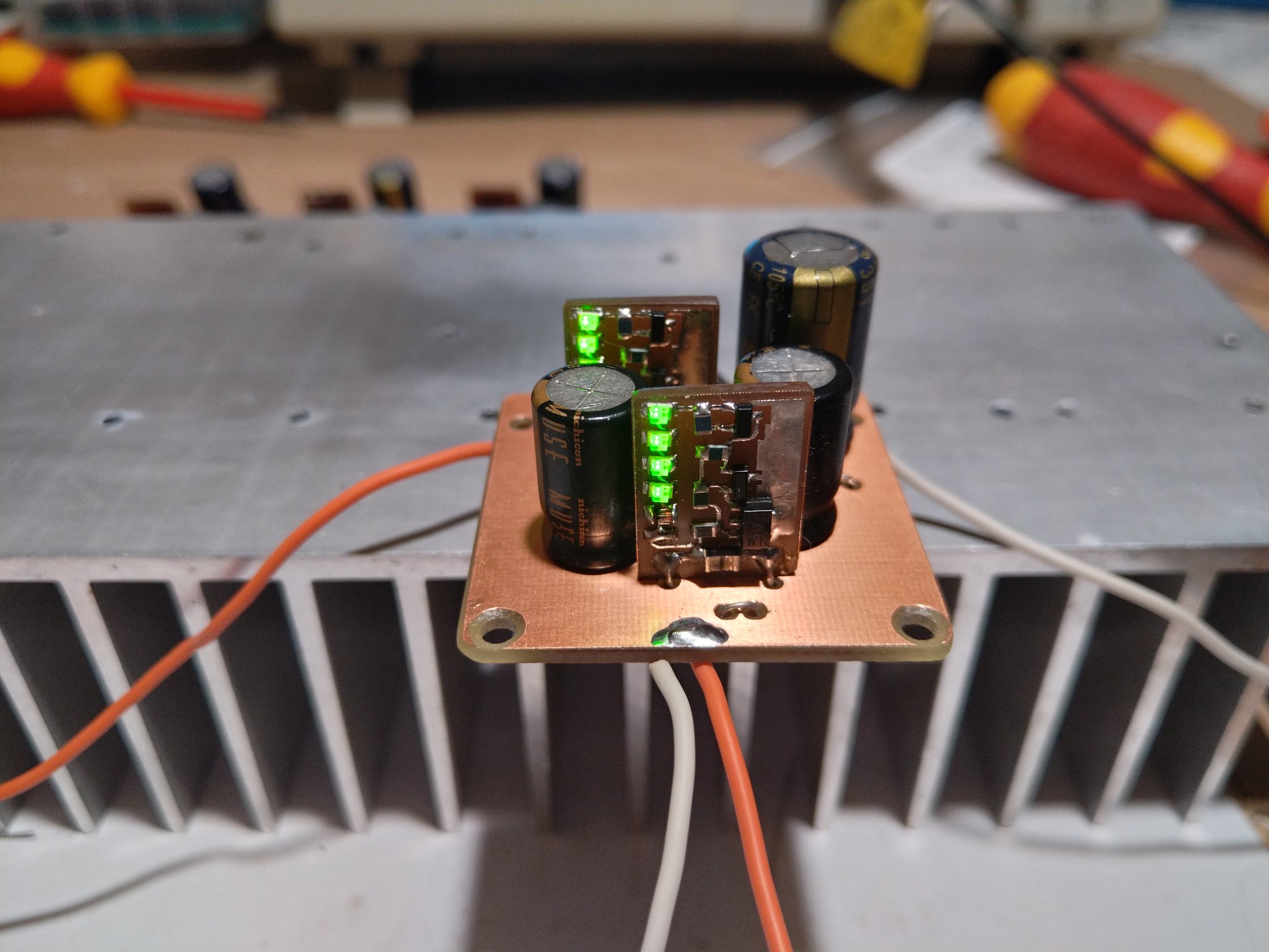

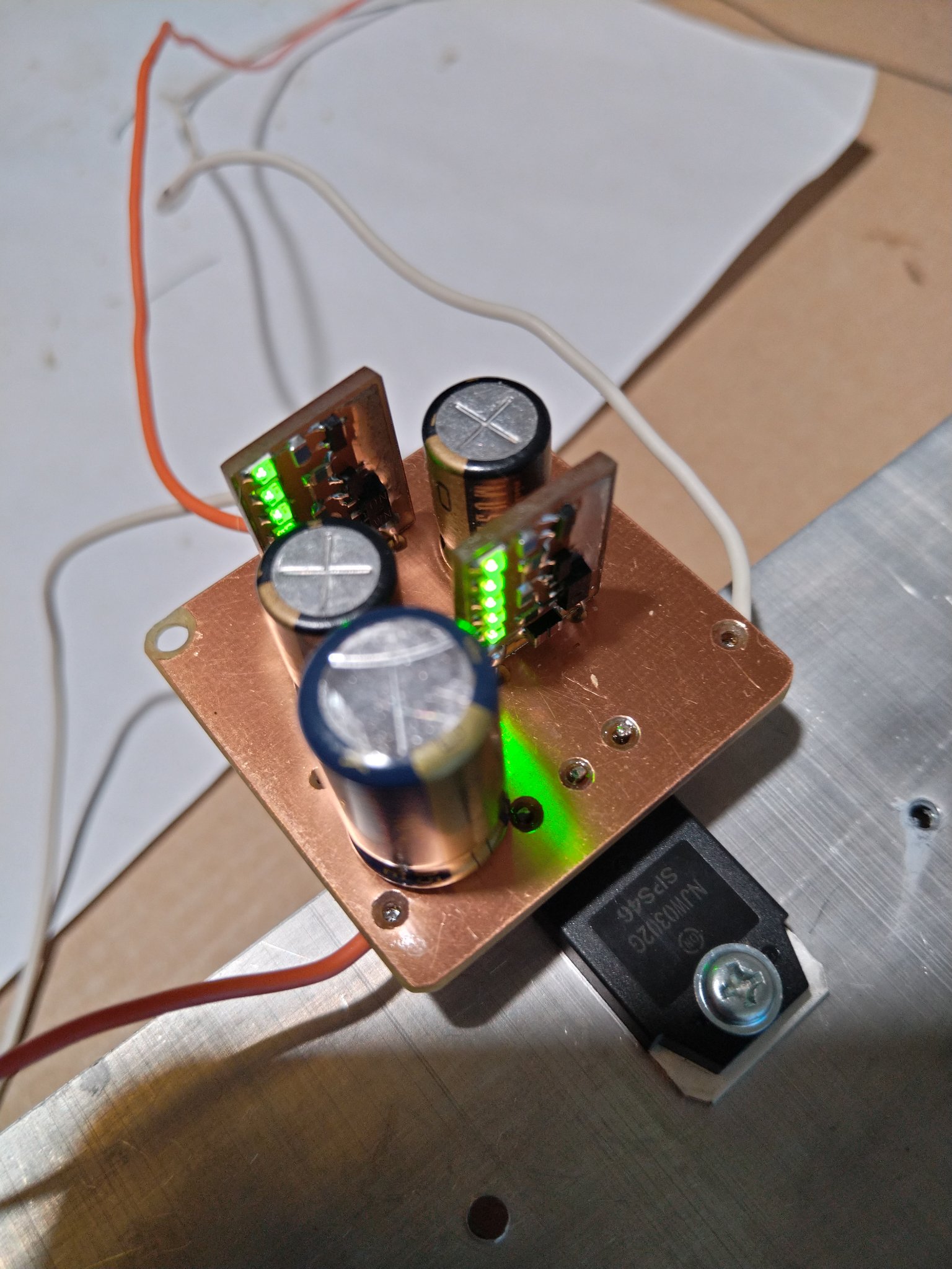

Here's some news, last week I managed to put together the first negative regulator. I did some quick tests just to make sure it wasn't oscillating or having any other problems and so far everything seems fine. This week I'll test it with a load and then I'll start finishing the remaining positive and negative regulators.

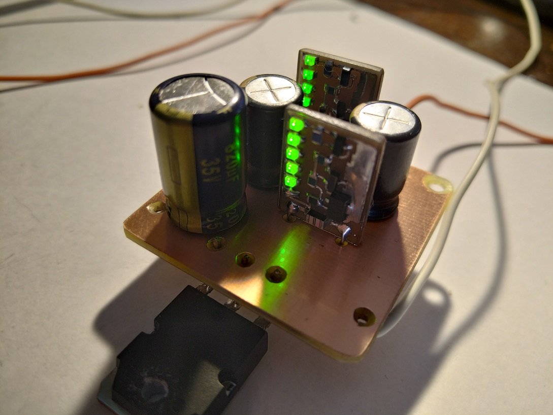

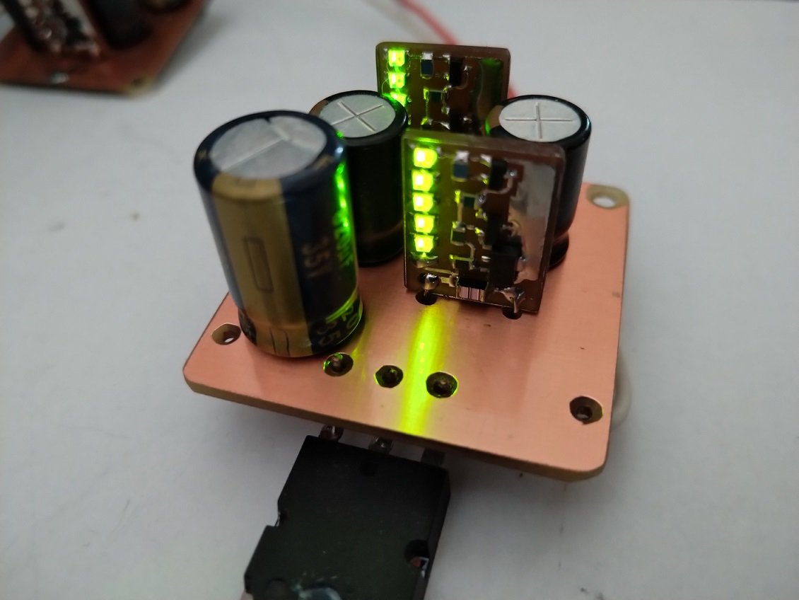

The picture shows the regulators for one channel, positive and negative, the only TH components are three electrolytes, two 100uF/25V UKZ at the input of the op amp and one 820uF/35V FK for decoupling . Small PCBs with green leds are low-noise references from Walt Jung. All resistors are tantalum SMD as in the amplifiers, and each regulator has 4 depletion mosfets, 9 bipolar transistors and an op amp, which in this case is an OPA828.

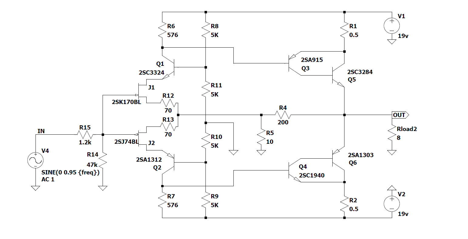

@Nikos I did the same as Hiraga, listened and compared between several types, the choice fell on these in the end.
I did not add the bypass resistor for 2SK170BL/2SJ74BL for lower idss because the resistors in the output are reduced to 0.5ohm so that in LTspice there is a very small difference and only at higher power.
This is the schematic according to which the new PCBs were made, after testing there will certainly be some corrections to the resistor values. The current through the outputs should be between 1.6 - 2A , I will decide on this during testing.
