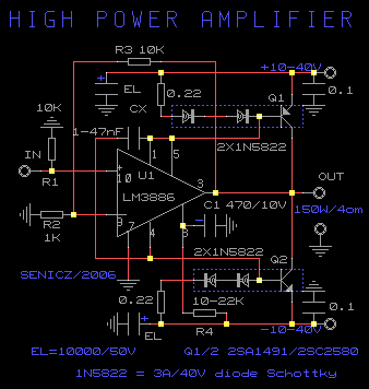

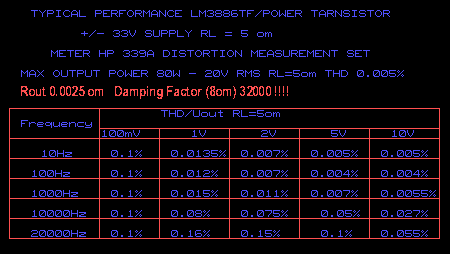

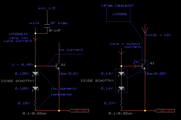

My high power LM3886TF
Best sound, best power, super low price.

What is the reason to do this ? You won't be able to use > +-40V rails anyway.Using two LMs in parralel would give better reliability / easier to build.
Also i think that 2SA1491 have too low power dissipation for reliable operation.

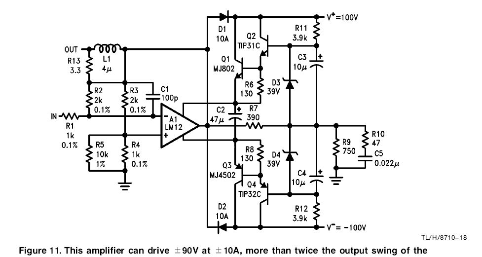

tracking power supplies
This is right from the national lm12 app notes,The zeners set up a regulated power supply to the lm12 as the audio increases the series pass transistors increase the voltage to to lm12,there is always no more then 39 volts between what the lm12 is putting out and the power supply rails feeding it ,its a tracking power supply,I have not tried it yet but I wonder if it would work with lm3875 or lm3886.As an example if the lm12 was putting out + 30 volt peak the + supply would increase to approx 69 volts and the negitive supply would decrease to about -9 keeping the lm12 within soa
Re: tracking power supplies
thanks I will look at the APP notes.
