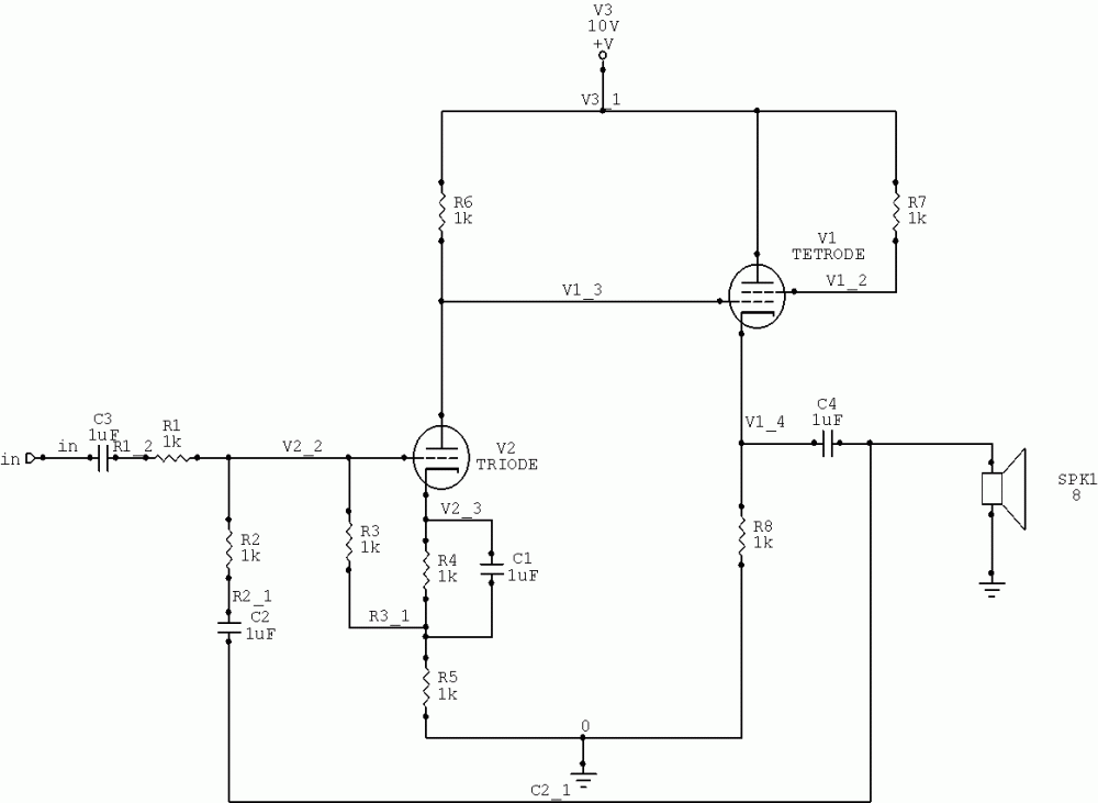

Here ya go mod_evil. Feedback should be routed to the grid of the triode. Please ignore the values of components as your shema didnt have any I left them at default. Feedback becomes the ratio of R1 to R2. The input impendance also basically becomes the value of R1 so make sure it is high enough for your source to drive.

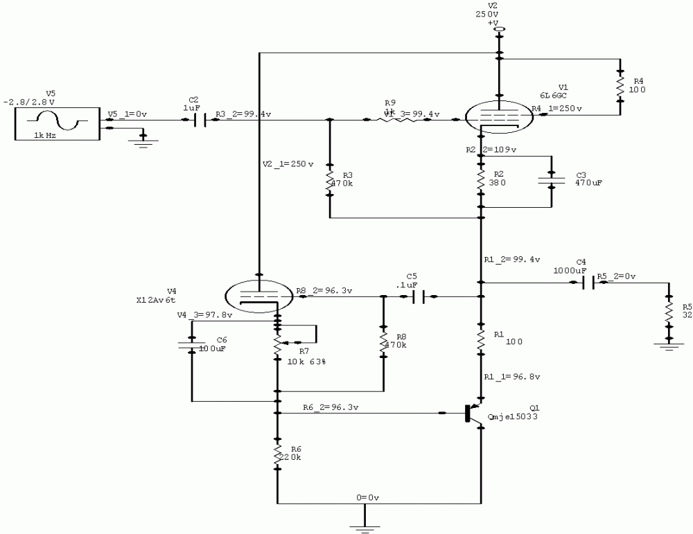

You may want to try the circuit shown below. I have not actually built it yet, only simulated in SPICE, but it should work. The simulation indicates that for an input of 1 volt peak, .7RMS, the headphones will see 200mV peak, or .6mW, at about 0.5% distortion. 0.6mW doesnt sound like much, but according to the specs I have, 32 ohm Sennheiser headphones for example have a sensitivity of 94dB per 1mW. So .6mW will give you 91.8mW, which is plenty loud enough for me, although some people may want more.
I could not come up with a direct coupled version, hence the inclusion of C1. Also C4 is necessary to keep the gain up.
SPICE is not reality, but this is a starting point for you. If I can find some PCL/ECL82 in my stash I will build one.

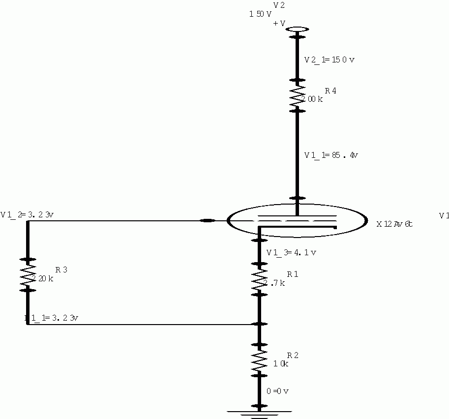

Overloading the grid can be avoided by bootstrapping the grid resistor. In the example I show here you can see that I have the bottom of the grid resistor R3 connected between R1 and R2 where feedback would be applied if using cathode feedback scheme. Choose the value of R3 so that the cathode current will drop a dc value about twice the expected input ac rms voltage. I use this method for a 12av6 based hybrid. The bias voltage for the tube is only about .8 volts in my circuit yet I can input nearly 2 volts ac rms with no issue. This doesnt effect cathode feedback either, just have to choose your voltage divider based on the value of R3 for the ratio you want. Bootstrapping the grid resistor in a circuit which the feedback is applied to the grid is almost mandatory so as to make the grid resistor appear to be an extremly high value to ac, and reducing its influence on the feedback voltage divider.
Sorry the picture looks so screwy my graphics program didnt seem to like it.

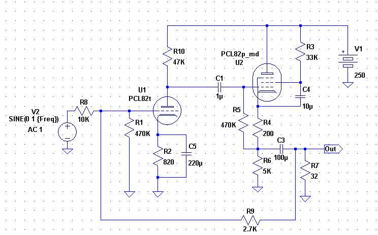

After much thought (I'll save you the boring details) I figured using a high gain triode with very heavy feedback is a bit redundant and most likely wont sound very good. So take the triode out and just use the pentode as a buffer. But having that perfectly good triode there unused bugged me. It's bed time for me so I'll give more details later. Here's what I came up with.
