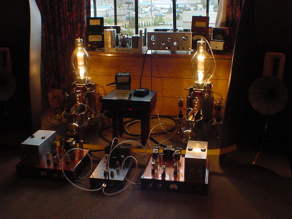

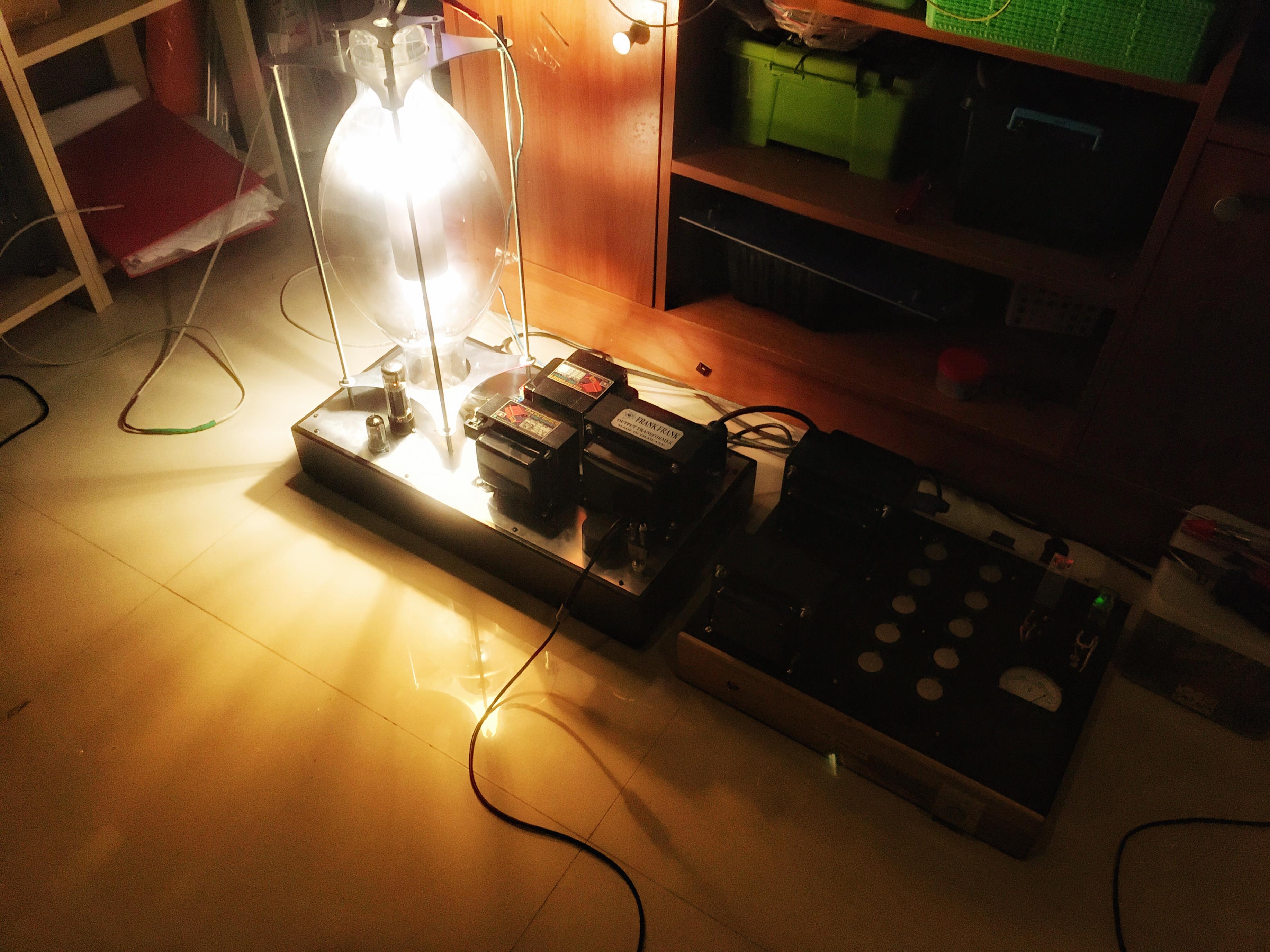

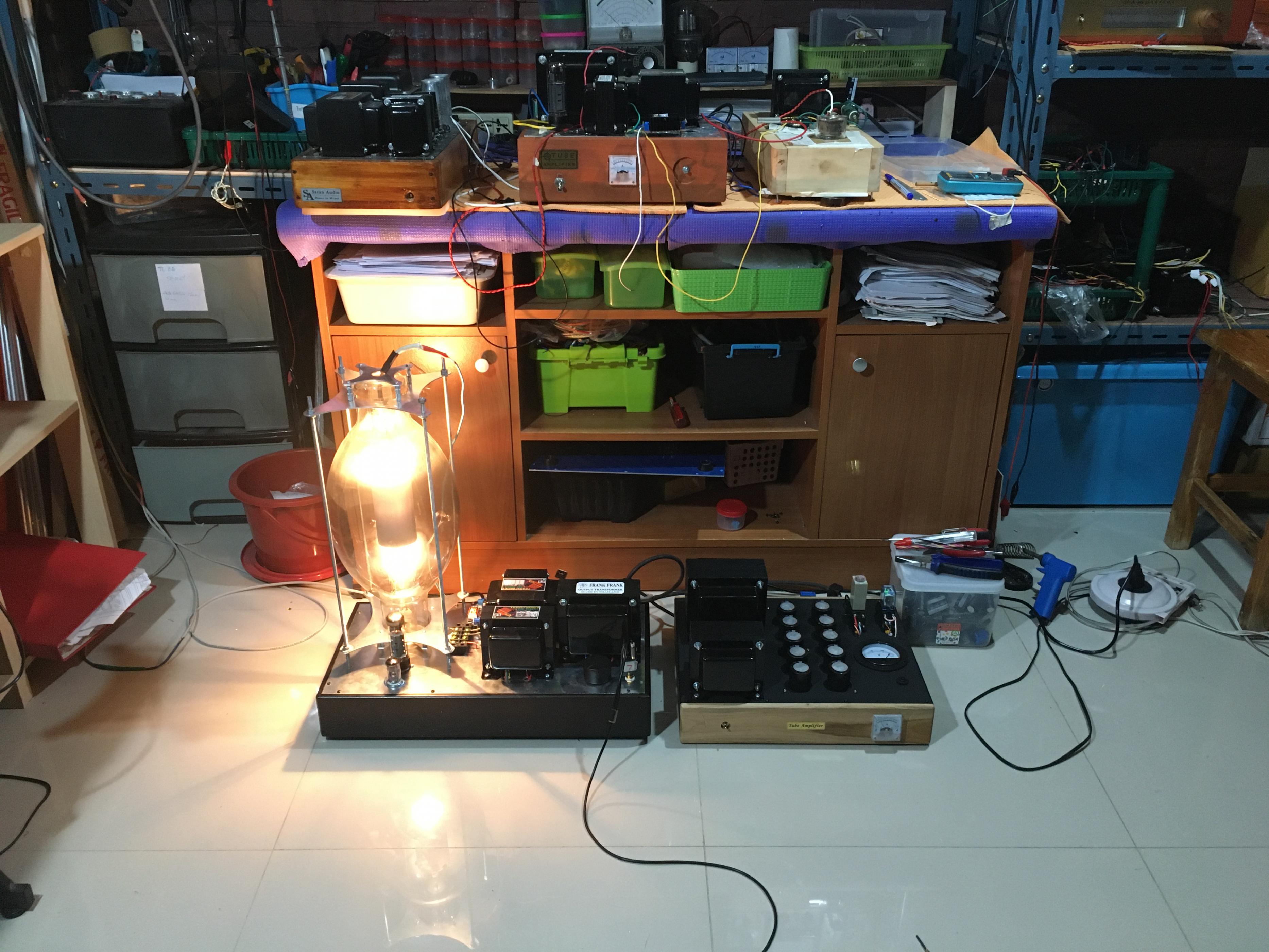

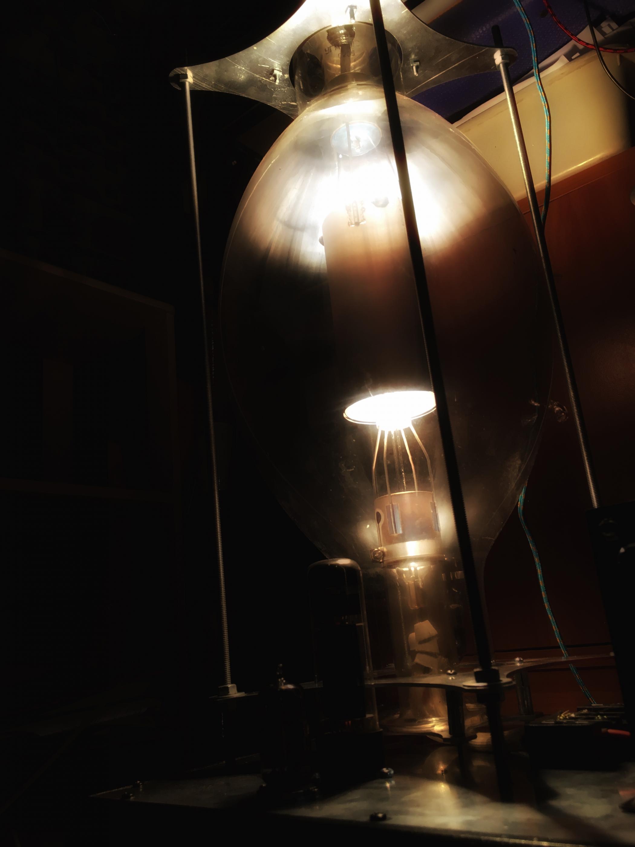

My Gm100 se mono block

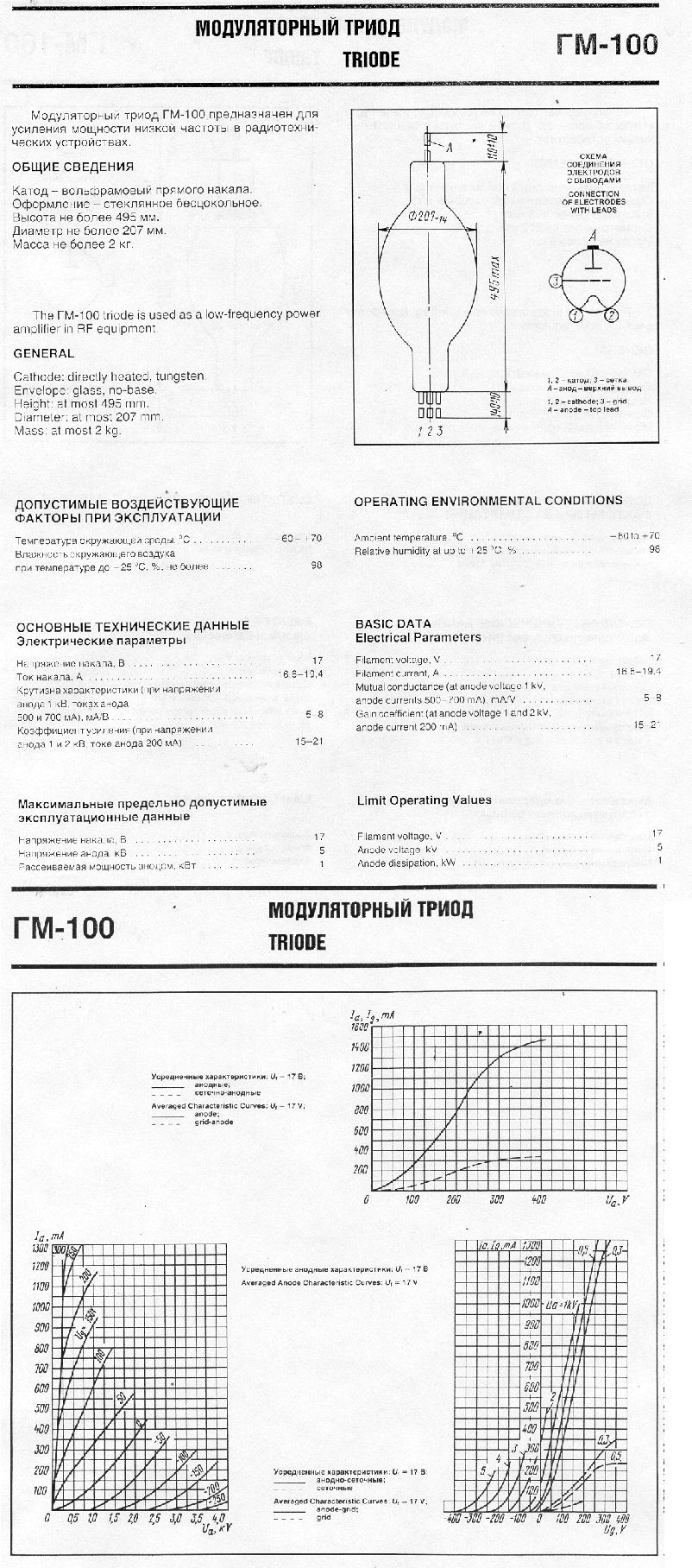

Could you please tell, what is the turns ratio of the output transformer for GM100 ?

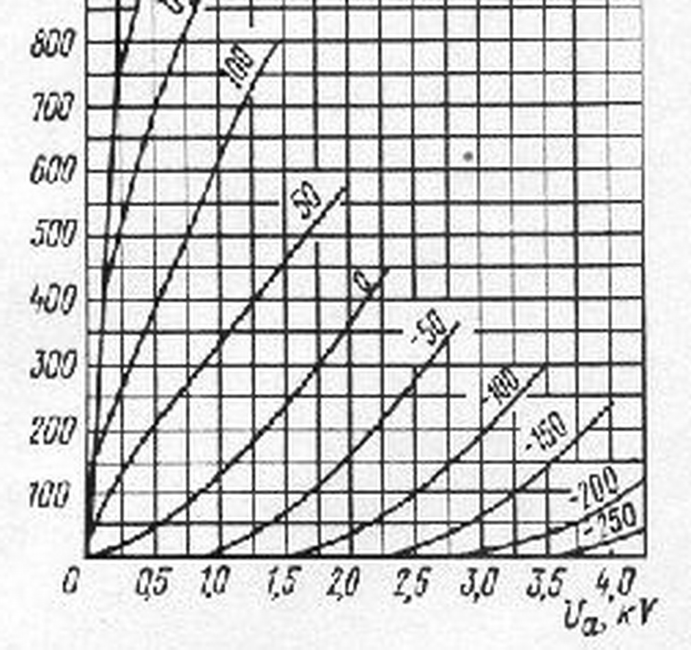

What is plate voltage and grid-cathode voltage? This tube is similar in application to 833 tube, but even a bit more user friendly (allows more negative grid voltage that 833 at the same plate current). Internal plate resistance is around 3...4 kOhm. It has nice cylinder-like grid and plate geometry.

I’m used ac for heating the filament. The filament transformer can supply 20 amp. Symmetry winding made the equal for each side and centertab can use as chathode and reduced the humm
El34 swing plate 70 vpk can drive the big one
Regard
This is a Gm100 Se Running in class A2.
I guess you operation mode could be similar to values (zero grid bias voltage) from this russian diy person (Mr Rezvoy)
Ua=1500V, Ia=260mA, Ra=7,8k (Ra=2Ri), Ug=0V, Uin peak=60В, Ig peak=100мА, Рout=50Вт
Such a trick with A2 operation with Ug=0V is good applicable for 833 also.
However, I personally do not accept pure A2 operation. I would prefer -40-50V grid bias.
In my 833 monoblocks design I use -30V grid bias, 1970V plate voltage, 160mA plate current. A2 is coming only at very high output power.

Do you have a separate fillament transformer? if So i would put a NTC in series or a turn on delay to limit thermal shock in the fillaments
