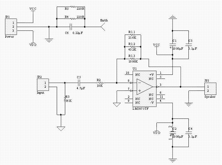

My Gainclone PCB - Problems?

For now though, improving on this gainclone PCB, some DIY speakers to suit and a pre-amp 😀
