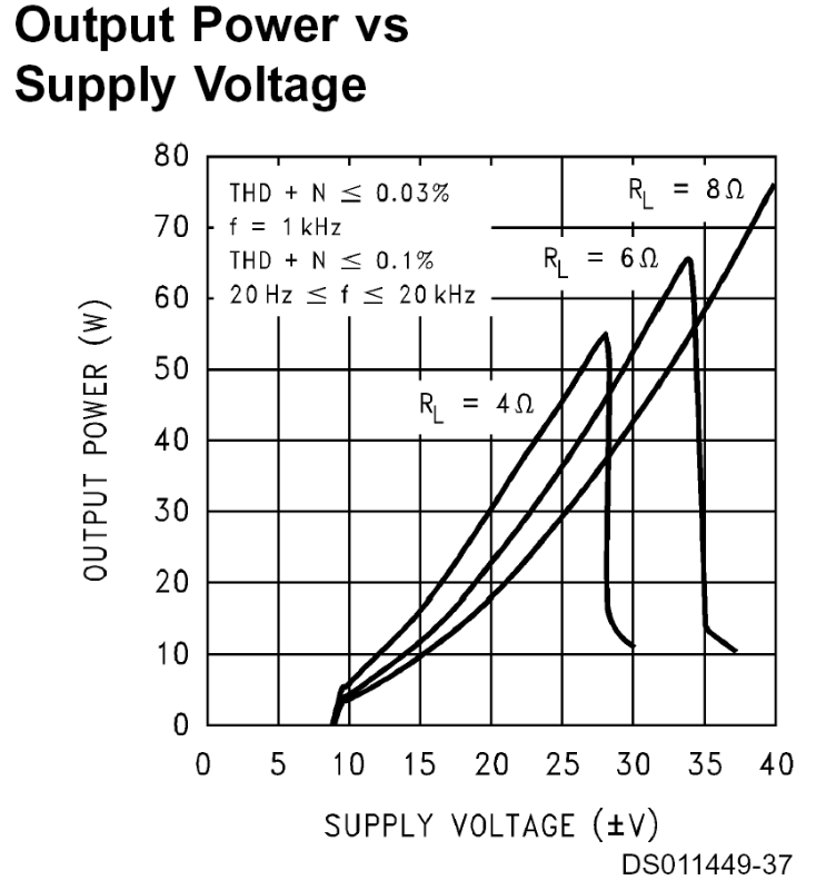

cowanrg said:18W seems a little bit underpowered though 🙁
i thought the chip was rated at 56W?
It is...
But, if you want a cooler amp, you use lower rails, and therefore get less power.. 🙂
cowanrg said:but if i could just cool it, i could get MORE out of it right?
