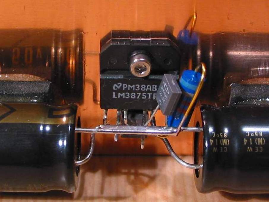

Hi Bartek,
Looks ruely impressive. Simple but elegant.
Beginner question to you: I see 4 resistors in 3875 kit-guide on chipamp.com. But I can see onl 3 in your circuit. Is one of them hidden somewhere? If not, what is your layout? Thanks,
Murat
Halo and many thanks for good words.
This is strictly Peter Daniel"s circuit with 22K Caddock input shunt ,680R Riken and 22K Caddock feedback resistor that is hidden underneath the chip and is soldered stright to the chip pins.In some versions there was also series input resistor but it is not actually needed, at least in my (and not only mine ) expirence.
Bartek
Hi Bartek,
your amp looks fantastic - I personally like the p2p inside. I love copper, should give myself a push an start working with it for another amp...
BTW: Did you check up my p2p (a little hidden by all those cables though...) on my last documented chipamp? I did use those subminiature carbon resistors, they are a bit smaller than Caddocks and Rikens (like in my last, PD "reference chipamp").
