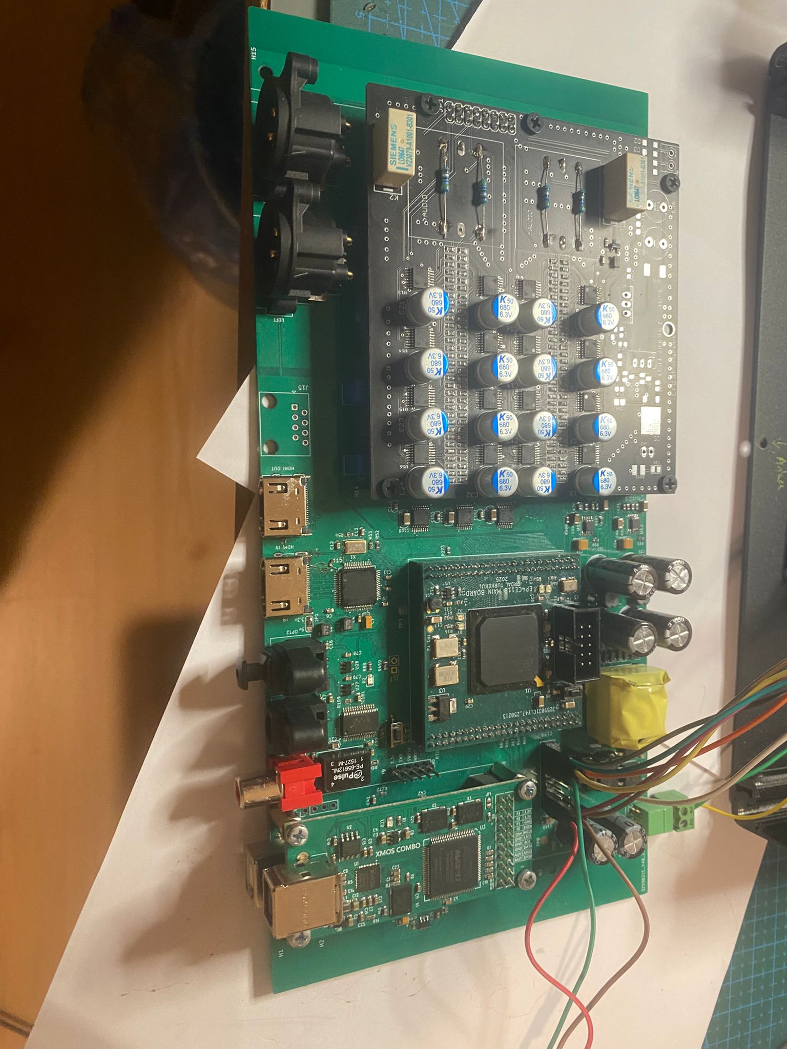

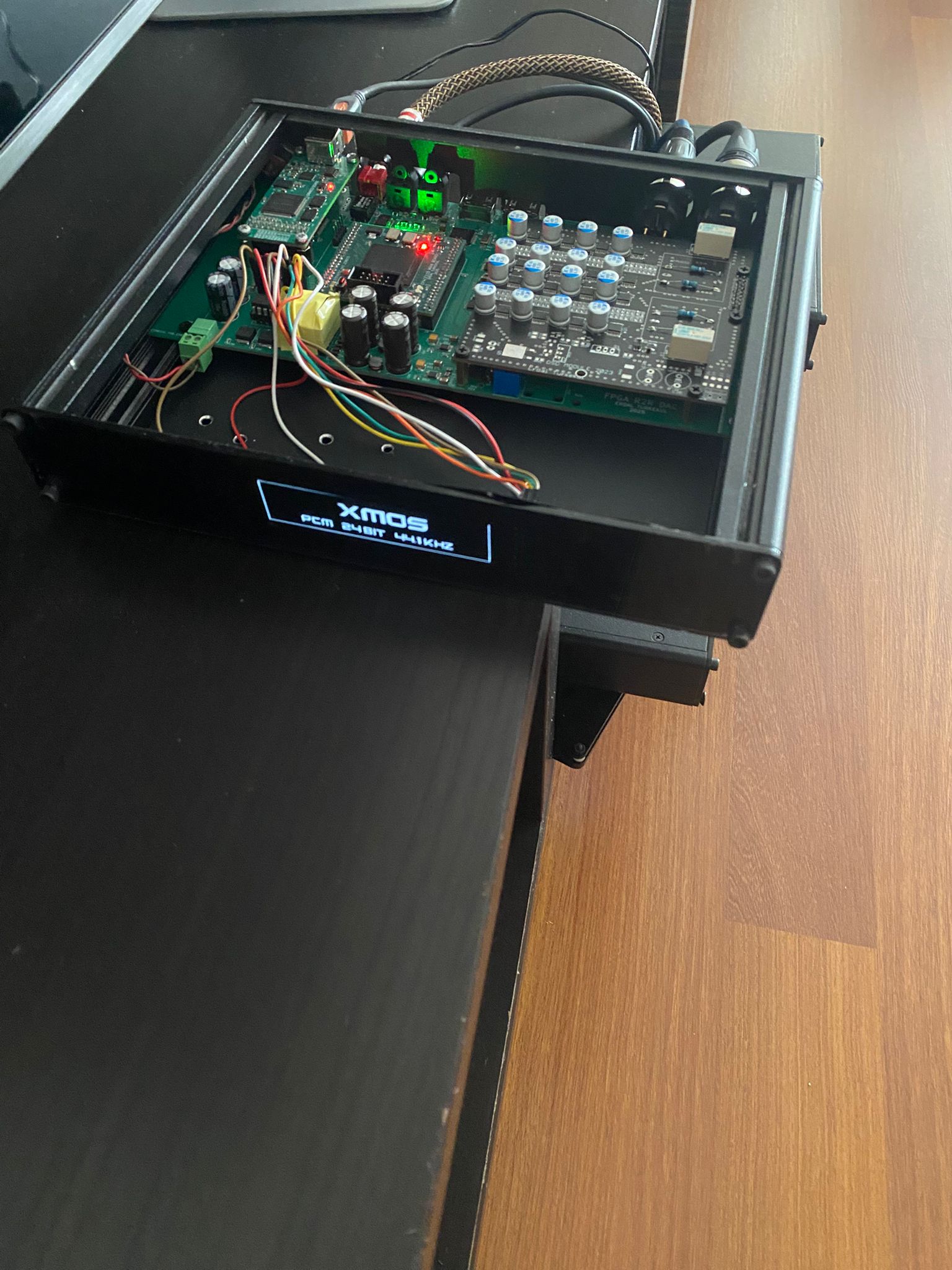

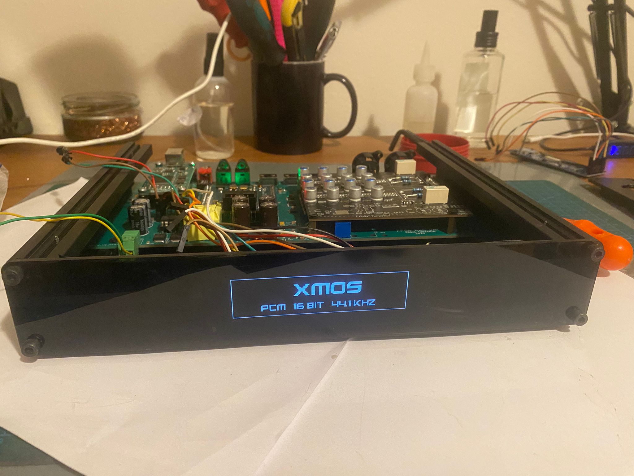

I'd like to share my latest project — a fully custom digital audio processing platform built around an FPGA. The system accepts multiple digital audio inputs (I2S/SPDIF), applies jitter reduction and fixed-point filtering, and outputs a balanced signal through a discrete R-2R DAC.
The goal was to achieve low-jitter, low-distortion output using hardware-domain techniques, while maintaining maximum flexibility in digital audio processing.

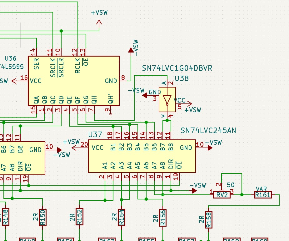

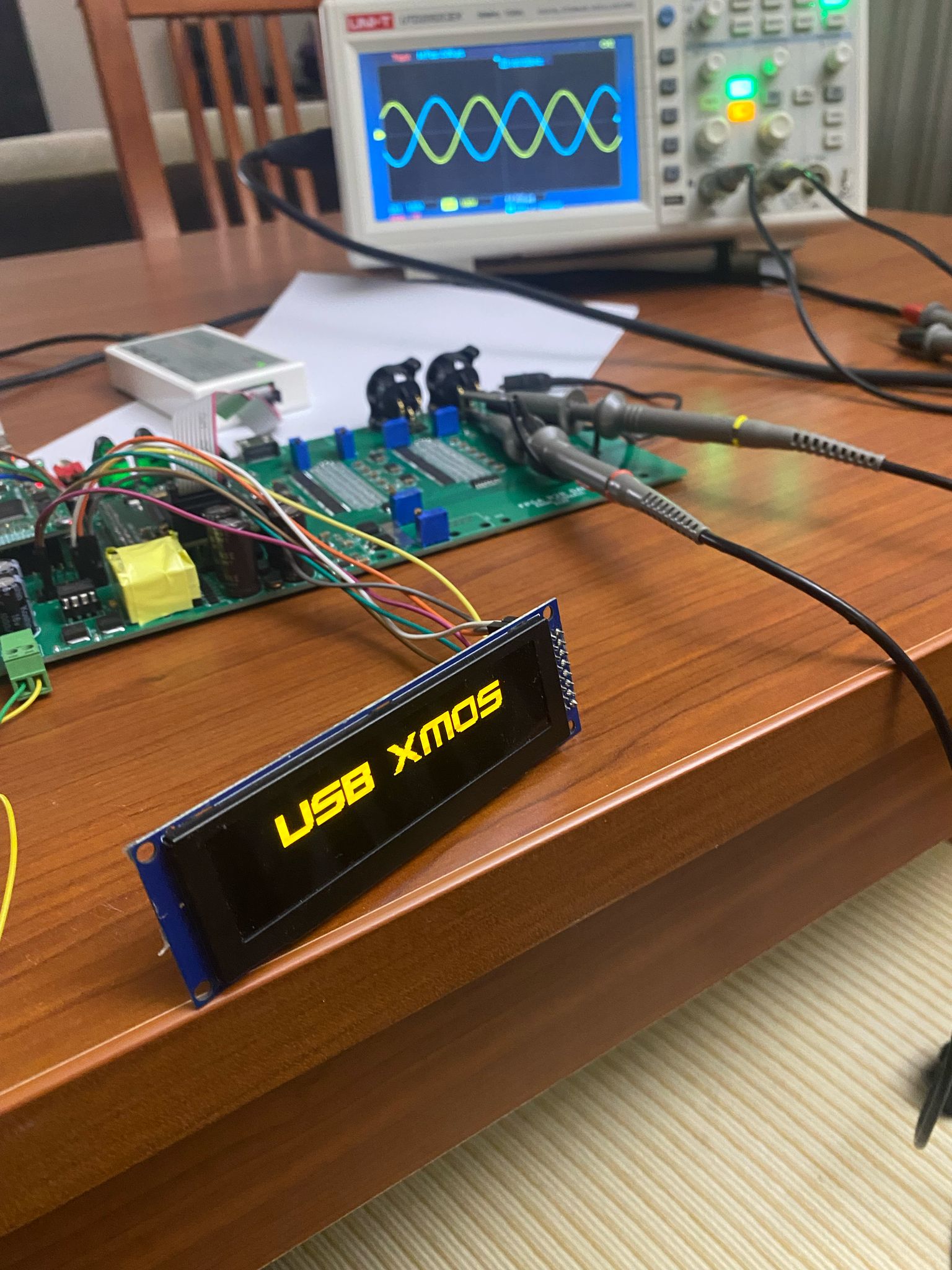

🔧 Hardware Specs:
- FPGA: Altera Cyclone IV EP4CE115
- Inputs: I2S (from XMOS, HDMI, STM32), SPDIF (optical & coax)
- Output: Balanced R-2R DAC (via 74LVC595 shift registers, isolated with SI8660)
- Clocks: External 22.5792 MHz & 24.576 MHz oscillators, dual PLLs with dynamic reconfiguration
🧠 Signal Processing Chain:
- ✅ Sample rate detection: 44.1 kHz to 384 kHz (auto-detect)
- ✅ Bit depth detection: 16-bit / 24-bit
- ✅ I2S Reclocking: FIFO-based low-jitter BCLK generation

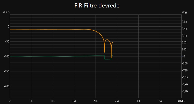

- ✅ Fixed-point FIR Filter: Linear phase, group-delay-aware, designed for steep roll-off and minimal ripple
- ✅ ASRC (Asynchronous Sample Rate Converter): Linear interpolation based, upsampling to fixed 192 kHz / 24-bit output
🔊 Analog Output Path:
- DAC type: Discrete R-2R, balanced
- Output filter: Passive RC (887 Ω + 3.3 nF → fc ≈ 54 kHz), optimized via REW tests
- Preamp: OPA627, gain x2, input RC filter (1k + 470 pF)

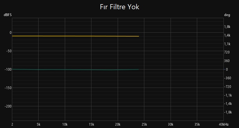

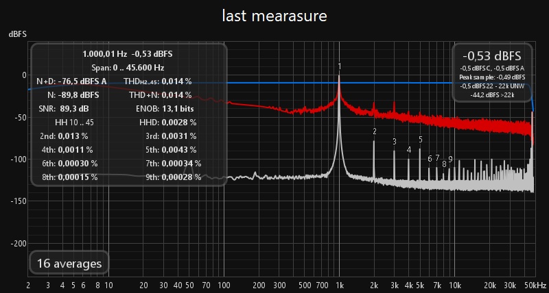

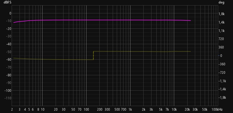

🧪 Measurement Results (REW):
- SNR: 81 dB
- ENOB: 12.6–12.8 bits
- THD+N: ~0.018% @ 1 kHz, -1 dBFS
- Tested Scenarios:
- FIR only
- Reclock only
- FIR + Reclock
- Raw (flat path)
- Interesting Findings:
- THD increases at 44.1 kHz compared to 192 kHz due to increased jitter sensitivity
- RCA measurements underreport performance due to lack of CMRR; balanced output performs better
🚧 Current & Future Work:
- ASRC output working on (fixed 192 kHz)
- Next step: porting design to Xilinx Artix-7 (100T)
- Native DSD passthrough & PCM-to-DSD conversion under development
- DSD dac by upper PCB
🎶 Subjectively, the system sounds clean, fast, and airy — with a notably improved low-end and clarity after FIR+ASRC stages. THD harmonics are drastically reduced when reclocking and passive output filters are tuned properly.
📎 I'm later to share code, VHDL modules, schematics, and REW test plots if anyone’s interested. Feedback, suggestions, and collaboration are very welcome!
Best regards,
Erdal
Hi Erdal,
May I ask for more clarification on what your overall goal for this project is?
You did say low jitter, but I don't see clear evidence of very-low jitter circuitry in the pics you have shared? I mean, it looks like you could do a lot more optimization to reduce jitter. And if jitter is semi-low then Vref is the other critical reference signal, so what about that? Getting those two things to a better state, then better isolation of the dac section from the DSP section could probably help a lot with achieving lower distortion and noise.
Of course, the DSP will probably have to get better too. If you might be interested, there is an interesting article in the forum about ASRC design with poly-phase filters by forum member Werewolf. Moreover, some ASRC designs have gone so far as to provide adaptive length FIFO buffering before the ASRC to allow a lower corner frequency for the PPLL (Polyphase PLL).
The other impression is that this is maybe more about just having fun designing something.
Best,
Mark

Hi Mark,
Thank you for your thoughtful response — I really appreciate your observations.
You're right to note that the current photos and measurement results may not fully represent an ultra-low jitter implementation. The core intention behind this project is a mix of two goals:
To explore and develop a full digital audio pipeline in FPGA from the ground up, including:
Sample rate and bit depth detection
FIFO-based reclocking
Fixed-point FIR filtering
Linear interpolation ASRC (development process)
And a discrete, balanced R-2R DAC output stage
To maintain a practical, DIY-friendly approach using widely available parts, while still achieving respectable performance (SNR >80 dB, ENOB >12.5 bits, THD+N ~0.018%).
That said, you're absolutely correct — there's a lot of room for improvement in the analog layout, clocking architecture, and DAC isolation. This is something I'm actively iterating on. For example:

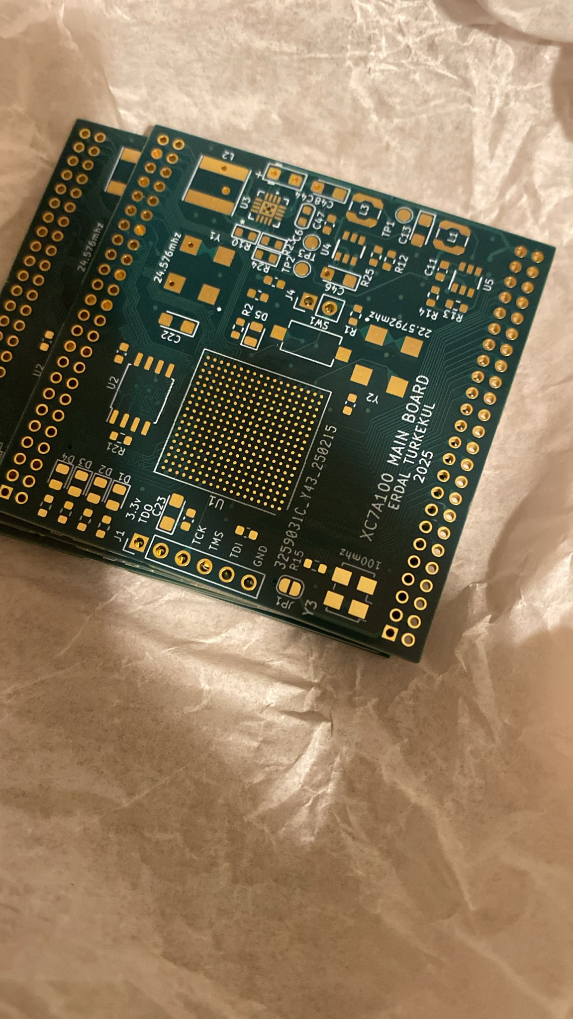

I’ve just received 1 ppm TCXOs (24.576 MHz) to replace the current clock sources and reduce overall PLL phase noise. And I am planning to develop si5340 or crystec femto clock
I'm planning to shift the design to an Artix-7 FPGA, which will allow tighter control of internal clock routing and potentially reduce jitter at the I2S generation stage.
Analog and digital power domains will be separated more rigorously in the next revision (with improved grounding and isolated power for the DAC).
The output stage will eventually include an op-amp buffer with properly designed analog filtering, something currently missing in my discrete R-2R DAC implementation.
For now, the goal is to establish a reliable baseline that can be measured, iterated upon, and eventually enhanced.
And yes — you’re absolutely right again: a big part of this project is just the joy of building, testing, and learning by doing. Having fun with audio DSP on real hardware is half the motivation
Thanks again for the insights, and I’m always open to suggestions if you see areas that can be tuned further!
Best regards,
Erdal

Hi Erdol,
Basically, TCXO is not the most correct clock type for audio. Temperature compensation is not really needed since long term frequency stability is not as important as low close-in phase noise. On that latter point, clocks specified for low jitter at 12kHz offset and above (offset from the "carrier" that is, in this case the carrier refers to the nominal clock frequency), are also not well specified for audio. The lowest cost audio grade clocks are probably the NDK SDA series, although they may be sensitive to air current temperature stability issues. Maybe a little better is Crystek 957 (although they have been found sensitive to bypass capacitor type). Also, IMHO Si clocks are not that ideal for audio. They used to include phase noise plots in the datasheets, but may have found it found it better for sales to hide that information in a hard to find application note document.
Regarding the overall subject of clocking, external clocks, reclocking, squaring of sine wave oscillators, use of ferrite bead power filtering, etc., you might find my clock board thread of some interest: https://www.diyaudio.com/community/threads/general-purpose-dac-clock-board.413001/
Also, there is a simplified and more compact design example at: https://www.diyaudio.com/community/...2soverusb-pcm2dsd-rtz-dac.423401/post-7917601
On the subject of linear interpolation ASRC, it may be necessary to upsample quite a bit before interpolating if distortion is to be kept low. However, that then creates another set of problems to be solved. The article by Werewolf explains quite well: https://www.diyaudio.com/community/threads/asynchronous-sample-rate-conversion.28814/ The author's credentials are available: https://www.diyaudio.com/community/threads/asynchronous-sample-rate-conversion.28814/post-333645
Best Regards,
Mark

First of all congratulations on making a complex project like this work at all! It is no small feat! Now you have a great platform for further experimentation and learning. Looking forward to seeing more of the design.
Br
OJG

Thank you OJG. It is a project that is open to development. FPGA provides flexibility. I also designed the FPGA board as a module. And I also have an artix7 pcb that I haven't soldered up yet.
The hardware and output design on it is more advanced than commercially produced r2r dacs. I used lt3042's in analog supply. I used lvc245 between lvc595's and resistor network and paralleled their outputs. (to reduce the internal resistances of the sink and source)
The analog supply (lvc) is bipolar +- 2.25 volt, so no ofset on output.
As I said above, there are si8660's between the digital (FPGA) and analog sides.
