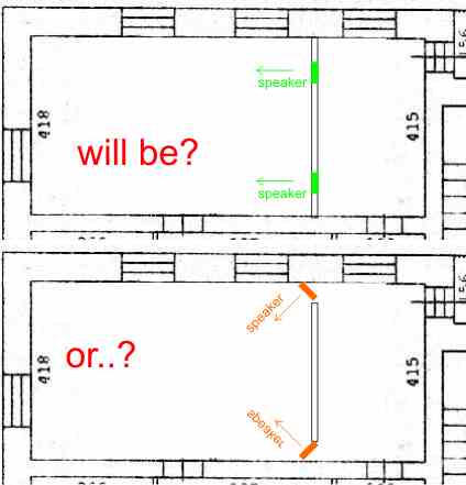

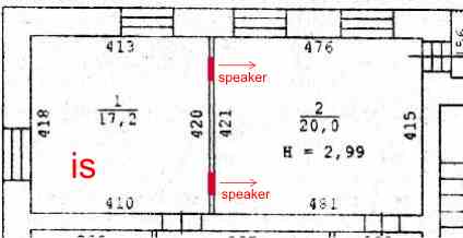

HF - Radian 950pb in ph2380 horns.
LF - 18sound 15nd730 in IB.
X-over and equalisation - DCX2496.
+transport, amplifiers, cables, two holes in the wall, a few pieces of chipboard - it's all for now.
Perhaps, it will be 3- or 4-way sometime later.
Now it works fine enough in this simple form .

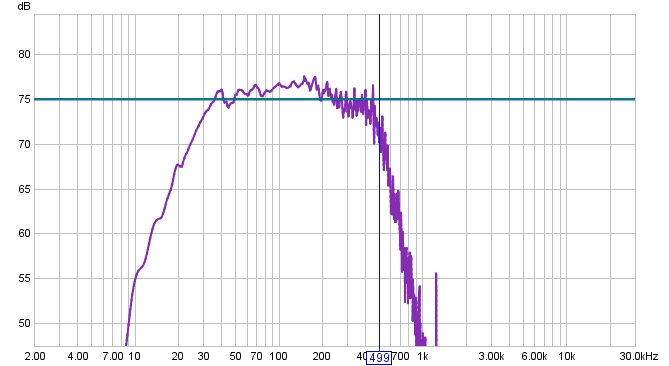

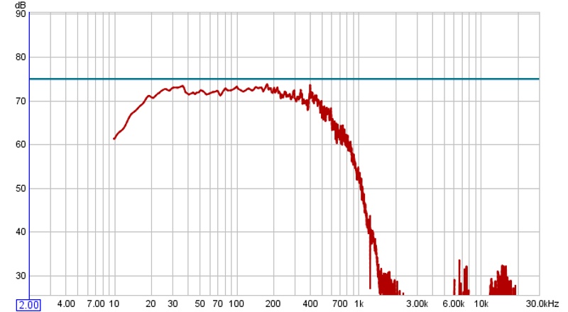

I'll add measurements soon.

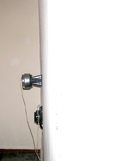

Front view on my avatar, side view in attachment.

I second Cal Weldon.
And also because you use CD-horn they sound the brightest when they are straight pointed at the listener or only with a very small angle.
You could mount the speaker on a verical axes so you can twist it a bit in wall.
Only your closedbox becomes much smaller Flaesh
