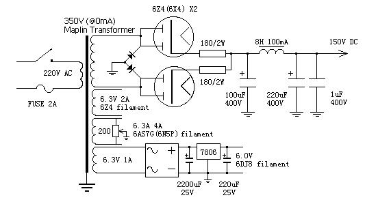

4-Last but not least THE POWER SUPPLY is the point were I am having troubles, as fdegrove suggested I will try to go for the tube rectified one (http://headwize.powerpill.org/projects/showproj.php?file=waarde1_add_prj.htm)
However the only cheap transformer I could find is the following from Maplin
(http://www.maplin.co.uk/products/details.php?CartID=0209170926201443335&moduleno=6472&modulecode=)
I can’t figure out from the data given from maplin if it is suitable: why have a twin 0-115V input voltage? And what do they mean by secondary 350V max??(how can you change the output volatge anyway?)
Also if I have a separate amp and PSU what cable/connectors should I use between the two?

4/The Maplin transfo has spit primaries 115-0-115 to allow use of it in countries with 110/115 V mains.
In your case you HAVE to connect to the points marked 115V,you can use the center tap to connect the mains earth wire (green?).
HT secondary output voltage: 350V AC max.*
* Due to the internal winding impedance, max. voltage and current are not available simultaneously.
I can see why you are confused but depending on the circuit it is used in you can either design for max.current or max.voltage,not both at the same time.
Don't loose sleep over it,Maplin's just playing it safe.
You can change the output voltage in various ways depending on the type of rectification you use.

Yes I am confused about that: What I understand is 350V is the output of the secondary (and it will always be 350V because it is set by the number of ‘loop’ in the winding). However depending on what is after the transformer (diode bridge, tube, capacitor, choke, rectification...) one can obtain a different voltage at the output of the PSU unit.
The current in the transformer will depend on the component in the PSU ‘after’ the transformer. (The above diode bridge, tube, capacitor, choke, rectification...) and of course everything after the PSU (the amp itself)
Do I start to get it? Or am I still completely wrong?

Yes, you are getting it. And you keep asking the right questions IMHO.
The tranny will basically "always" supply 350v like you said, what maplin is saying is that you should not draw maximum current...
And you're right when you say the dc voltage and current will differ as soon as you change rectification type (SS or tube) choke input or cap input etc., etc. (And the amp itself ofcourse)

You,and Bas are right.Don't worry over it though.
The way they present the specs for their product is confusing to you because it differs from what you usually find in other catalogues.
What they mean is that when you draw 70W max current 250mA from it the measured AC voltage will be 313 VAC at that secondary.

Can I do this to build the first one without having a transformer with a centre-tapped primary output.
I know this is probably completely wrong but I want to get going and start building the amp and the PSU.

Jerome,
On principle this seems fine to me.
You will most likely have to up the 180R resistors to arrive at the desired voltage.
The voltage drop with calve rectifiers being hard to predict accurately.
Good to know you live that close to Maplin,I can send you shopping when I require some stuff then?😀
Give it your bet shot,we ain't going anywhere.😉
Rgds.
