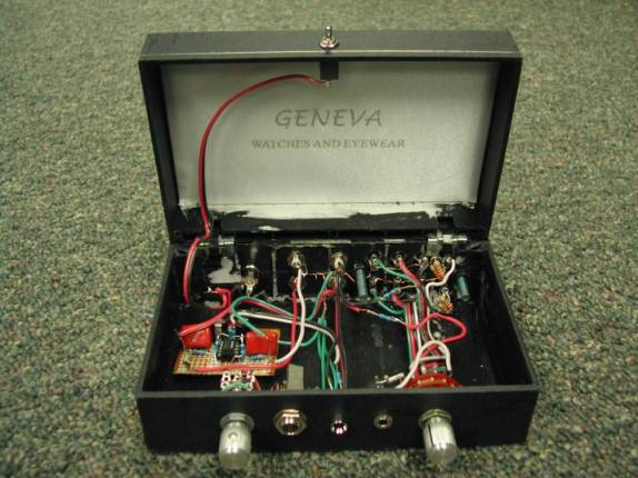

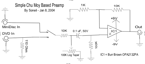

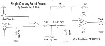

Well, I guess not technically my first, because I had built a headphone amp that I followed some designs for before this which gave me the idea. I saw a passive preamp design by HarryHaller, and wanted to put one of those alongside a headphone amp inside a box with some more inputs, but after some problems (which I asked about on the solid state forums ) I just played around with it until it worked.
Please note, this is more of a product of trial and error than anything else :rolleyes: hence the rediculously long signal path runs. I had to put the resistors on the dvd input to ground to keep it clipping and distorting into oblivion. Correct me if I am wrong here, my dvd player probably has around a 2V RMS (I havent looked it up to find out), and since I am only running +/- 9v into the opamp with a gain of 11 it would need +/- 22V in order not to clip? Also, I'm not sure how to figure out the input/output impedances, and what they should be, any good links I could learn about this from?
It sounds quite good to my ears (not saying much), and doesnt distort anywhere on the volume control scale, which was my greatest accomplishment with it. I havent tried it with a phono input, I am doubting it will work due to the amount of amplification required. Also I plan on trying the audio control used in ESP's project01.
Anyway, just looking for comments on how I could improve the next one, or comments on obvios flaws.
