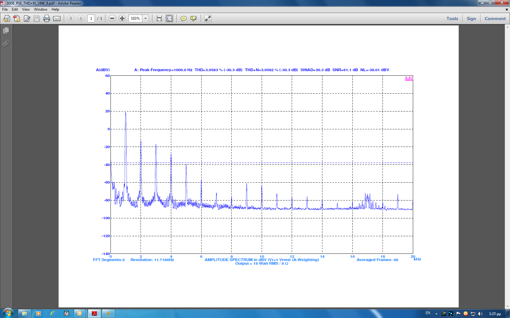

Hi guys, thank you so much for your kind words and for encouraging me. You are very polite!
Now, I ask to forgive me all of you because all the FFT plots I posted above are wrong. Especially I ask the forgiveness of John who financed the construction of this amplifier and probably could be afraid from your replies which are by 100% correct! Also the forgiveness of Andy Groves in who belongs this design which is also used in most of the famous Audio Note SET amplifiers.
As I refer above, my PC was damaged and I replaced almost everything inside as well the OS in Windows 7 Professional – 64bit. So I had to reactivate all applications included the Virtins MI 3.2 Pro FFT which I had to use 1 year ago and I forgot almost everything about it. My sound card also installed with upgraded drivers and Windows 7 allocated their own ASIO driver on it. So MI 3.2 was working with wrong ASIO driver (the correct is the “C-Media Oxygen” and I find it today when I did again set-up of FFT software. The Signal Generator of MI 3.2 takes the control of both sound card and windows mixer, based on the ASIO driver so it is mandatory to be the correct one. I also did the FFT analyses at the full output power of amplifier just before clipping. After your replies, especially of “Glowsignal” who addressed me in the site of P. Millet, I saw that the measurement method is different. I saw it and in other sites. Normally the amplifier is tested at 1Wrms/8Ω which is the reference point for the FFT analysis and some time the THD in max power is referred just for the record.

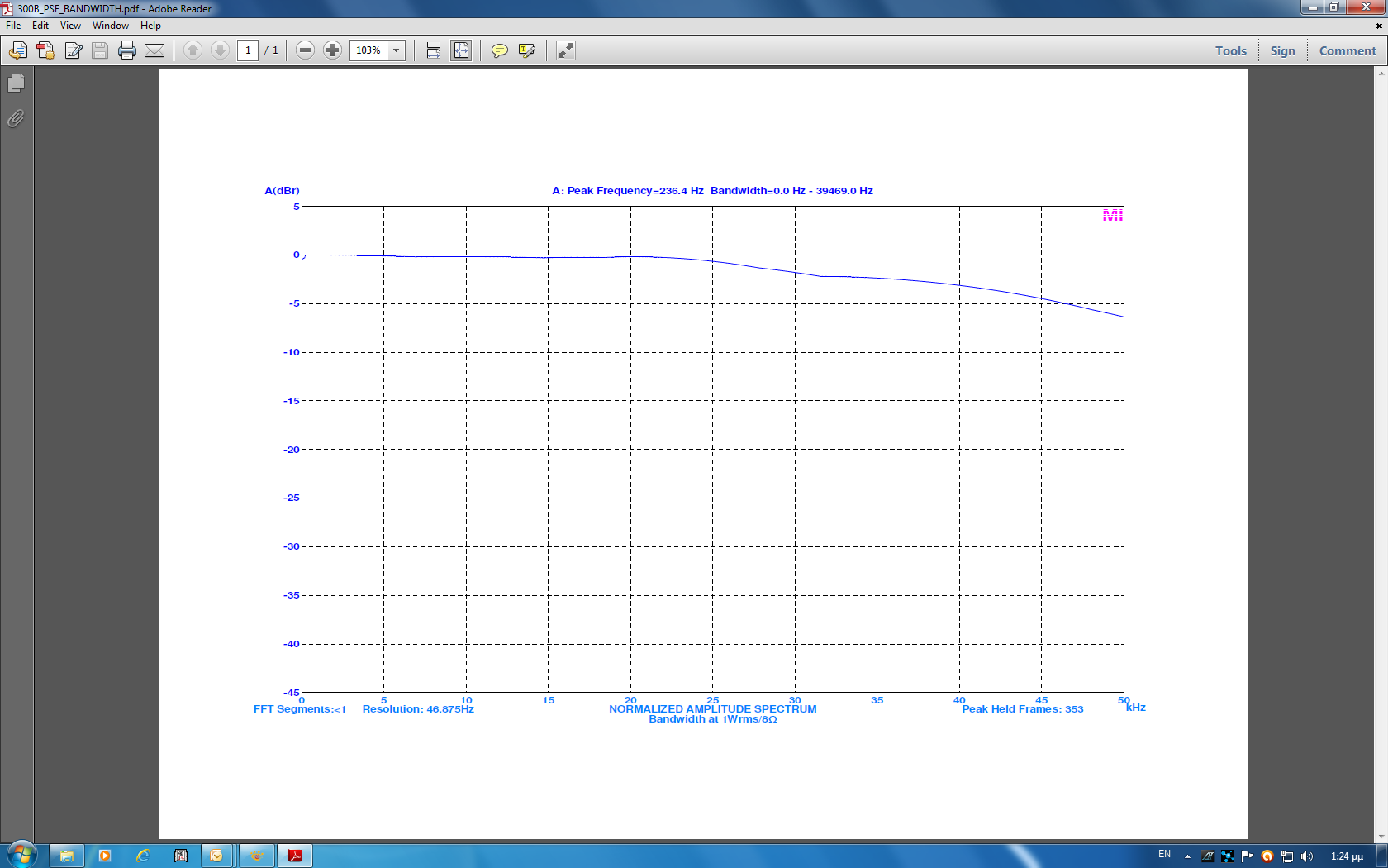

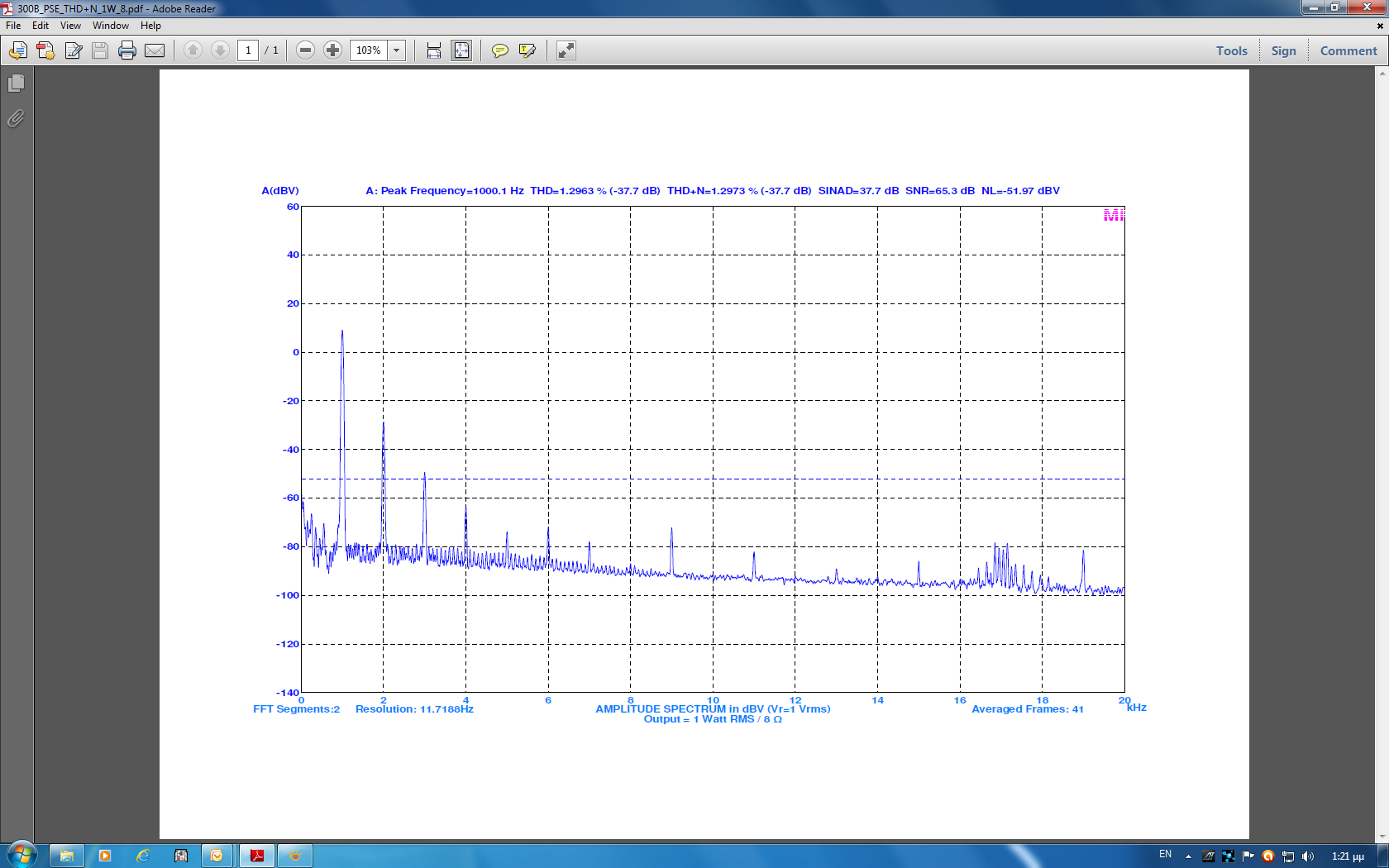

After all these I did again the measurements and I attach the new and correct FFT plots. All plots are “un-weighted” and the smoothing window that used is the “Kaiser 6”.
In the first is shown the THD, THD+N, SNR, Noise level with the output of amplifier at 1Wrms/8Ω. In the second plot are shown the same parameters at the full output power, here you can make a comparison with the previous FFT plot of how much better are the numbers! In the third plot is presented the bandwidth at 1Wrms/8Ω which is taken using as stimulus white noise insted sinus sweep (like does make all good people). I also attach the plots in pdf for a better view.
I hope the misunderstanding has now resolved and I ask again your forgiveness for the misinformation.

Thank you so much fellow Δημητρη for your kind words!Nice build congratulations !! I think that you have high levels of distortion too , IMO the reason is that you have one stage of voltage gain using the EF86 in pentode mode and you want to obtain the maximum gain from it without any kind of feedback local or global .
Yes, you were right about distortion level. The first FFT analysis i did was wrong due to wrong set-up of MI Pro 3.2 FFT software as i explained in my previous post. Hope now the numbers are good for a SET power amplifier without any feedback. As i refer in previous post "no global feedback" was a demand of John who is the finance of this project.

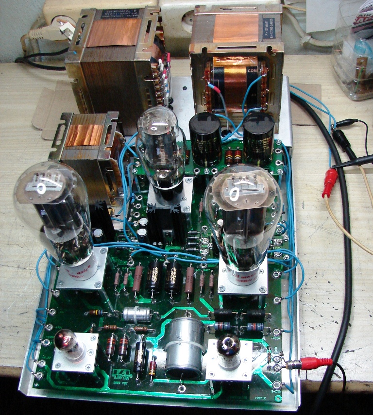

Amplifier picture during tests
And here is a picture in which you can see the off-hand wiring of amplifier that i did for the tests. I ordered UPOCC Silver wire and teflon tubing, but i received them this Friday, so i had no other solution for making the tests for so long time. I hooked-up all PCBs and parts between them with common electrical NYA 1mm wire. I've also checked the place of output trafo (in the right side) if is good. Indeed, the "T" place against the power trafo (left side) proved quite good. I haven't any EMI infection of output trafo from the Mains one. The total noise (HUM and HISS) i measured under such conditions is -52dBV (about 2mVrms) as is shown and in the above FFT plots. I hope that will be reduced further after the completion of mild steel trafo covers and the copper top plates.
