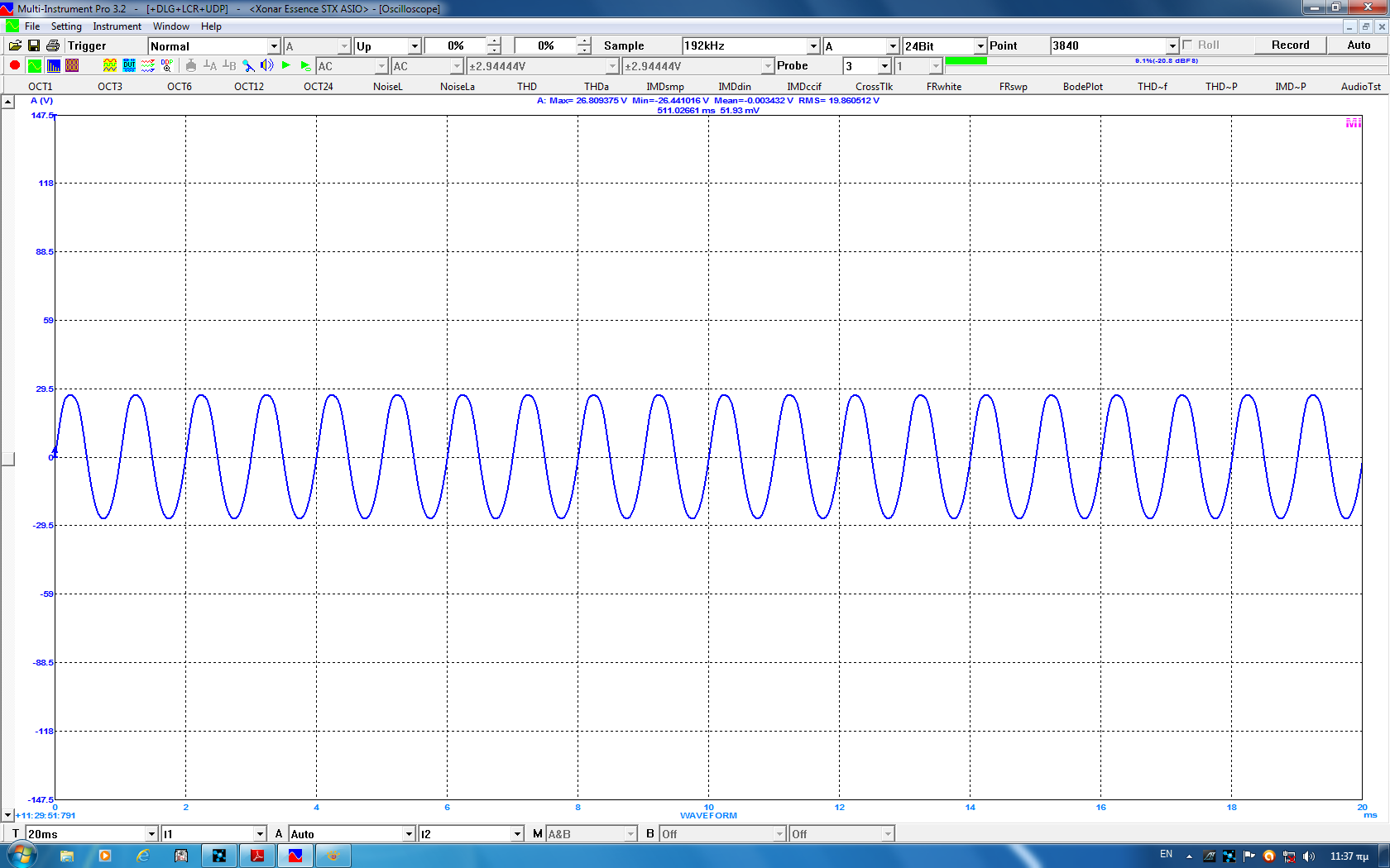

To the present I attach 4 screen shots I taken from my DSO that show the behavior of amplifier in square waves at the 4 most common frequencies: 100Hz, 1KHz, 10KHz and 20KHz. Also a sinus that shows the peak voltage amplitude. In all measurements a 8Ω dummy load was connected at output. When I receive back my workstation PC I will make and the FFT analysis (how much is the 2nd harmonic?) and I will upload all schematics. Pictures of device in few days when chassis will be completed.
I will appreciate very much any comment and any suggestion. Thank you very much.

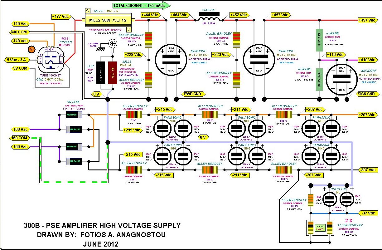

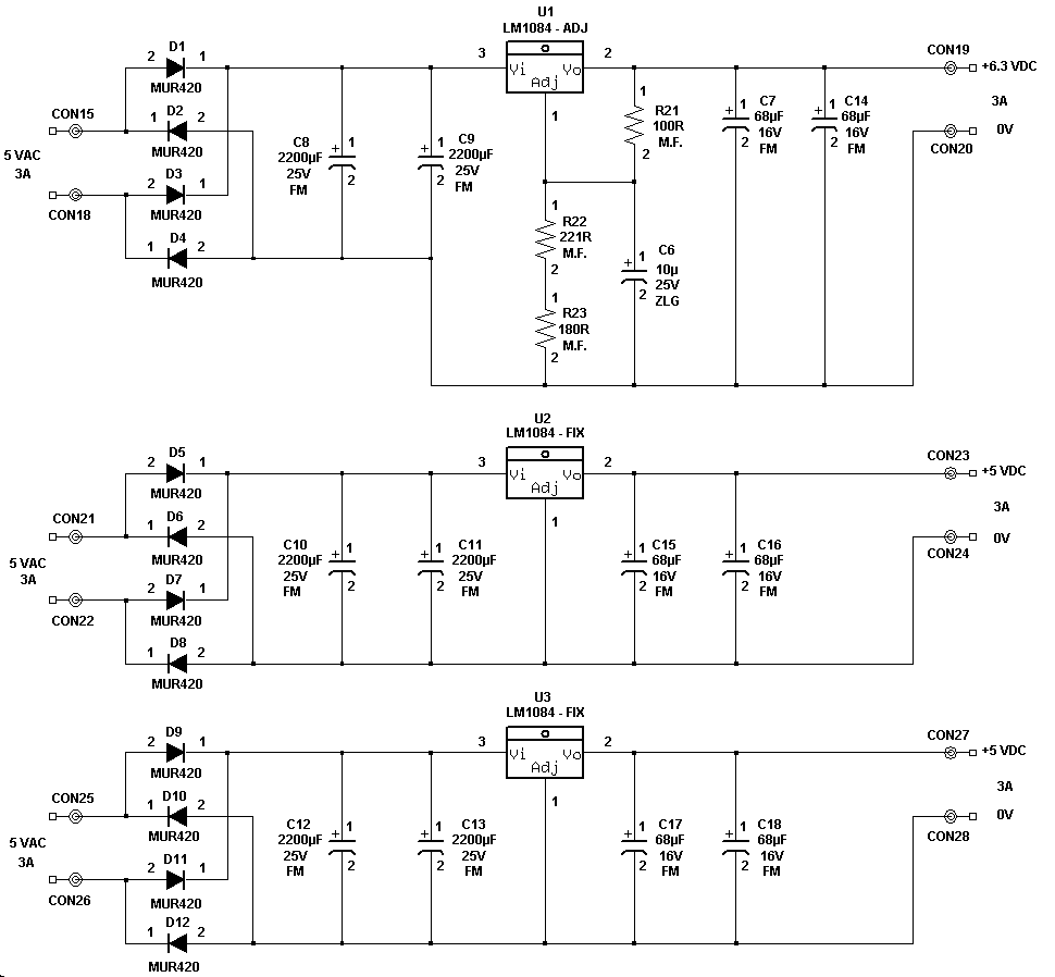

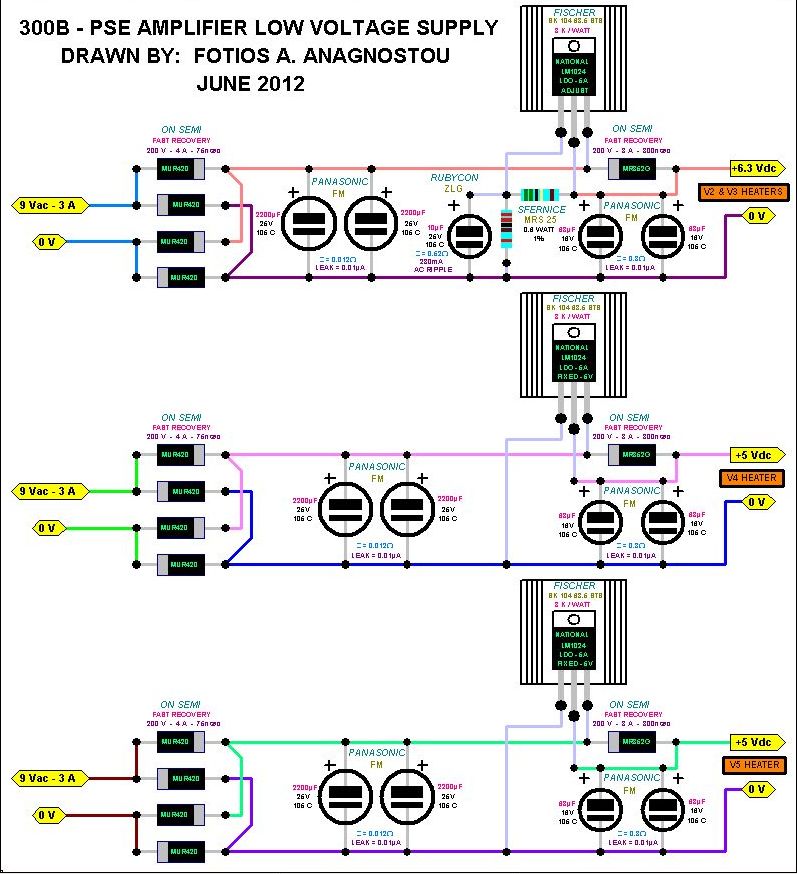

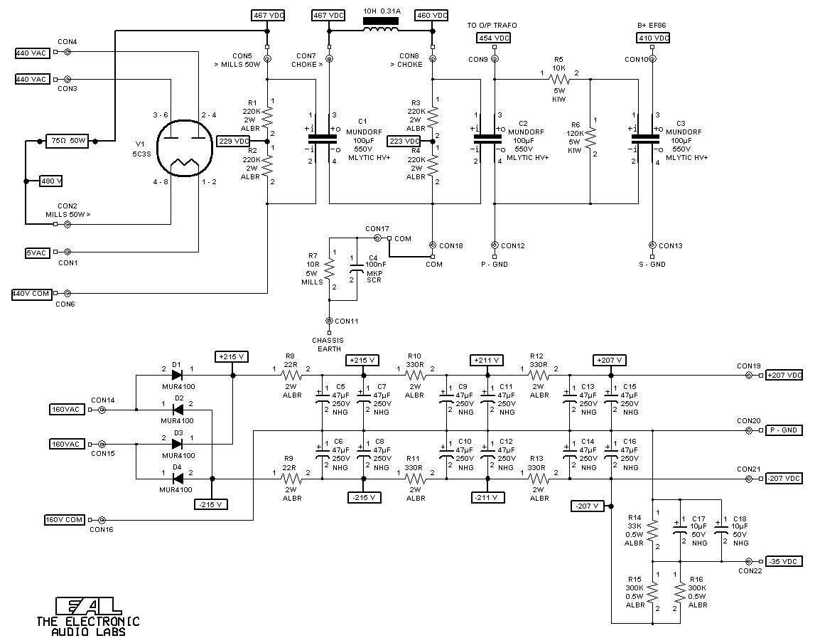

Schematics 1
Hello
Here are attached the schematics of Power Supplies. The HV marked is for the high voltages while the LV marked is for the tube filaments. Also the schematic of amplifier. All schematics are presented in artistic mode but the value and the identity of each device is the true, as well all voltage markings. All measurements have taken with the mains voltage stabilized at 228Vac thru an autotransformer which is continuously callibrated by a microcontroller to the preset value, thus is not a simple variac. Because the poor resolution of pictures i also attach these in pdf format. You can open the pdf files to see most clearly the schematics.
Thank you.

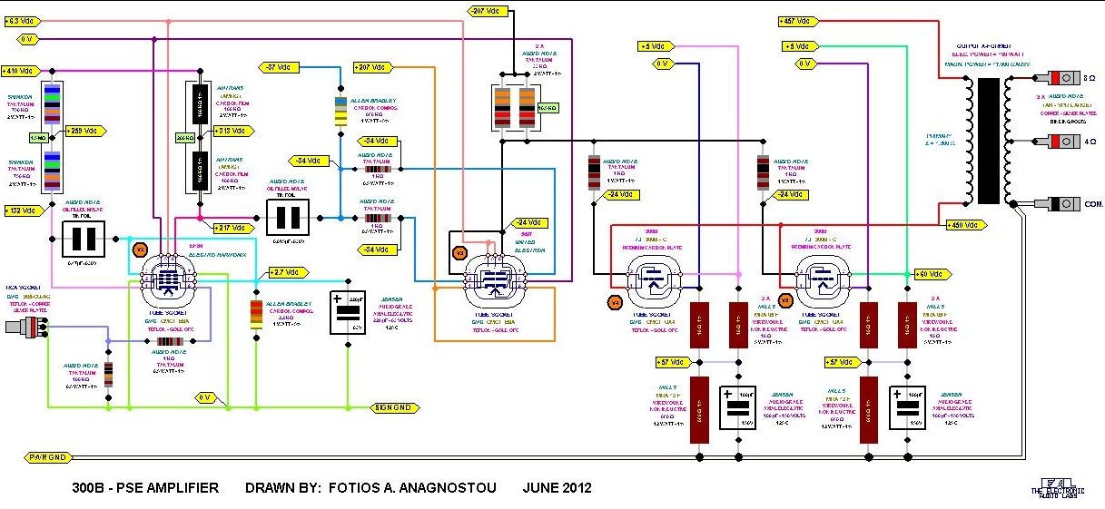

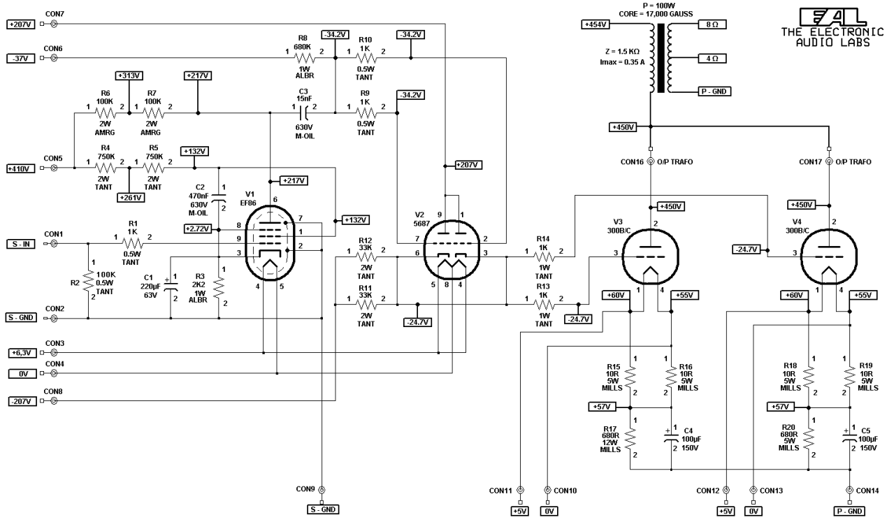

congratulations for finishing your project!
Schematics are a little hard to read, but i think i understand the amp part. Well, the way G2 and G3 of EF86 are connected is new to me and i would like to understand it better. In my builds it is connected "normally" as pentode with some nfb for lower distortion (it sounds a little edgy without it), or as triode without nfb.
If there is enough gain you could try some nfb around EF86, it might sound better this way.

Thank you so much for your kind words and your comments GlowSignal !
You are right about the unusual connection of G2 and G3, it is this huge 0.47μF "Mylar in Oil" capacitor connected between them. I have seen in Philips datasheet the usual way of connecting G2 to Gnd thru a 0.05μF cap.
EF86 works as a voltage gain stage. Looking at the Philips datasheet and taking into account the given values of anode - cathode - G2 resistors and the 217V anode voltage, this tube should work with Av = 170. With the given input sensitivity of 0.45Vrms, Av = 76Vrms that exceeds the max output of 44Vrms given by Philips. So the required gain is fulfilled. BTW EF86 has much higher gain than any triode but needs some special precaution due to its sensitivity.
In other products of Audio Note, like the kits "Legend monoblock" and "Interstage monoblock", Andy Groves again makes use of a pentode in input, this time a 6SH7. In the "Legend" the 6SH7 drives directly the two output 300B tubes and again Andy has connected a 0.47μF cap between G2 and G3. In the "Interstage" the 6SH7 drives the two 300B output tubes thru an interstage transformer and in this design Andy does not use this 0.47μF cap accross G2 and G3.
From my solid state experience i know very well that each voltage gain stage presents large ammounts of Miller capacitance which is translated in overshoot and oscillations in the collector (anode for tubes) of VAS transistor. To eliminate it, we connect a "Miller compensation" capacitor of some pF (usually 15 to 100pF) accross collector and base. I think that Andy makes the same by inserting the 0.47μF cap accross G2 and G3, while in the "Interstage monoblock" Miller capacitance is eliminated by the primary winding (is a good coil) of interstage transformer so the cap accross G2 and G3 is absent. I am not sure for the above described, but in my project i tried to remove the 0.47μF cap and i had big oscillations from 500Hz and above. For that reason exactly i make the tests with square waves that i presented in my first post. You can see that all square waves are clean without any overshoot.
By sure the 0.47μF cap offers a form of feedback. I don't know what kind of feedback you mean exactly. Please advise me, and GREAT THANKS AGAIN.
Square Waves
For 30 years, i allways use square waves to test any of my solid state projects. The same i did and in my first tube project, you can see the results in the screen shots of first post. The use of a square wave as stimulus in input, it can reveals many usefull informations about the circuitry of project. Ringing, overshoot and oscillations show a bad compensation of Miller capacitance of the Voltage Gain Stage. It also shows a great instabillity of amplifier that is mandatory, especially in single ended without feedback tube designs. Negative feedback offers some form of protection against instability and its absence is a great risk for the circuit. A sinus wave used as stimulus can not reveals these oscillations or overshoot, if exist. I have seen in some tube threads screen shots from oscilloscope that show these ringings. For that reason we use a compensation foil capacitor of some nF arround input tube, either connected to Gnd or accross G2 (screen grid) and G3 (suppressor grid). I think that this capacitor offers some form of feedback from mid to high frequencies in input tubes, especially in pentodes which offer very high voltage gain so are very sensitive in external RFI, EMI etc. infections.

Hello
Here are attached the schematics of Power Supplies. The HV marked is for the high voltages while the LV marked is for the tube filaments. Also the schematic of amplifier. All schematics are presented in artistic mode but the value and the identity of each device is the true,...
These "artistic" schematics are VERY hard to follow. Wires are crossed up inside the very small tubes symbols.

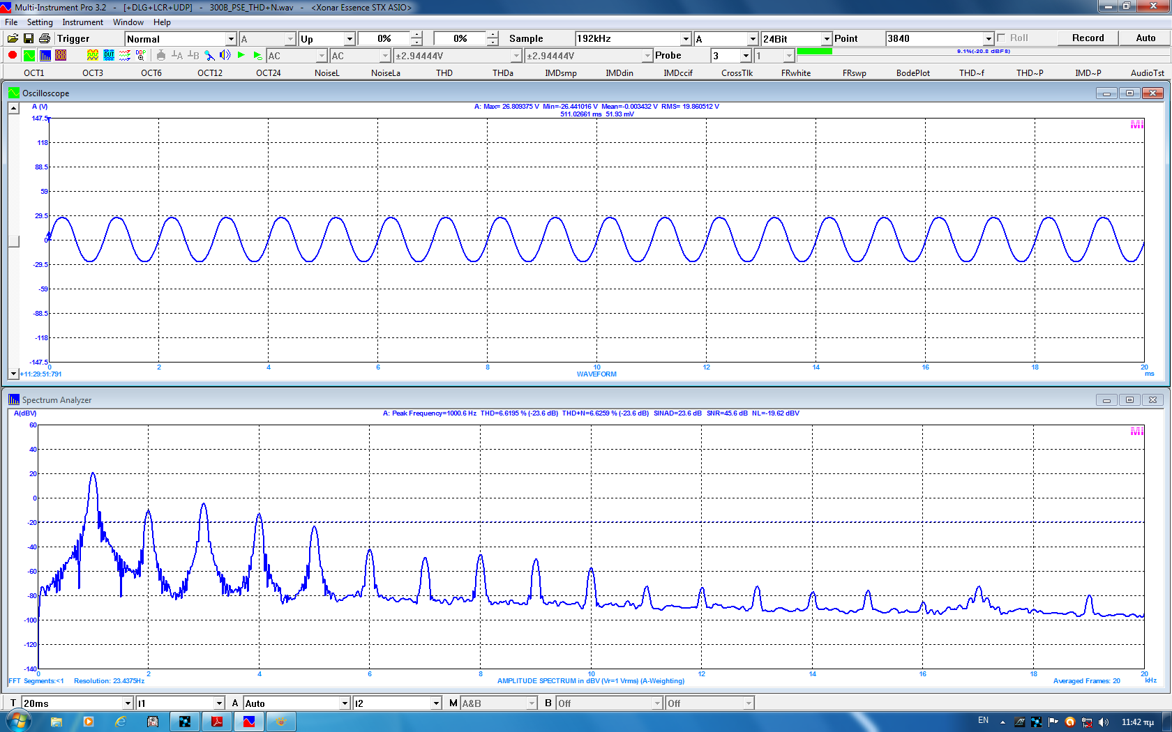

I looked at the scope shots. I'm betting a few percent harmonic distortion in the single digit range. This is I think the goal of both these SET amps as well as guitar amps - to add a bit of distortion. How much is a mater of taste.
Looking forward to the FFT numbers

For the record now, from the 10KHz and 20KHz waves shape it is obvious that the EF86 is somehow overcompensated. For that reason the -3dB upper frequency limit lies at 22KHz. If i used a smaller cap than the 470nF monster, say 220nF, i think that i could obtained a -3dB upper frequency limit at 40KHz but... in the cost of increased distortion. I know the concept behind tube amplifiers, is the high level of 2nd harmonic (mosfets also obtain a signifficant ammount of it compared to "poor" BJTs) that sounds nicelly in the ears of people. So i try to do a compromise between conflicting things. I don't like e.g. a 10% THD yet at full power! I could accepted a 5 to 6% THD as much. The amplifier is addressed for a home Hi-Fi music system, not for electric guitar, i know from these things as i was working enough years in live stages. The lead guitar performer likes a... ton of distortion at 130dBSPL in bass frequencies where the thing is technically difficult to obtained. It is mostly a mater of speakers, not so much of the tube head!
Another one issue is the output power. These 300B/c are amazingly strong. I tried them with 500V on plates, and i got almost 15Vrms accross the 8Ω dummy load just before clipping occurs and that means an output power of 28 clear American Wrms 🙂 (i allways use the EIA methods and standards). OTOH, i really dither to push so hard the output 300B/c, i still don't have experience of their service life, just that are stronger compared to mesh plate ones.

Clear schematics & valid voltages
My workstasion PC is again in order repaired and upgraded with new AeroCool PS, Asus M/B, Intel i3 3.4G CPU and 8GB RAM!🙂 Though the expense was big 🙁 (340 Euro) for the difficult times we pass in Greece i finally am happy. The worst is that the PC damage (fried Power Supply and M/B) caused from bad luck, i did a measurement in the output of power resistor after the cathode of rectifier 5C3S (480V) and the probe of multimeter was sliding on chassis causing a short circuit. My PC was in operation and fried 🙁. Probably the 480V HT passed thru the mains earth conductor to PC. BTW this 5C3S proved a nonster! With its solid carbon plates it doesn't give a damn about any short-circuit. The same the MILLS 50W cathode resistor!
Well, as i promised i attach the actual schematics with valid voltage marked on each point. Tommorow i will make the FFT analysis of amplifier and i will post the results.

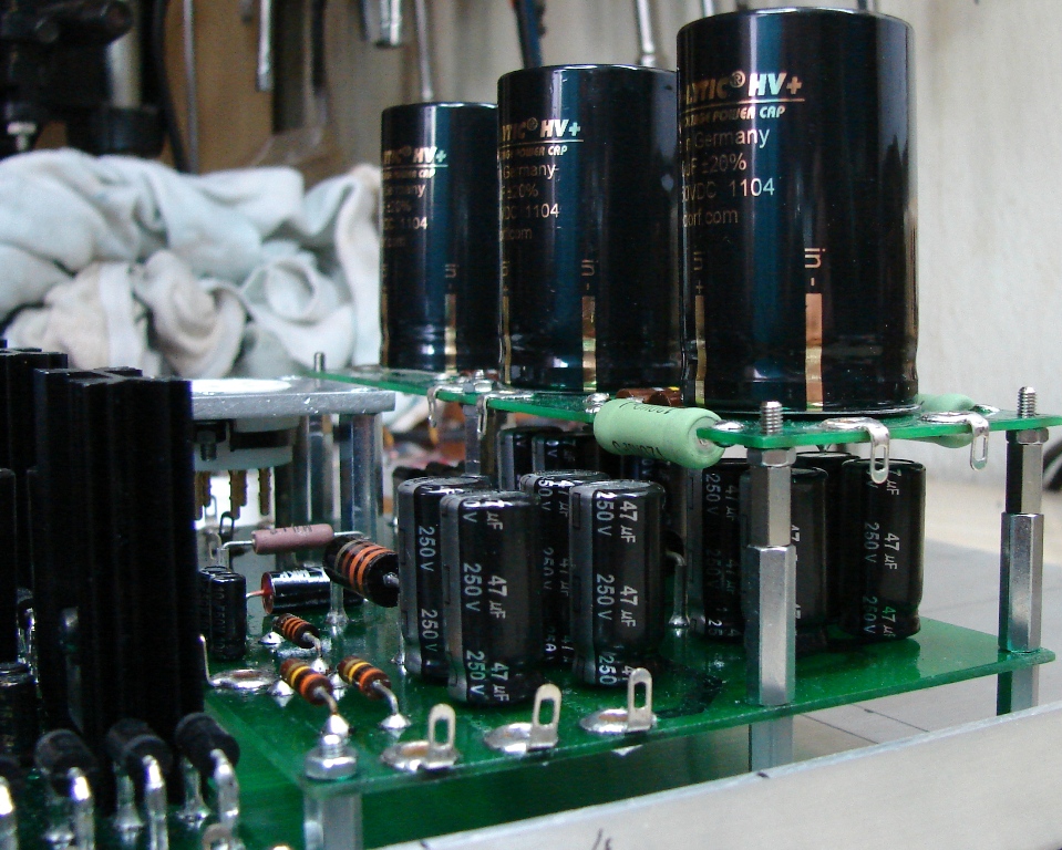

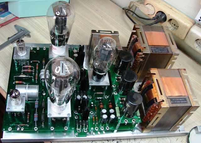

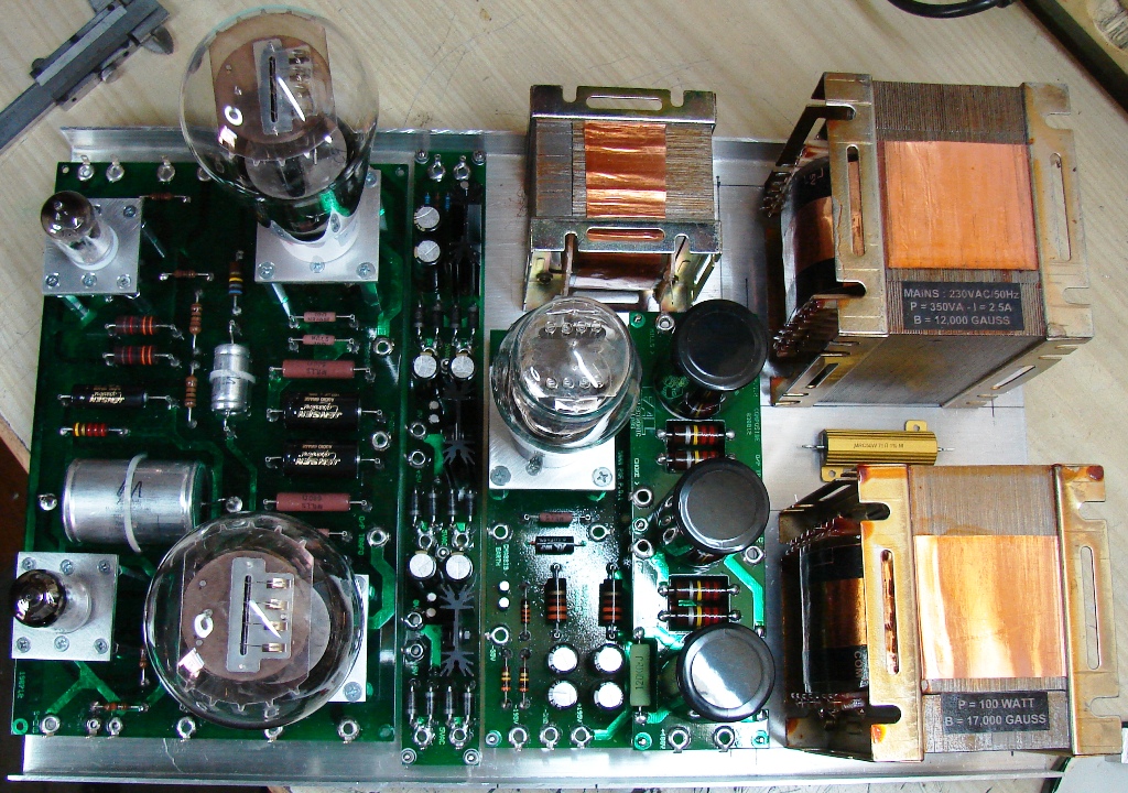

some first pictures
Though the amplifier is still not completed, i attach two general view pictures before the wiring and one that shows a detail of HT power supply pcb stacked with long spacers on the 5687 tube power supply pcb.

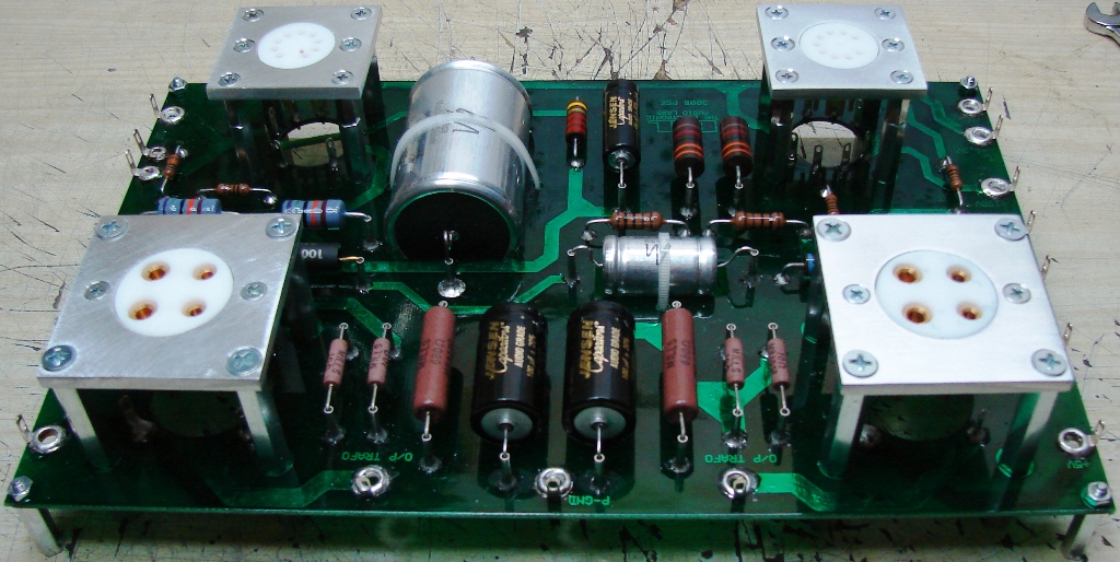

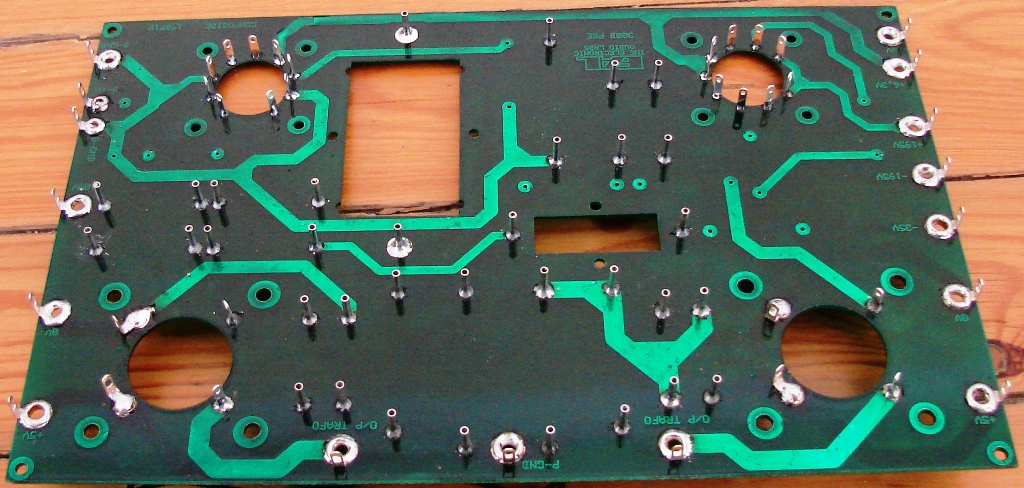

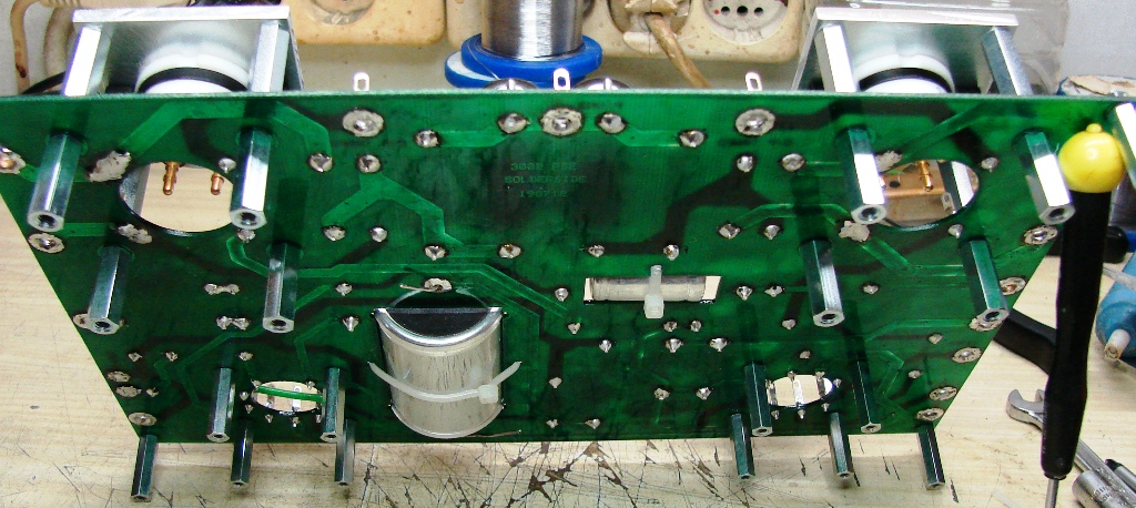

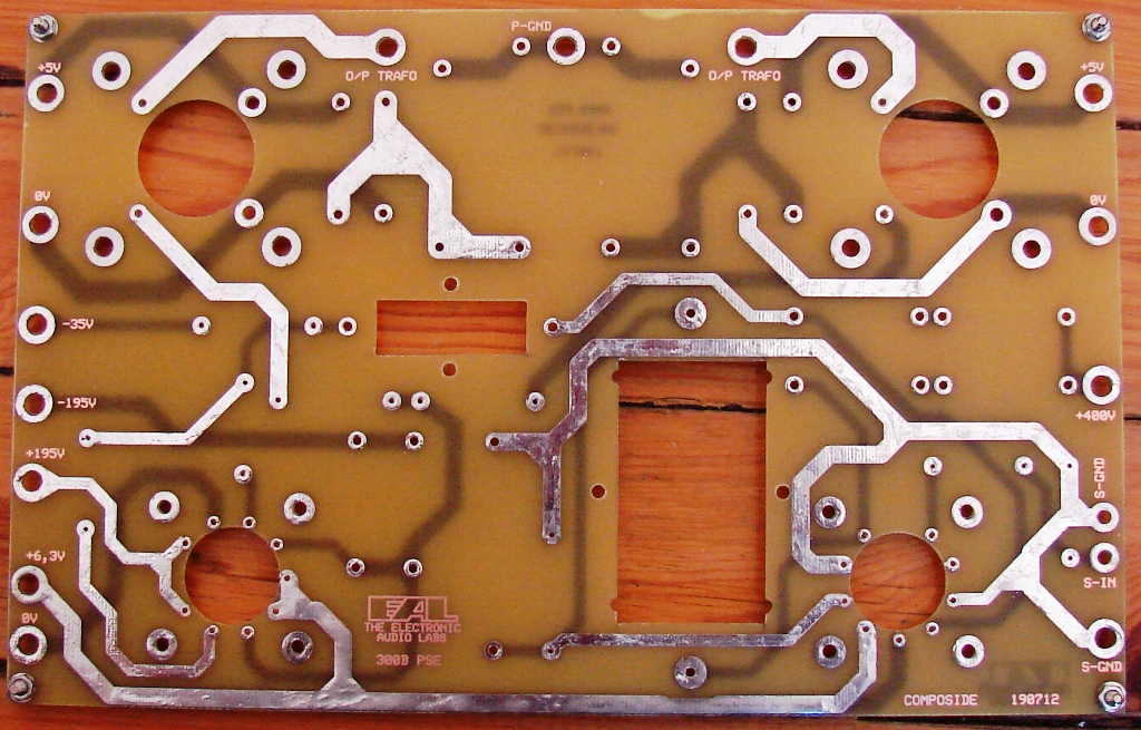

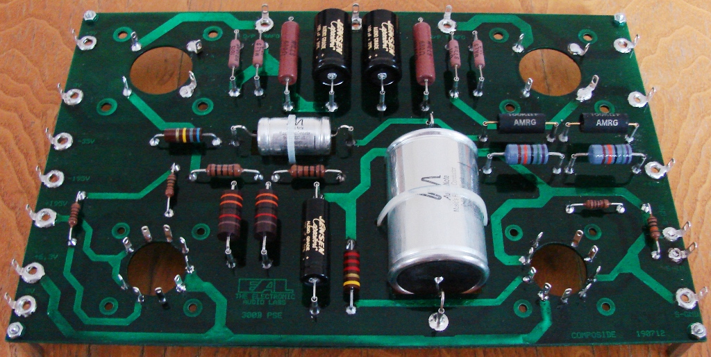

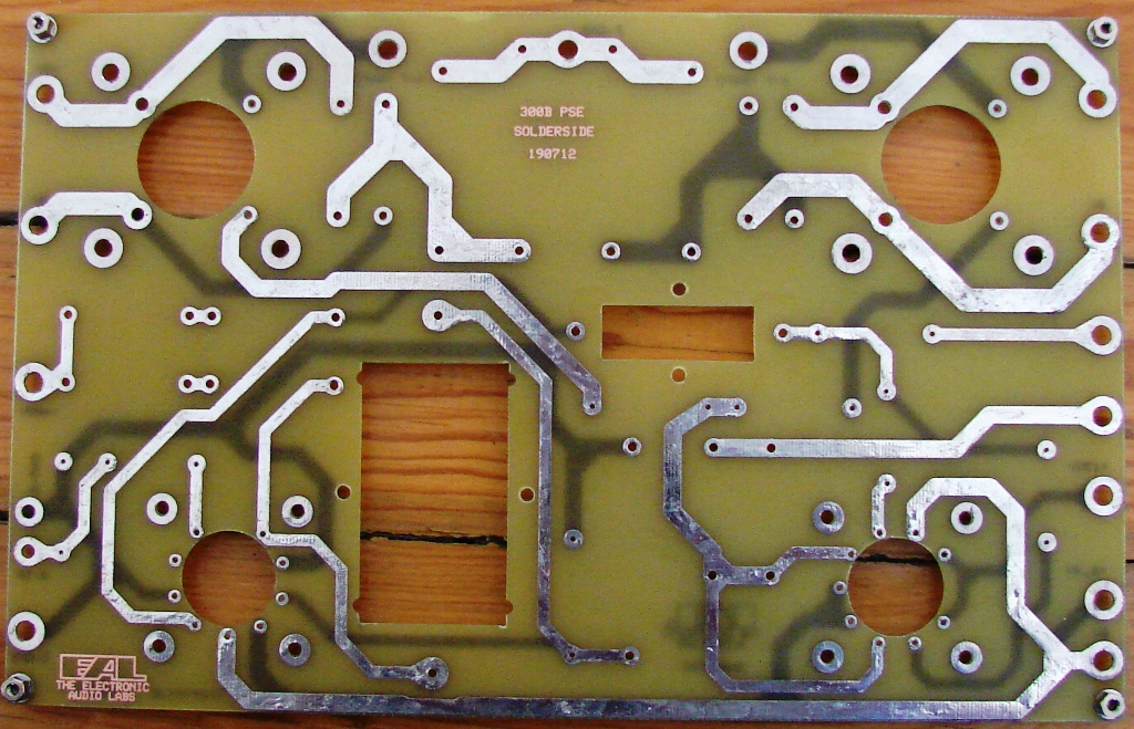

Home made PCBs
Here some pictures that show the proccess of main pcb step by step:
1. The pcb is drilled, cleaned and tinned with a thick layer of Radiel-Fondam Sn96-Ag4 solder wire.
2. The pcb is double sided, here the solder side.
3. The pcb is sprayed with green protective laquer. Solder lugs are mounted with copper rivets and then soldered on the tracks. Collar sleeves are firstly punched to be stable and then are soldered. Both are "Ettinger" silver plated. I use collar sleeves as spacers for the parts to not touch the pcb surface.
4. The pcb is assempled, all parts are of first quality.
5. Here the CMC teflon - gold tube sockets firstly are mounted on home made 4mm alu plates, then the pcb is fixed with Φ4 spacers between tube bases. These tube bases are screwed directly on bottom cover of amplifier and are very solid, tube sockets are not solrered directly to pcb. To this i use small pieces from solid silver wire.
6. A picture of pcb from underneath, you could understand better the concept of tube bases.

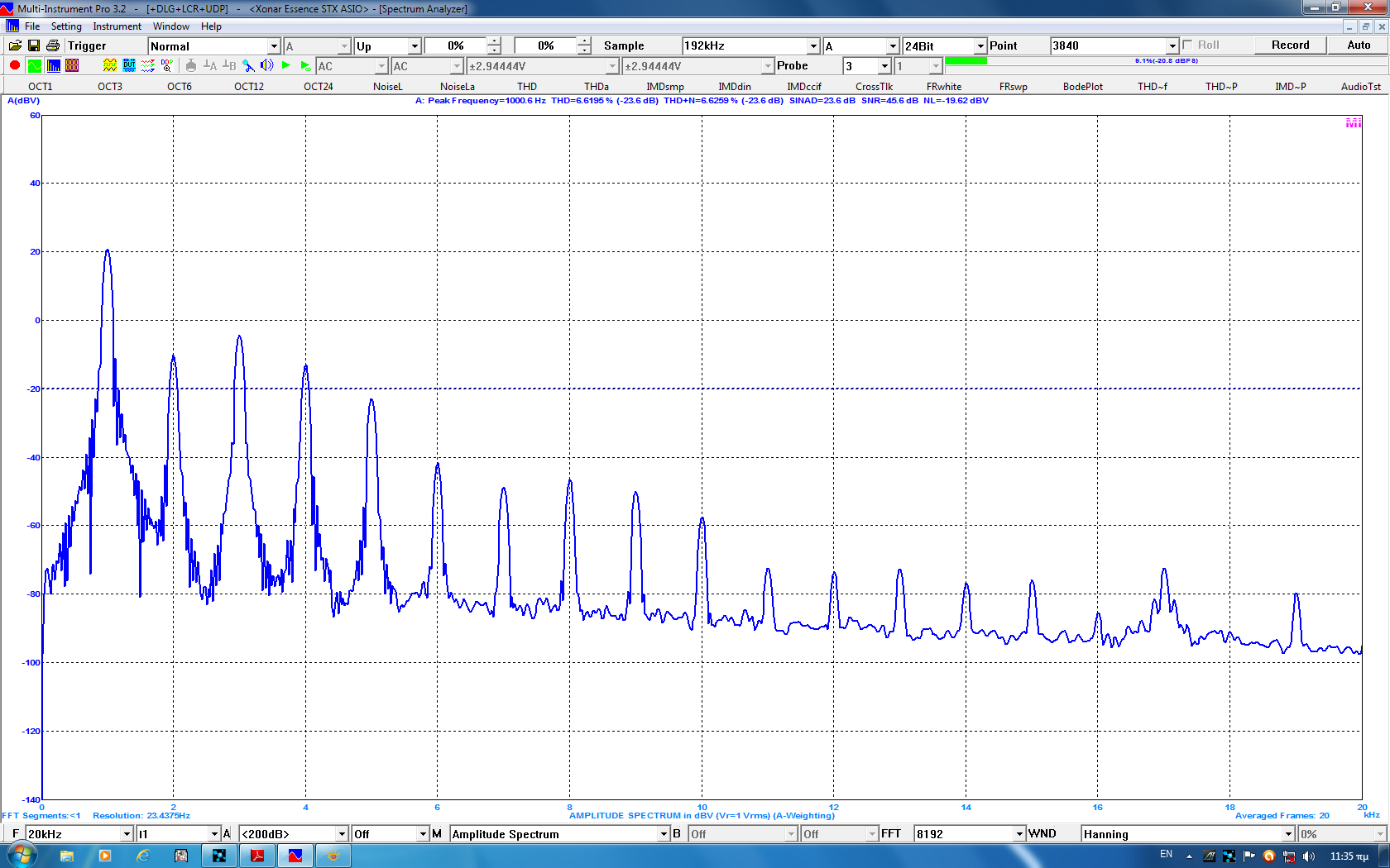

THD+N and Max Output at 8Ω
As i promised, just now i finished the FFT analysis of amplifier. The FFT analyzer software that i use is the "MI v3.2" of VIRTINS TECHNOLOGY and the interface an ASUS Xonar Essence STX pci express sound card. In the output of amplifier a 8Ω dummy load was connected. In general i got a max power of 20Wrms/8Ω with 6.5% THD+N "A-weighted".
Attached are the plots both as pictures and in pdf for better analysis.

Correction!
In the above plots, the probe calibration factor was placed from mistake at 3.
See please on the top bar in "Probe" box. It should be noted that the sound card is thoroughly callibrated with the aid of an external precision function generator and a DSO. That is obvious again on the top bar:
"+/-2.94444".
So the real RMS value of signal is:
(19.8Vrms X 2) / 3 = 39.6 / 3 = 13.2Vrms
This max value of 13.2Vrms is also verified by the 5th screen shot of oscilloscope that is attached in my first post.
OTOH the FFT analysis is not affected by the probe callibration factor, will be the same either at 1 or 2 or 3. So the values of THD, THD+N, SINAD, SNR and NL are TRUE and expressed in dBV scale so you could make your own TRUE Voltage calculations. Remember please that 0dBV = 1Vrms, so e.g. 2Vrms = 20 X (log 2) = +6dBV etc.
Another one example is shown in the above FFT plot where the foundamendal 1KHz test frequency has amplitude of +20dBV (the peak exceeds a little the +20dBV line). The given value of 13.2Vrms above corresponds to: 20 X (log 13.2) = 22.4dBV and that proves the reliability of measurement.
Forgive me for the mistake 🙂
Well Chris, your prediction based on the scope screen shots of my 1st post proved right! Indeed the THD at the max output power of 21.5Wrms/8Ω is just 6.5% as indicated in the FFT plot. You are a true master in audio electronics! 🙂
Here is the results of FFT analysis that i did mainly because you asked them.
Thank you and i am looking forward for your comments.

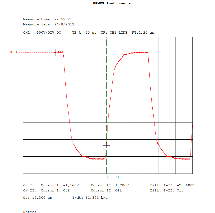

Frequency response
Though i did a lot of careful preparation today for the FFT analysis (measurement of a tube amplifier with 480V HT is enough risky for the sound card and in general for the PC, you know that i have personal experience) i forgot to do and the bandwidth measurement.
BTW there is an accurate method to do this with the DSO, using the "Gaussian system response function".
To this, we simply have to make a measurement of the rise time of a signal in the output of amplifier. The use of a 10KHz square wave as stimulus in input is necessary. Then, with the aid of the cursors of DSO we can measure the rise time of square wave at the output of amplifier.
With the use of Gaussian function BW = 0.34 /Tr where BW = bandwidth in Hz and Tr = Rise Time in sec, we can find the upper frequency limit of amplifier.
In the attached picture captured with DSO you can see that the Rise Time is dt = 12.3 μsec
So the bandwidth is: BW = 0.34 / (12.3 X 10^-6) = 27,642 Hz.
In the worst case of a small shift of cursors from the nominal 90% of the output signal full swing the Rise Time would be 13μsec as much. In this case the upper frequency limit will be: BW = 0.34 / (13 X 10^-6) = 26,153 Hz which is not so big reduction.
For the record, in my solid state projects and using exclusivelly BJT transistors i usually get Rise Times from 0.8 up to 1.2 μsec as much.
THANK YOU SO MUCH FOR YOUR ATTENTION! (I don't have nothing better to do at this moment 😀)

You do some very nice looking and detailted work. I like to use "turrets". You call them "collar sleeves" but they look the same. I've never liked PCBs for tube equipment but "point to point" looks like a mess (when I do it.) so I like to compromise. Here is a photo of a power supply board I made for a stereo amp. It slightly resembles your method but I can make these in 30 minutes start to finish, literally. It is very fast. I draw the design on the fiberglass with a pencil them walk to the drill press, install the turrets then solder the parts.
https://www.dropbox.com/sh/vspqq9fbsptuoq9/6xIQUgVkhj
The box and chassis is a first "test fit". Neither is complete yet. But the PS board is done and will fit inside the chassis. Notice this board is a "wiring board" but it is just not a "printed wiring board". I use real wire.
