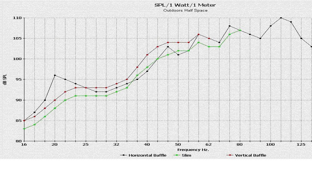

Graphs is not all that they appear to be
THe SPL measurements are taken outside. So on the low end you can expect close to 10 db gain due to corner and wall loading. So you probably will end up with more than you hoped for.
BassAwdyO I doubt that the driver you have is at 100db/watt at 30 hz in any othet box. If you get around 90 db/ watt you will with the gain that you have allready noted ( about 10 db ) get to your goal.

Forgot the chart!
A couple of basic understandings with this graph.
The driver has a basic efficiency of 95 db/watt. Yours does not. So lower the overall gain by about 6db. The horn supported region above 40hz will give your driver a 10db gain. Or around 98 db/watt.
OK check the roll off. The horn unloads around 40hz due to the size of the horn mouth. A good design choice as most pop music and indeed most music has little bass below that. THe cool thing is that the driver is still giving usefull output below that due to the length of the horn. Don't forget the room gain that will had and you still should be in the 90 to 95 db region in room loudness at 30hz. A corner placement will give even more reinforcement at the expense of a bass hump. Move the box around a while before you get comfortable with the sound.
Hope this helps!
MArk
Hope this helps!
MArk
