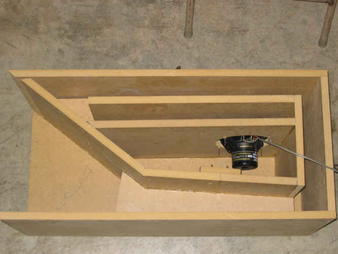

Well.... after about a half a day's work the enclosure is basically finished. Once my digital cam battery charges I'll post some pictures, and after that I'll hook it up for a listen!
I'm using one of my extremis6 midwoofers in it right now, so I dont know how good of an assesment it will be considering that it was not designed for this speaker, but a horn is a horn and the speaker in question shouldnt have too dramatic of an effect on it's function... right?
Here's a side view with one side removed....
I know the woodworking isnt perfect, but what can I say. That angled peice that forms the mouth is the most horrid. My table saw only goes to 45degrees though so thats the best I could do with it. Oh well.... I'm filling all the gaps with hot glue(for now) to seal it up and hear how it sounds. Once I get the MCM I'll take it apart and liquid nails everything and finish it off.
oops... forgot to attach the pic
After hooking it up and listening I'd say the in room usable response ends at ~40hz. However comparing to a sealed box its got to be at least 10db more efficient. I havent done any measurements yet, but its more than twice as loud. Amazing....
