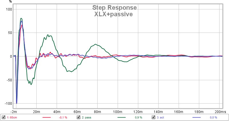

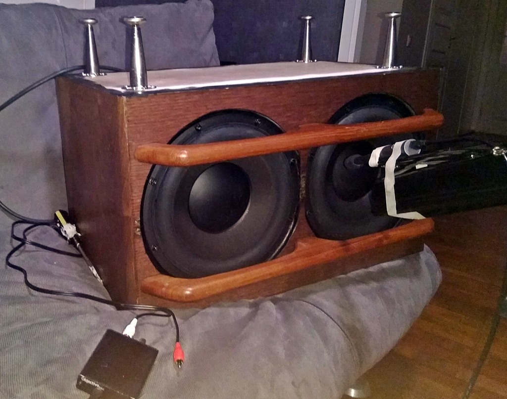

I grabbed this old thread to share my first sub restauration project.
I made my sub perhaps in 2008, following very popular concept of Peerless XLS-10 and passive radiator in a small 25 liter box. I searched the net and finally copied the box somewhere. It has drivers side by side, a separate compartment for Hypex DS2.0 amp, and two compartments filled with sand. Passive has extra weight for 100 grams.Material is 27mm MDF and front baffle has additional 12mm sheet. Weight is approximately 45kg.

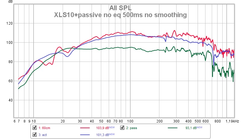

Then I didn't have any measurement gear, I had to trust the info in the net, including added weight. Recently the sub has been at my children's apartments, but now I got it back. Measurements were astonishing! Perhaps the suspension of passive unit has hardened, but even without added mass passive is not working for good. Yes it vibrates, but sum effect is zero.
Because Hypex DS2.0 has some eq, I will buy a second active XLS-10 unit and add it in series. Volume knob is usually at 9 o'clock so we have lots of power available.
Here speaker is upside down on doctor's table.
