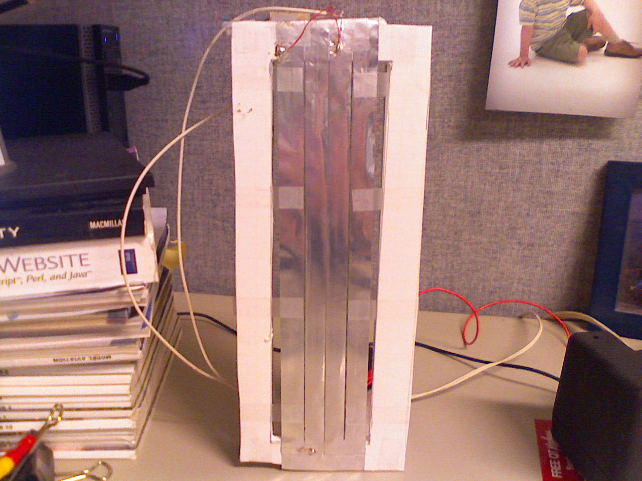

Ok, I think I've taken this project about as far as I can without actually buying things.
Here is the current ribbon.

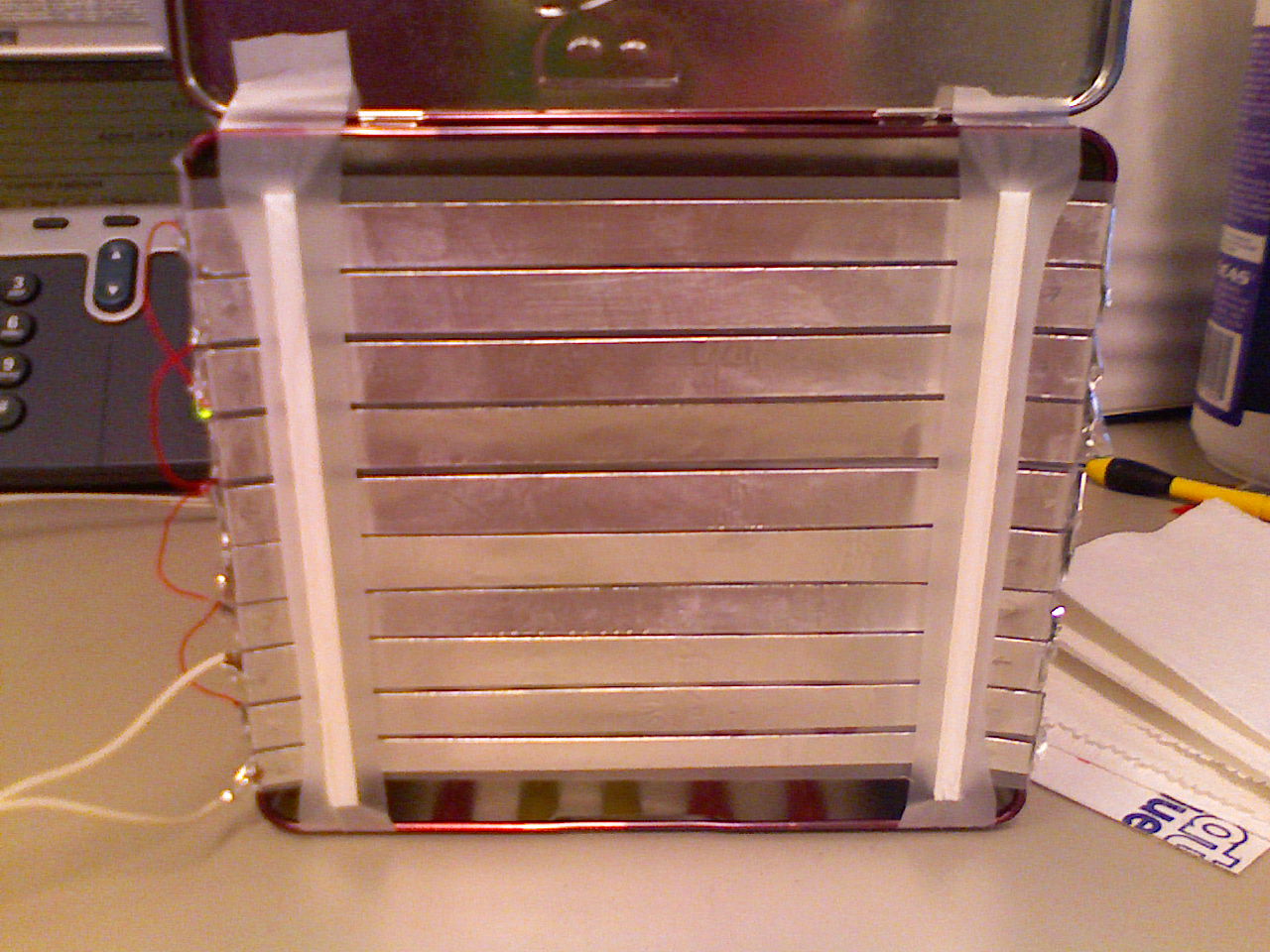

And now I am proud to present: My first planar speaker!!! The frame is a tin that came with a set of CD's. The same magnetix magnets stuck to the bottom of the tin. Slightly overlapping scotch tape for the film and aluminum foil for the coils. It is quite a bit louder than the ribbon speaker, but the ribbon sounds better.
I've been playing more with the planar speakers and have a few questions. To bring the resistance up I'd still be looking at custom winding a torrid right? Do I need any capacitors? Is volume and clarity directly affected by magnet strength?

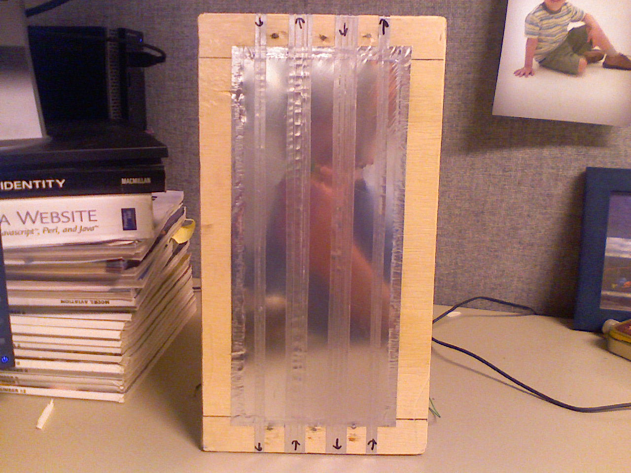

My latest set,
Same foam from before
I picked up some 50 X 13 X 3mm neodymium magnets
The coils are aluminum foil, 7mm wide.
These are by far the best sounding and most efficient pair I have built yet.

Help please:
The speakers pictured above have a resistance of about 1Ohm. How would i go about making them 4 Ohm? I tried making a toroid transformer, but got kind of lost. I ended up making an attenuator/low pass filter...😕
Cut each aluminum strip in half length-wise to make strips 3.5mm wide and connect them all in series.The speakers pictured above have a resistance of about 1Ohm. How would i go about making them 4 Ohm?
Double the length and half the width gives four times the resistance.

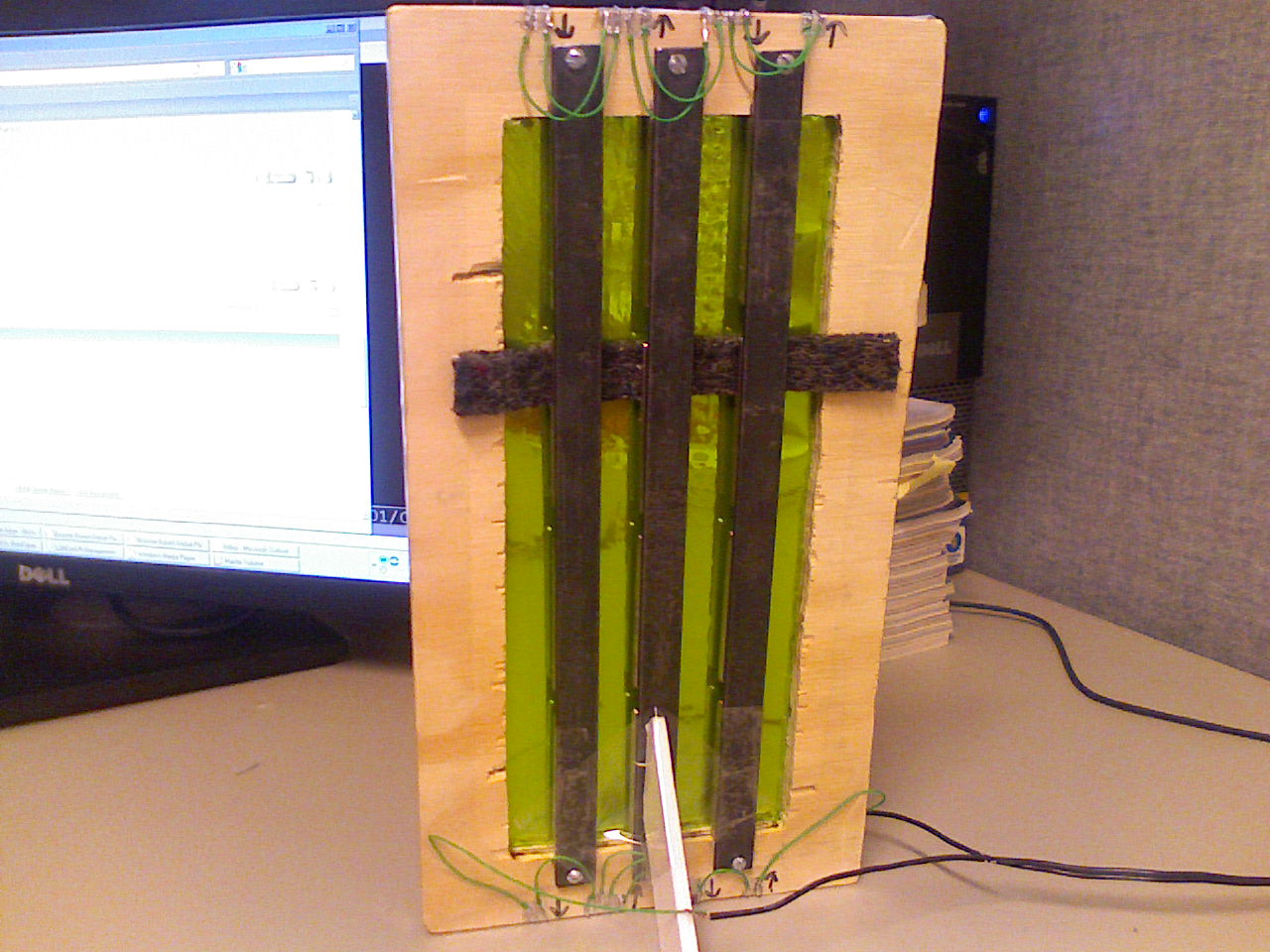

Ok, here is my latest attempt. The panel resonated a lot so I added a strip of felt between the magnets and panel. Seemed to help. This one sounds hollow as compared to the last one.. On a good note it is 3Ohm, so that is a step in the right direction.
