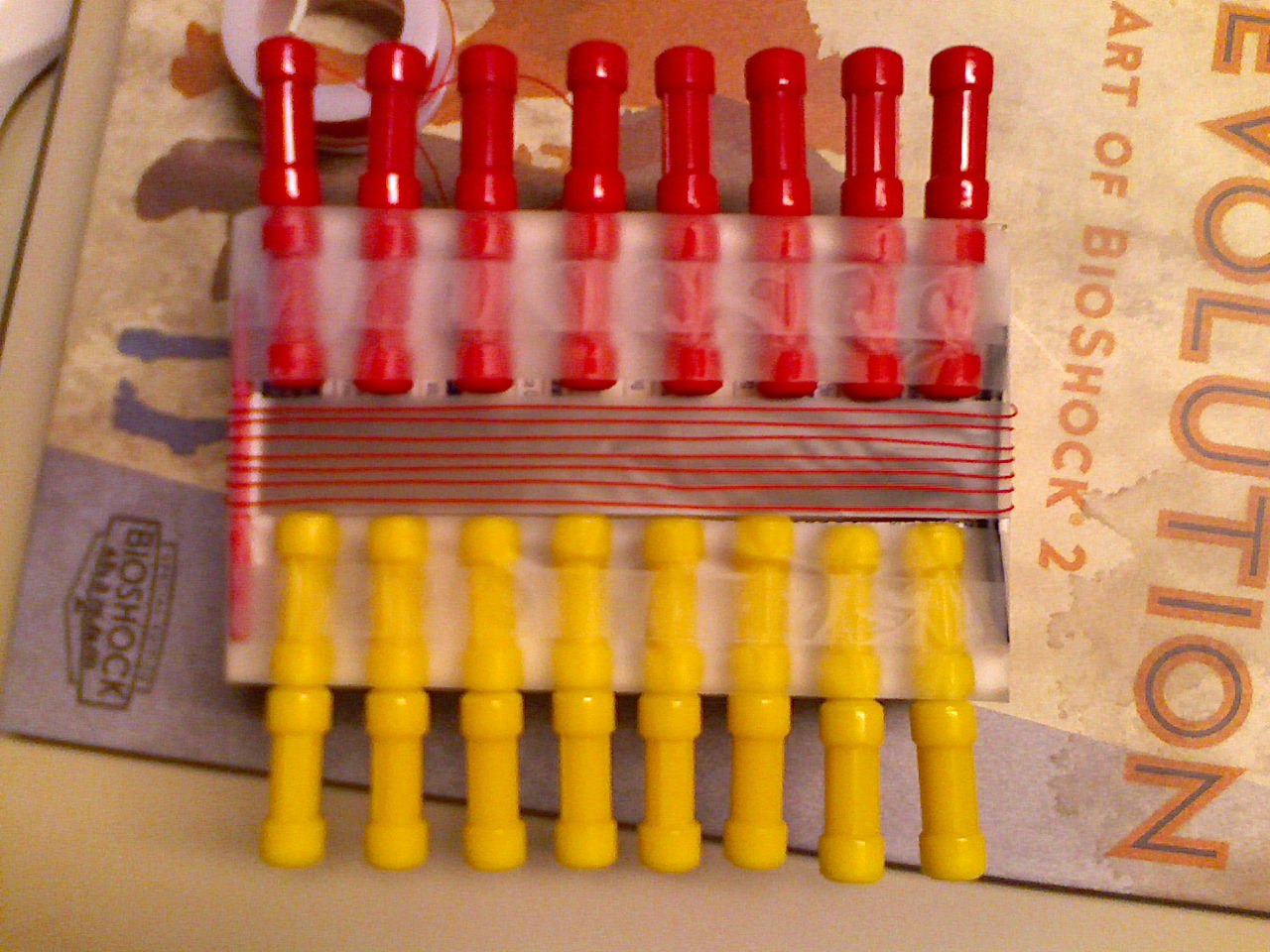

I got so excited about building a ribbon speaker after reading all the wonderful articles that I just couldn't wait. So I built one using stuff I found around my office.
The "frame" is a drink mix box.
The magnets are from a Magnetix building set
the ribbon is scotch tape
the coil is a very thin wire I had for a different project.
Very very inefficient, but it actually sounds half way decent. Very surprising range.

Now with the way your magnetic field is, the coils will get pushed outward and inward. That would in time tear the scotch tape ...
That is one reason the pleated diaphragm and magnets facing it works.

Well I'm only giving this one like 15 watts, and if you turn it up it buzzes like crazy. It doesn't get very loud, but loud enough for an open office area.

Try some medical "skin tape" instead
Having an office, maybe you will find it in a first aid box
If what I see is a roll of wire to get high impedance, it may significantly roll off highs, or if worse, most of its output
Maybe try and make it half as wide
It would no doubt play louder

Yeah the roll of wire is for impedance, didn't feel like blowing up my amp and didn't have any resistors available.
By making it thinner wouldn't I loose some lower frequency?
How about using aluminum foil as the ribbon?
Would more winds make it more efficient? Or just increase the mass of the ribbon and make it worse?

If you can learn to wind a trafo, it will be perfect to use simple alu foil, corrugated
No, at this size you wont loose much by making it less wide
With very strong magnets I wouldnt go further that about 15mm gap
Beyond that theres a huge loss of energy
With your small office magnets, not more than 6mm wide ribbon

Ok, I tried using some foam board, made the ribbon half the width and twice the length.
I tried the ribbon both out of aluminum foil and out of wire and tape.
It sounds cleaner, but at about half the volume of the originals. I wonder if it is because the originals had a box and that was creating a resonance chamber?
..... but at about half the volume of the originals. I wonder if it is because the originals had a box and that was creating a resonance chamber?

Maybe because you use the green and blue magnets 😛
Nah, use more magnets, fill out the gaps 😉
And make 100% sure of correct magnet polarity
Also, you may not have control over the tension of ribbon
Could change the sound a lot
But take care that the wire outside the magnet gap doesnt "play" or ressonate
I have experienced that
Ok, doubled the magnets and used foil. That fixed the volume. Can't turn it up too much or it sounds really bad.

But you need a capacitor in series
I dont know if can actually roll one yourself 😀
