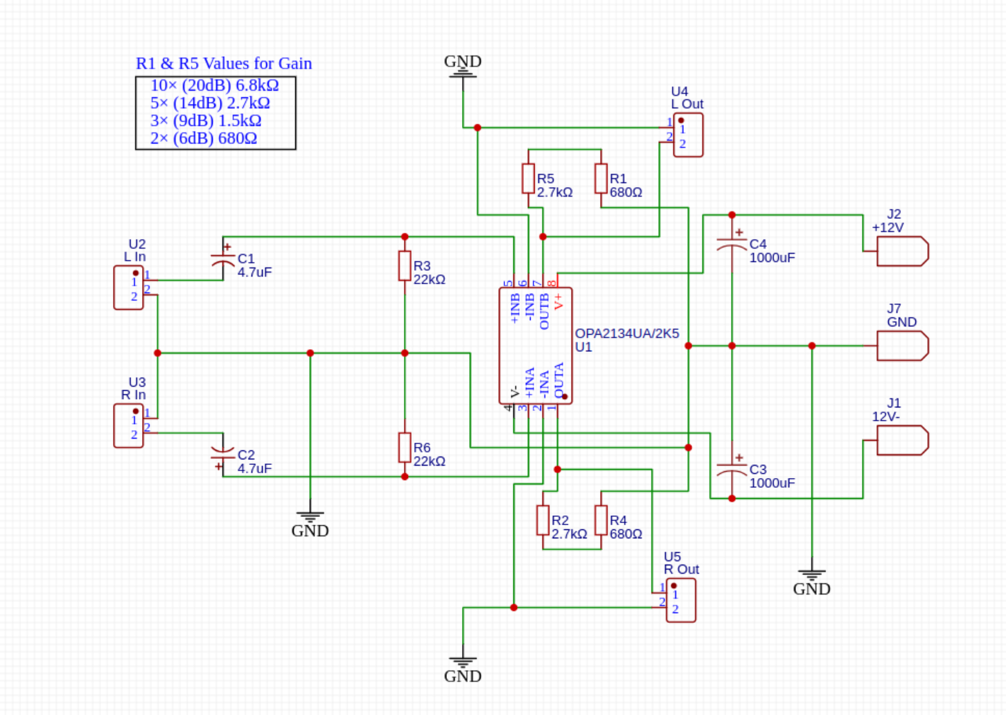

My first preamp
What do you think of this as a preamp for a pair of QUAD 405-2 clone
Maybe i use it for the JLH-69 i plan to build as well.
It's actually a really nice headphone amp, but i changed R1 & r5 to lower the gain.
Will it work or should i start all over again ?
I think you need to start all over again. Something is mis-connected. You have no feedback loop to the negative input- and it's grounded. I think you meant to connect the negative input to the node between R1 and R5, not to ground. There is a great site of audio projects using op-amps - Elliott Sound Products (ESP). You might find some inspiration there.

Please first check what input sensitivity your power amplifier has. Does it need 1V for full output? Are your sources younger than 20 years with 2V rms output level? Think what will happen if your design has a gain of 20x. Then think if you need gain at all. Also think of impedances. What load does the preamp tolerate and do the sources tolerate the preamp? Are the sources perfectly capable of driving the power amplifier? Are they maybe even more capable when connected directly than the preamp design?
Determine if you need a preamp at all. Maybe you can invest in a relay controlled volume controller with relay controlled source selector buit in the amplifier. Saves a lot of possible side effects and a few interlinks too. Maybe what you may need is a buffer after that source selection/volume control. A preamp with a gain of 1.

I dont actually think i really need a preamp, but it would be fun to build.
But as you said, i maybe should put some effort in other thing, like volumecontroll and source-selector.
Thanks for pointing me in the right direction and focus on whats actually needed.
I think i keep the headphone-amp as is, and just use it as a headphone-amp.
