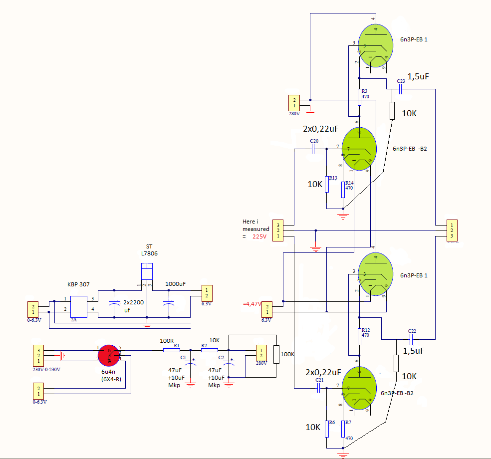

As I said, the SRPP has too much gain. The unbalanced SRPP (with better PSRR) has even more gain. You can't improve the wrong circuit; you have to change the circuit.

Is the heater voltage referenced to B+/4?
Max,
You should not get hum (from the heater at least) in your circuit. Heaters have been operated with 6,3V a.c. before with inputs of 2 mV, but correct balancing/centre-tapping and routing of leads are necessary.
What Cjpkg was referring to above is the matter of heater-cathode voltage. If the heater supply is earthed, the top tube cathode sits at about +80 - +100V with regard to the heater. While this is in order spec-wise, it allows for the cathode to get leakage electrons from the heater (inside the cathode tube, operating like a diode). If the heater supply is ac, such leakage will definitely cause hum.
It is therefore better and also common practice to operate the heater at a d.c. voltage higher than that of any cathode, so as to cut-off any diode-operation. In your circuit that would mean at least some 120V positive, as the top cathode sits at some 100V above earth. This is dangerous as the maximum neg. heater-cathode rating (100V) is then exceeded in the bottom triode.
The best you can do is to try connecting the heater supply to a resistor tapping of about +80V above earth (bypassed to earth). This is especially necessary when operating heaters from 6V.a.c. as explained above. Occasionally one gets a particularly 'leaking' tube between heater and cathode, which must then be discarded or used elsewhere.

Now i learned something. Very useful info for me. I was just thinking about the grounding cuz when i'm connecting "via the board" the heater automatic gets earthed together with the rest (caps and so on) but now with ac i don't have any ground at all. Just direct from transformer to heaters.
If i would like to bypass to earth, what would your suggesting be in terms of resistance? what is normal? 10ohm or 10K? I really don't know how to calculate that.
If i would like to have DC i clearly need to buy a new transformer that delivers maybe 8-9V so i can get proper regulation and voltage out from this L7806.
Here is little updated schematic how it looks today:
Regarding the sound i feel that low end is not so strong. To big /small decoupling cap? Can i go up to 3,3 or 4,7?
Some datasheets recommend no more than 20k resistance between cathode and heater, with exceptions for cathode followers and LTPs.

just run 2 300 ohm resistors from your heater AC terminals at the transformer and then tie the centers either to ground or to a voltage divider from your B+ with something like a 300K on top and a 100K on the bottom to ground.
Ok thanks a bunch. I will try that first one with two 330ohms. Nearest value i have and see and hear. Later i try also the second you wrote.

There really is no need to do a CT on the rectifier heater wiring. I suppose you could try it and you would then tie it to ground or even a standby switch. This could allow the heaters of the preamp tubes to heat up first before you switch on the rectifier.
I did that first one with 2x330 ohm and hum went down but still there mostly in midrange and the woofers. If i touch the woofers before this mod, it was an exercusion of maybe +/- 1mm and now maybe 0,1mm.

those voltage divider values are fine.

Voltage divider did good. Now hum is down to ok levels. Thx.

Credits to cjkpkg for helping me with this hum problem. And drew a nice schematic that made it super easy =)
