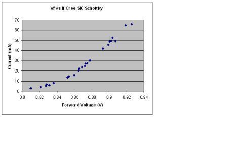

If the color/brightness of the LEDs bothers you, you can also use other types of diodes for bias. I use Cree SiC Schottky diodes to bias the input tube in my Midlife Crisis amp and in another preamp I've made; each diode has a forward voltage (Vf) of 0.8 - 0.9V, so two in series should give ~1.7V. I find the sound to be very clean and clear.
I plotted the Vf vs current a while ago, attached is the plot. Dynamic resistance is very low, lower than most LEDs, actually.
