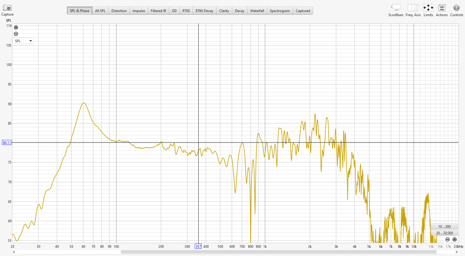

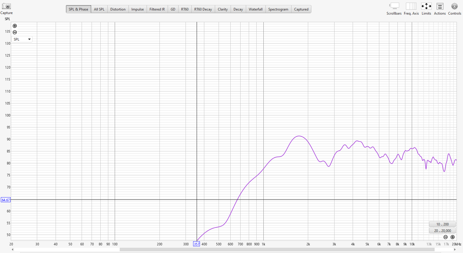

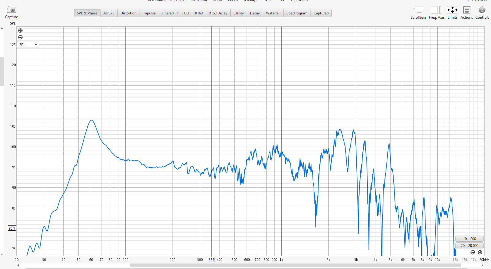

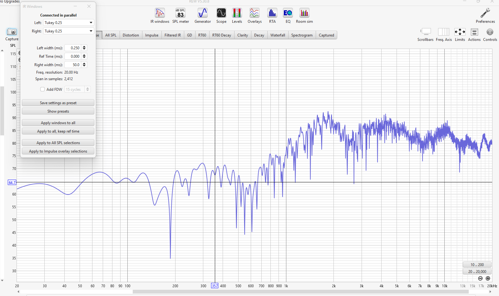

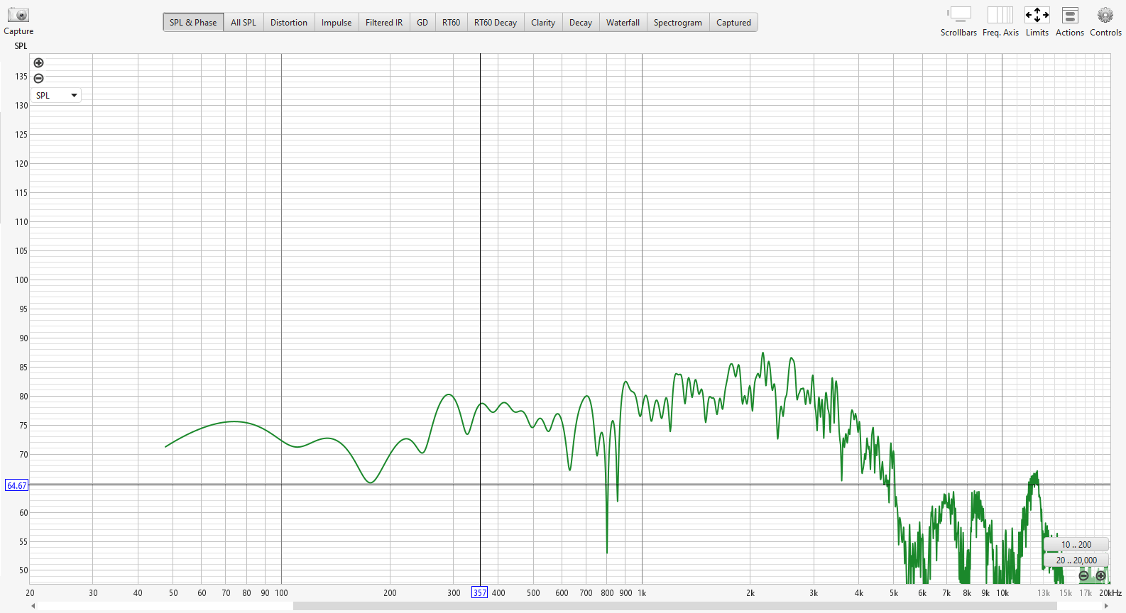

The measurements are as follows: Nearfield then farfield sub. Combination of the two. Farfield tweeter. Drivers in parallel.
Taking the measurements in this fassion seemed to work well, I used the same gate for the farfield measurments of both the sub and the tweeter and used the suggested frequency of 400hz to merge the two subwoofer measurements together. My issues mainly were with the parallel measurement. Should I also be merging this with the subwoofer measurement as when I went to shorten the gate of the parallel one i started to loose more and more of the sub, so to keep the lows in I'm left with quite a distorted looking graph which will be hard (and not ideal) to try and replicate in the speaker design. Is there something that I've done incorrectly on this measurement?

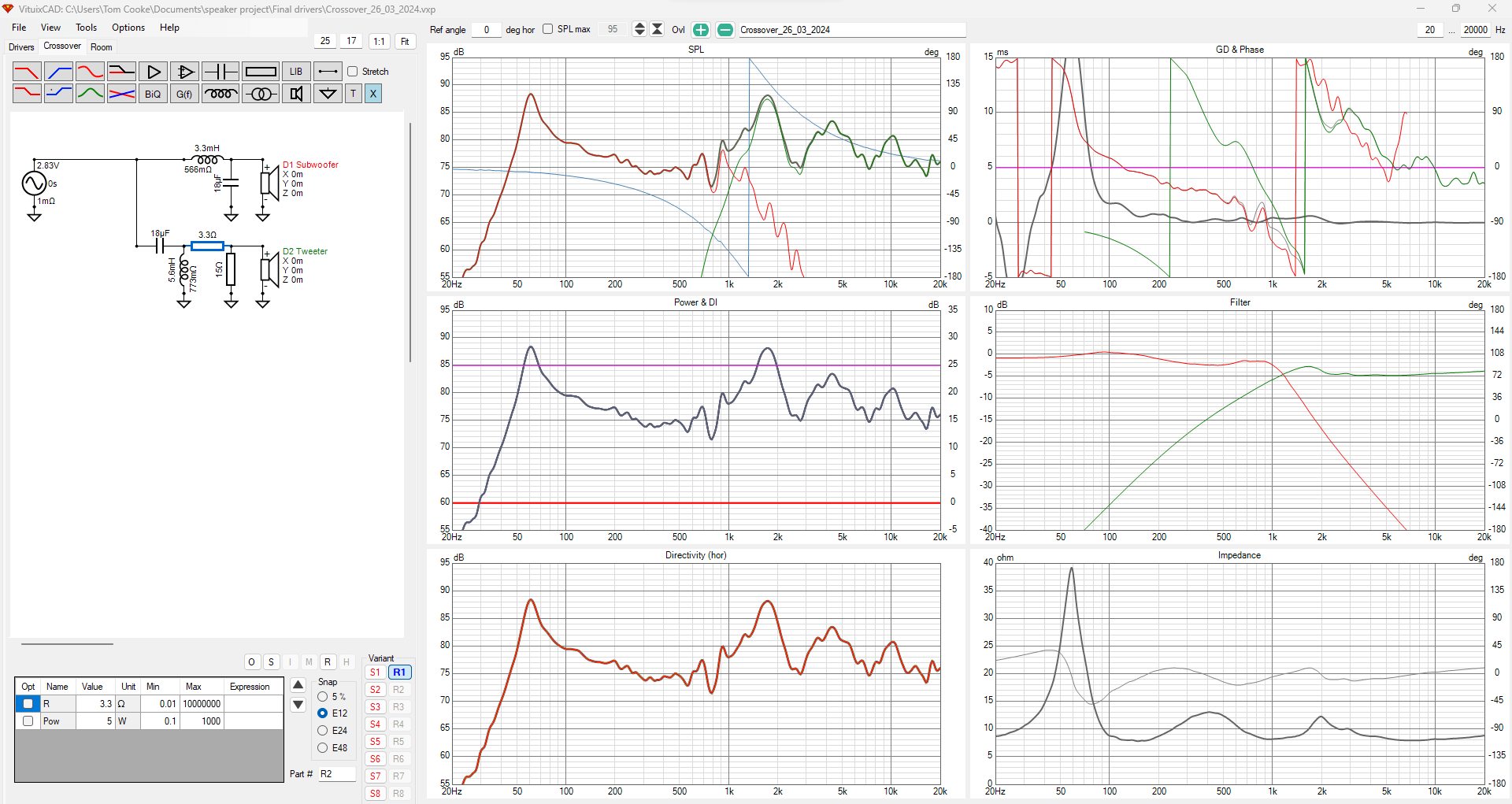

I've designed this crossover based of the parallel speaker measurement shown previously. Are there any major flaws in the design with the component values selected? I'm also not sure on the impedance response as there are a few peaks over 10ohm and my amp is only rated to 8ohm, will this overload the amp or will I be fine as the peaks aren't too large?
