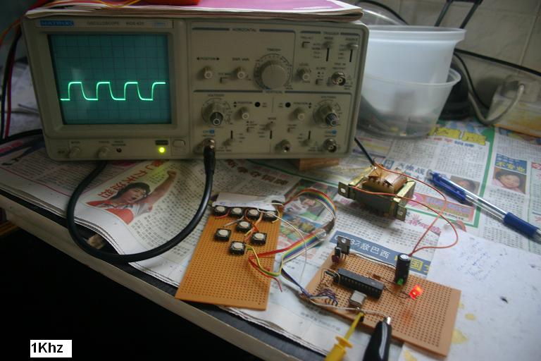

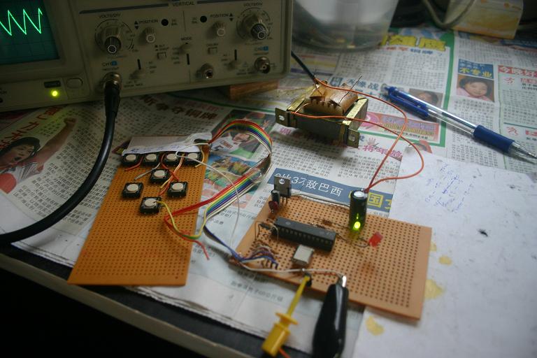

finally i bought probe for scope. now i test the amp and found two signals are not same when i attached to the amp, in and out. here i show the image of input and output 1khz.
absolutly amp problem. i don't know what could be problem in amp? there are two side showing like ripple.

1001 things it could be. The actual layout and the way it's all wired up may be the problem. I know you use veroboard and point to point wiring 🙂 .
Layout is so very important, and making sure that the feedback nodes are correctly connected is vital.

yes, i have to learn more about signal analize. now i can see more btr. the amp is working but the signal sould be showing same as input.
how to check distortion?

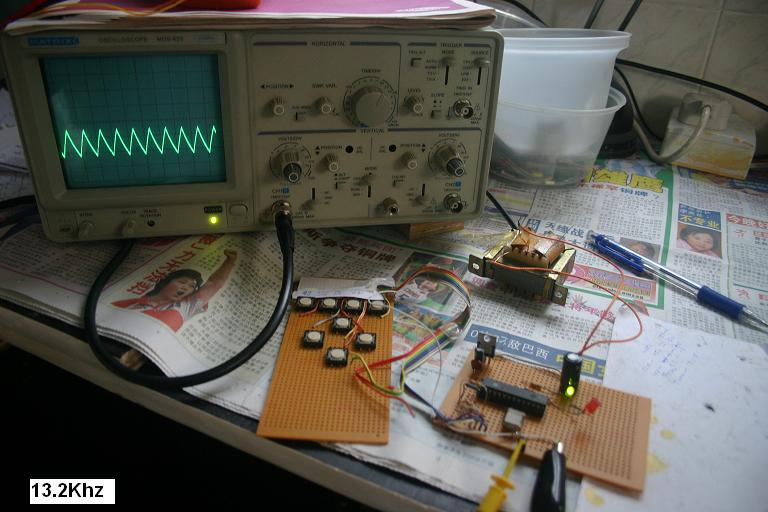

What are you using for a signal generator now, is it still your PIC signal generator ? Can you test at a higher frequency.

there you go michael
Well done ....you are starting to get somewhere ..... now the next step will be to have a nice dummy load ....and start loading your amps and have real test conditions .
Then again you will start to realize how critical lay out is and no matter that your designs are really futuristic ( i actually like them very much ) but the thing is that in such lay out will be very easy to start to "pick up" problems here and there .

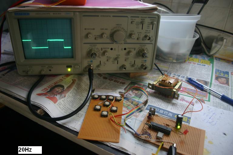

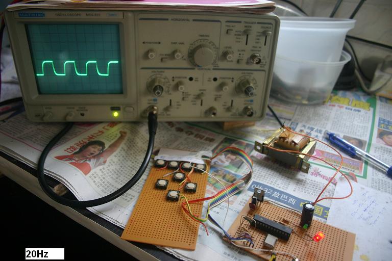

thanks for your comments.
i don't mind at all. i am learing from you guys. here are lots to learn. now i used 1khz to the amp using pot to control volume. the volume cable is not for audio so there is a ripple at the corner cause by the cable. now you can see 75% volume was used to check. i used real 8ohms speaker for output (short time). here is the pic.
That looks very much better Michael.
Now does the output of your amp alter when you connect the load. It should remain essentially the same but could also increase or decrease in amplitude. What does it do ?
Try and get hold of some high power resistors, they are quite cheap, even 25 and 50 watt ones for testing. An 8 ohm speaker is just a nominal value. The actual impedance will vary from perhaps as little as 3 ohms to as much as 30 or more depending on the frequency.
