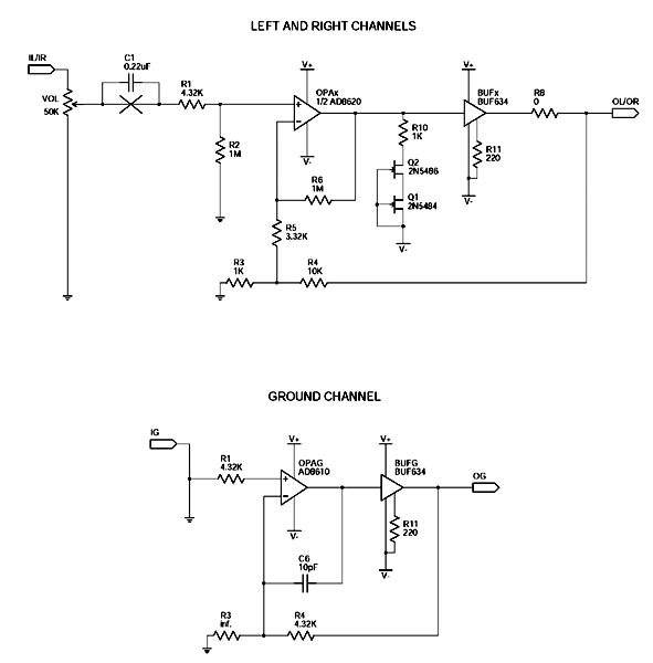

Hi Folks
This time my question is about yet another area of uncertainty.:xeye:
As previously mentioned, my intention is to create a nice little
integrated dac/amp combo for my portable listening.
For convenience and mass considerations I am keen to run the lot
from a single 8 cell Nimh battery pack.
The thing that has my head in a spin is connecting the dac to the amp!
Not really sure about the grounding issues..or what ,who, how
the voltage levels, errr confused...:cannotbe: :xeye::bawling:
I am basically unsure about the pot ground [being at half supply v] in relation the dac ground, the part the dacs 47K resistor [output cap to ground ] plays, as it does seem to be a path to ground for the virtual ground via the pot..
The amp circuit in question is the popular Pimeta headphone
amp.
Attached is the Pimeta schematic .
Sorry if this basic stuff, I realize you are all hardened campaigners;) :D
Can anyone enlighten me ?
Cheers
Setmenu:angel:

Ok.
So I have not exactly phrased a question concisely here..
Do I simply connect the dac L+Routs to the pot L+R inputs ?
And leave the pot Ground[virtual OV in respect to amp] floating
in respect to the DAC?
I am sure I am missing something blindingly obvious here:rolleyes: :cannotbe:
Cheers
Setmenu
